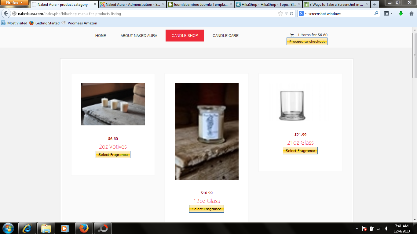

  • Posts: 7
12 years 8 months ago #135127
Here's a snippet of the screen
It can also be seen on the website at http://nakedaura.com/index.php/hikashop-menu-for-products-listing
12 years 8 months ago #135191
I just checked your website, and the problem is coming from the fact that your have uploaded a 100x100 picture for your product, and that your re-sized it using some CSS code, the solution will just be to upload a bigger picture.

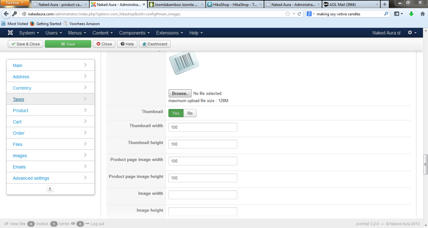

  • Posts: 7
12 years 8 months ago #135244
I have not touched the image settings, here is what that are at. Should they be changed or anything else that might be affecting this? Thanks
  • Posts: 86081
  • Thank you received: 14189
12 years 8 months ago #135263
If you look at the image that is uploaded, for example nakedaura.com/media/com_hikashop/upload/...e_tin_1247252544.jpg , you can see that its size is small. So there are only two possible explanations, either you uploaded yourself that small image, or it was resized automatically during the upload because these two options were set. There is no other way as all the thumbnails which are created are stored in sub folders starting with "thumbnail" in their name.
