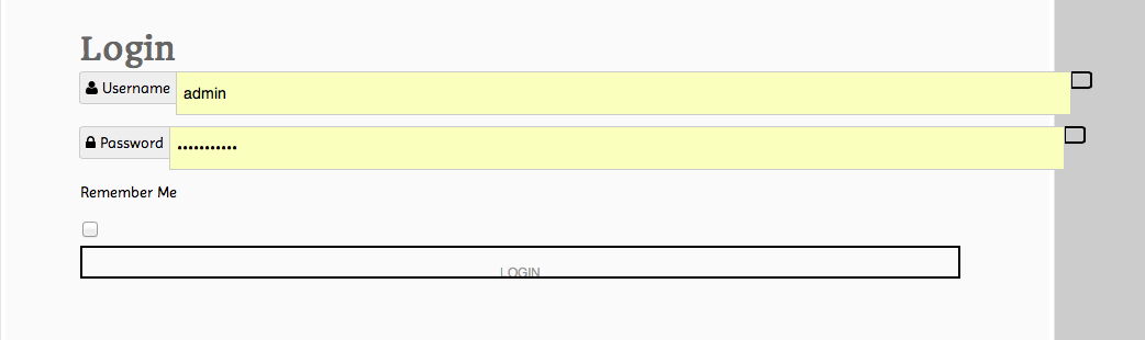

the log in boxes seem to be very long. how can i adjust them so they don't go right across the whole page? and can i adjust the colour??

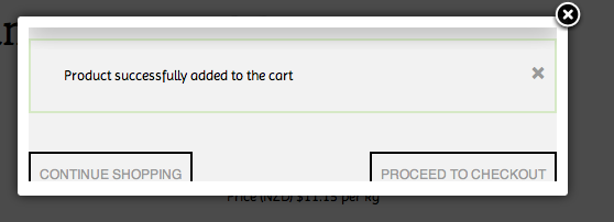

from the attached screen shot, how can i adjust the size of the pop up box so you see the whole thing, rather than having to scroll down?

1. You'll be able to adjust your login box input width by using some CSS code like :
.hikashop_checkout_login_right_part input {
width: 20% !important;
height: 35px !important;
2. You'll probably find your solution through this thread :
You can edit the file administrator/components/com_hikashop/helper/cart.php and change the line:
echo '<div style="display:none;"><a rel="{handler: \'iframe\',size: {x: 480, y: 140}}" id="hikashop_notice_box_trigger_link" href="'.hikashop_completeLink('checkout&task=notice'.$url_itemid,true).'"></a></div>';

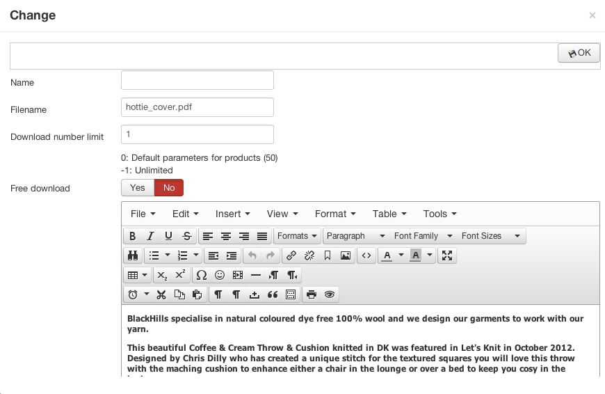

1) i only have one payment method and one shipping method loaded (that i know of) at this stage. the problem with the checkout only seems to be with one product that i have set as a free pdf download. all the others that have a payment value will carry on through to checkout. why would that be? i have several knitting patterns that are free, and would like to know if i have done something wrong in the set up for them.
2) also, i still can't make the log in boxes shorter. where exactly do i need to insert the css that you gave me a few posts ago>

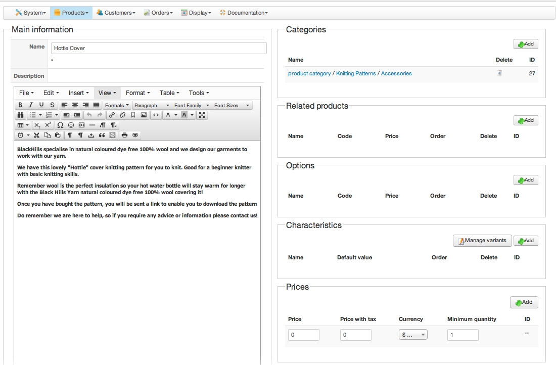

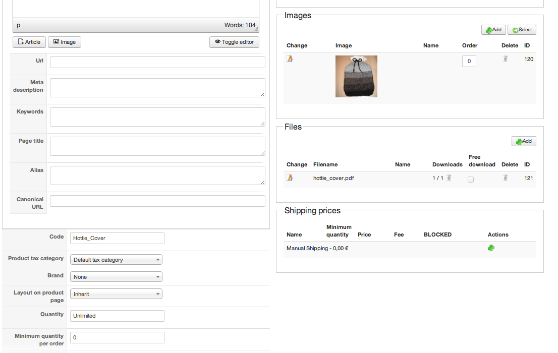

1. We would need to know how you configured that product. Could you provide a screenshot of the options of the product ?

sure can, screenshots attached. i have just set the price to $0.00, that may not be the correct way to do it?

12 years 7 months ago #138653
i thought i had better add this one as well, there may be something in here i need to add / change?

Sorry for the delay! Your product seems to be well configured, do you still encounter this problem? If so, could you give us a link to the error page?
I can see you fixed the field size, it's already a good point!
