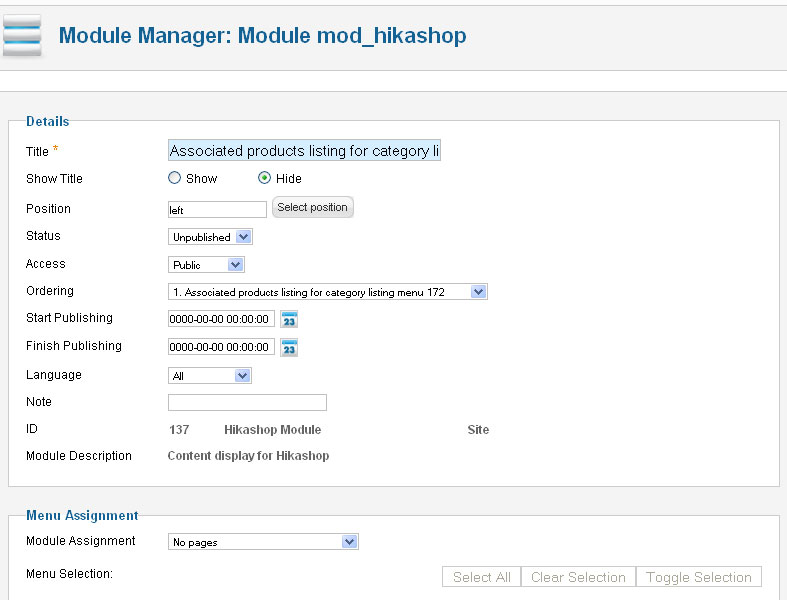

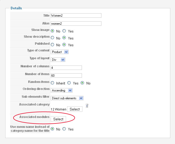

I've attached 3 images in the order of what happens.
The 1st one is when I click on "Associated Modules"

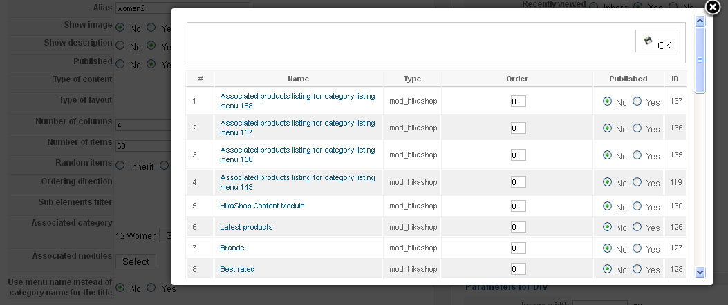

The 2nd is the popup
The 3rd is the screen it takes me to
  • Posts: 86081
  • Thank you received: 14189
12 years 8 months ago #135983
That's because you click on the link of the module and thus you go to the options page of the module... Instead, you should turned on the "publish" radio on the right and click on the "ok" button to validate the selection.

As Nicolas said, you'll just have to set the radio of your associated module to YES and save it by using the OK button through the popup page of the associated modules option.

It's the one with has the "yes" radio selected in the popup of course.

When editing the HikaShop menu (from HikaShop > Display > Content menu), you have the "associated module" listing, like this:

Sorry but I don't think you guys are understanding what I am trying to say or maybe it's just me :(
When I FIRST click on "select" next to "associated module" ALL of the modules are UNPUBLISHED so how do I know which one to choose?
12 years 8 months ago #136147
In the popup it is:
