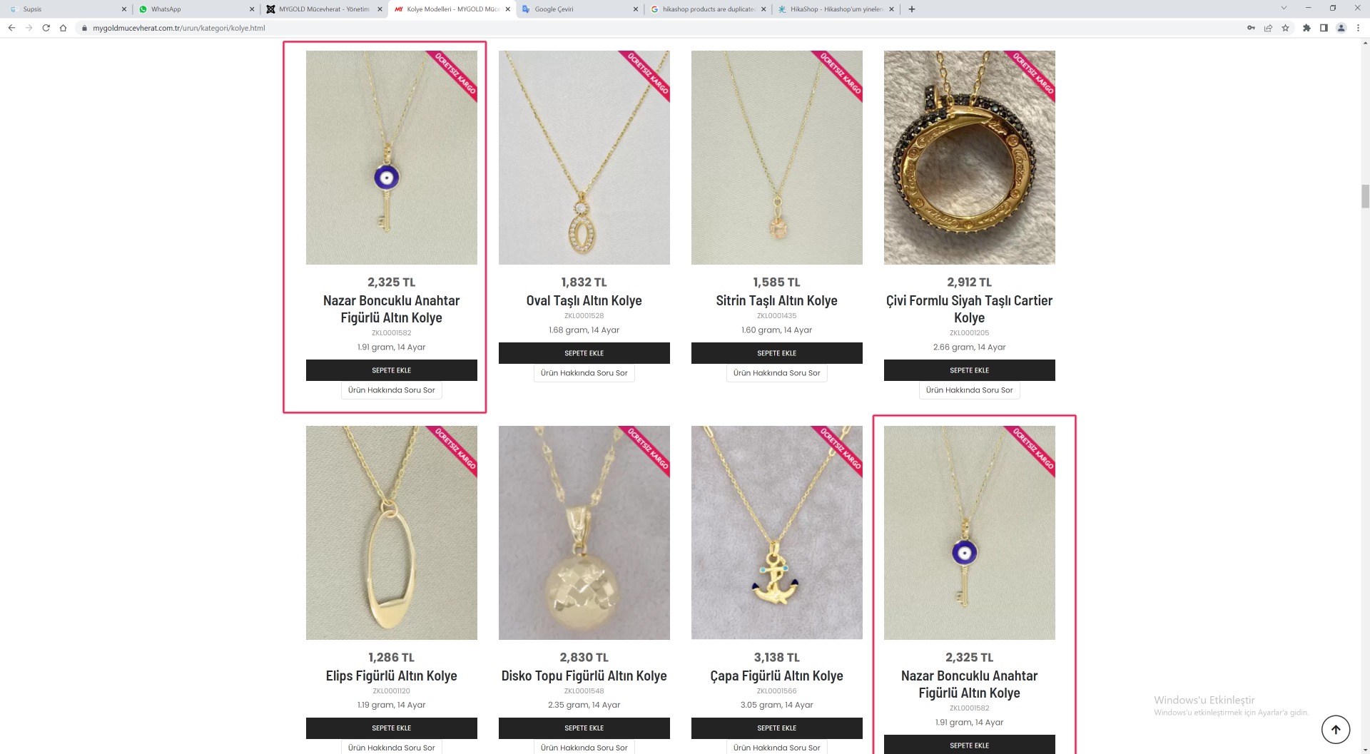

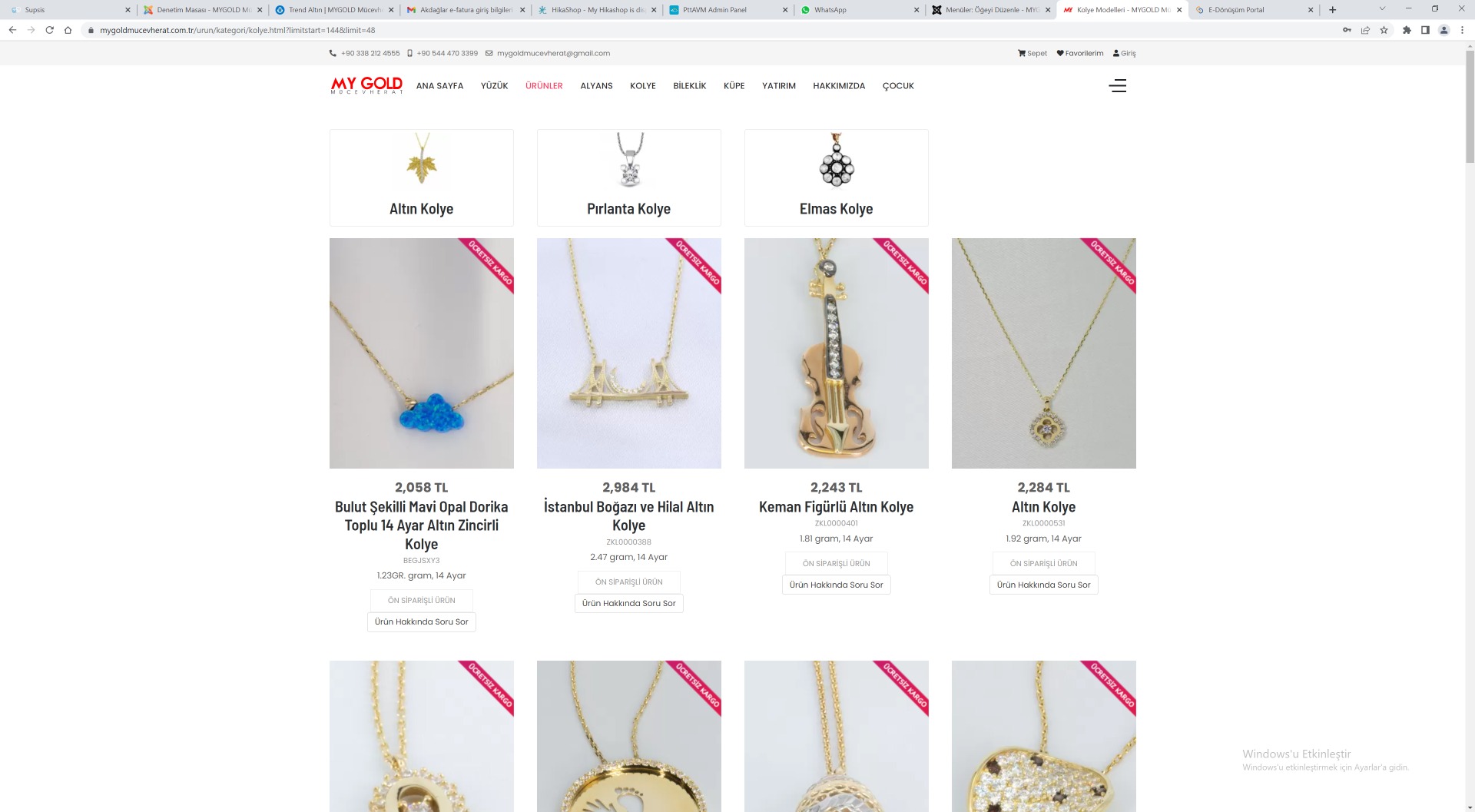

Hello, I have the same problem.
Some products are shown double in the product list.
Sometimes it is randomly displayed.
mygoldmucevherat.com.tr/urun/kategori/kolye.html

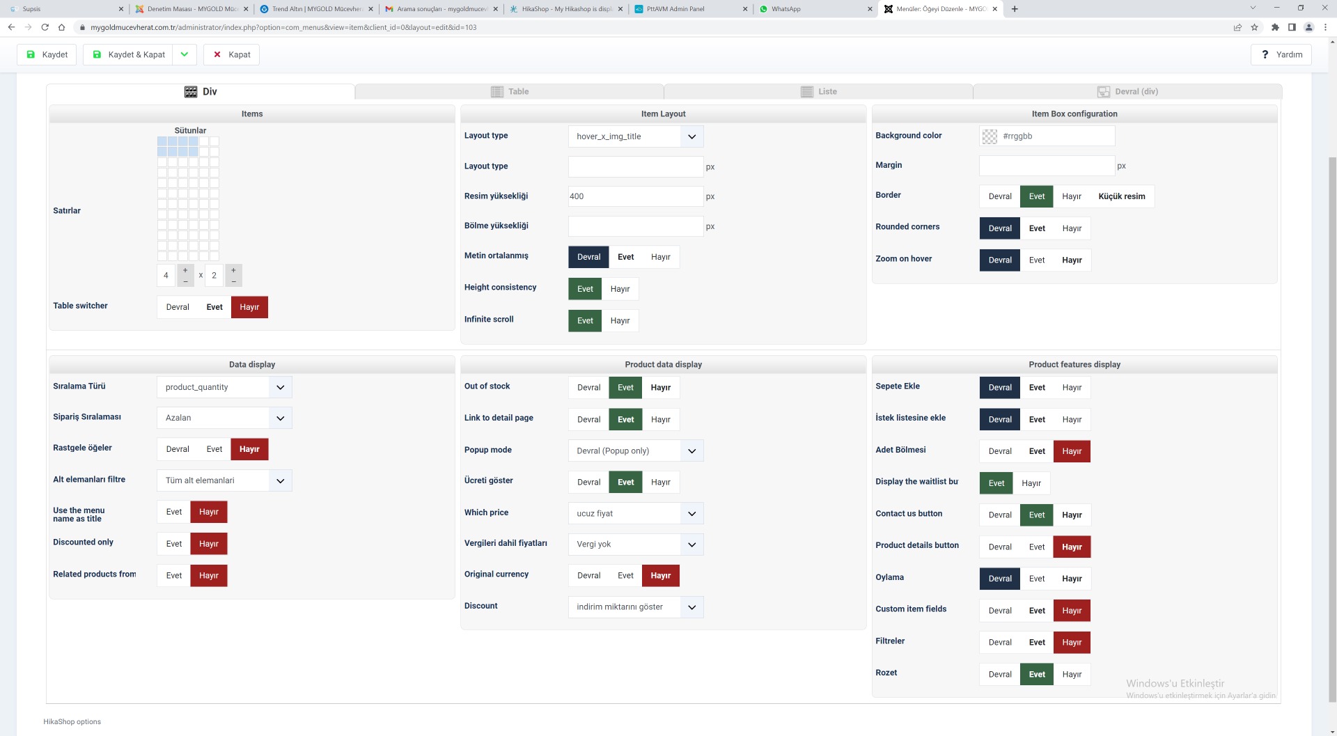

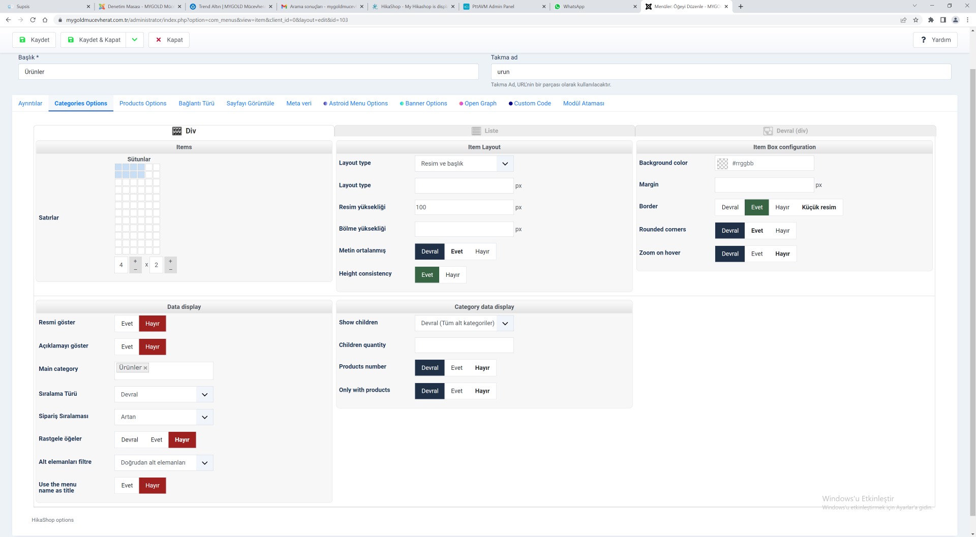

Could you first provide a screenshot of the settings under the "products options" tab of your menu item ?
Also, if you turn off the "infinite scroll" setting there, do you have the same issue with products appearing several times, on different pages of the pagination ?

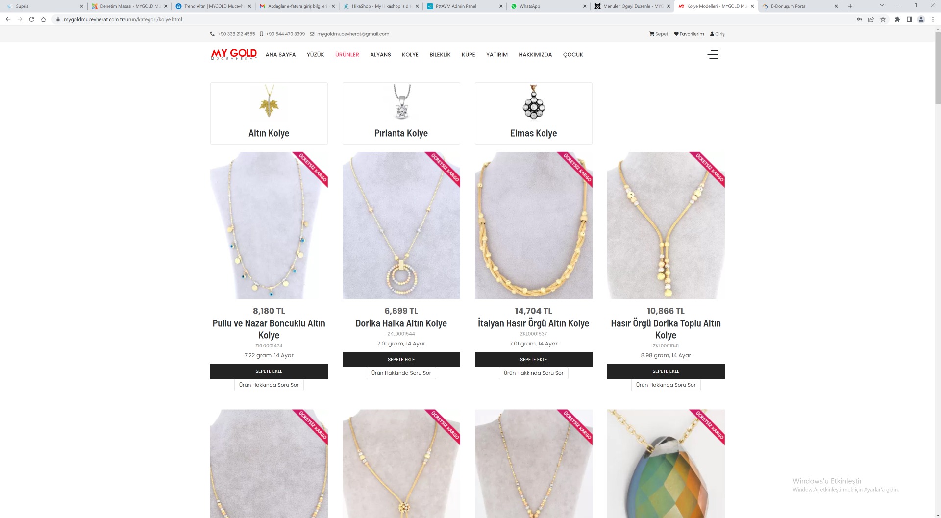

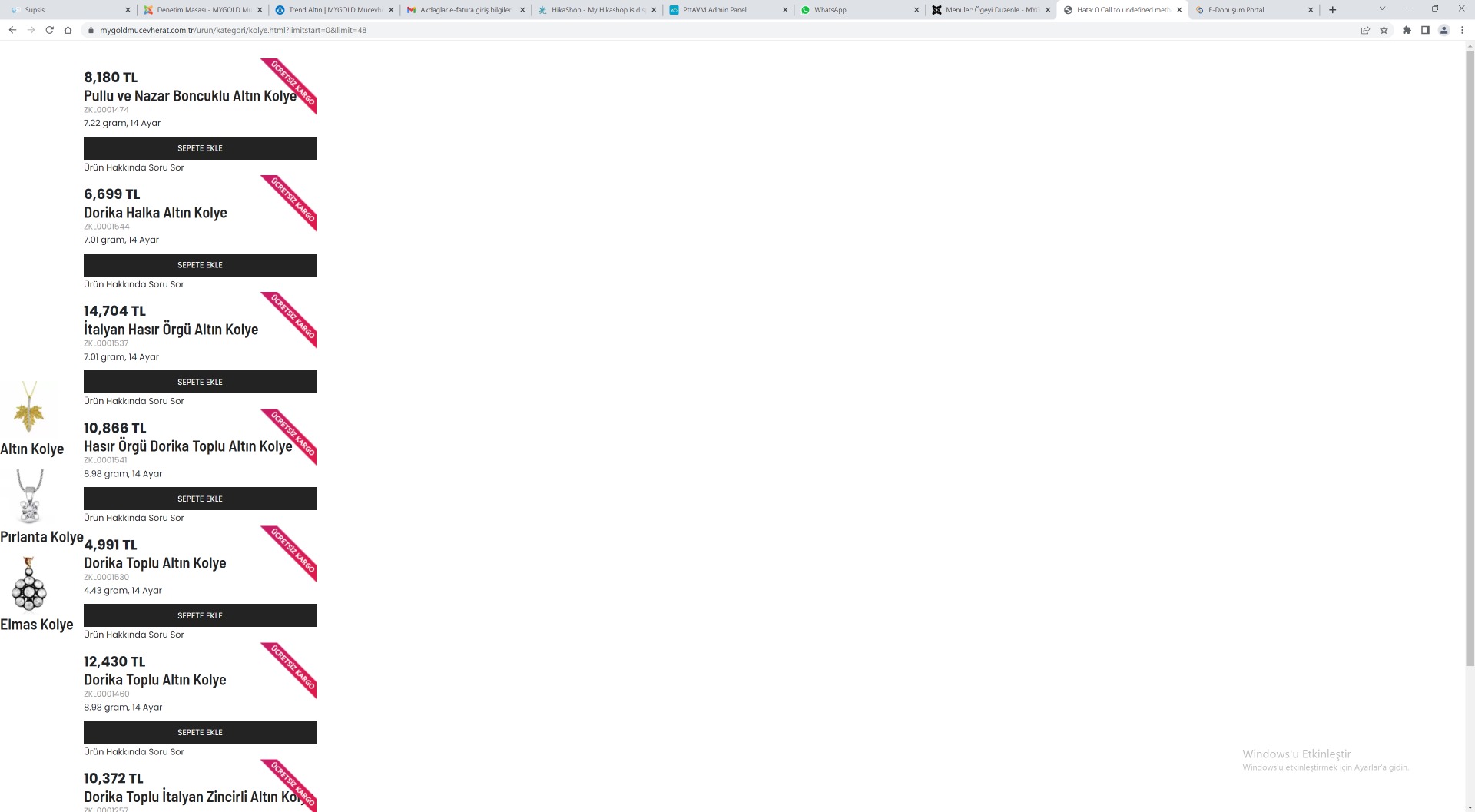

Turn of the Infinite Scroll: not showing duplicate products. But another problem occurred.another problem occurred

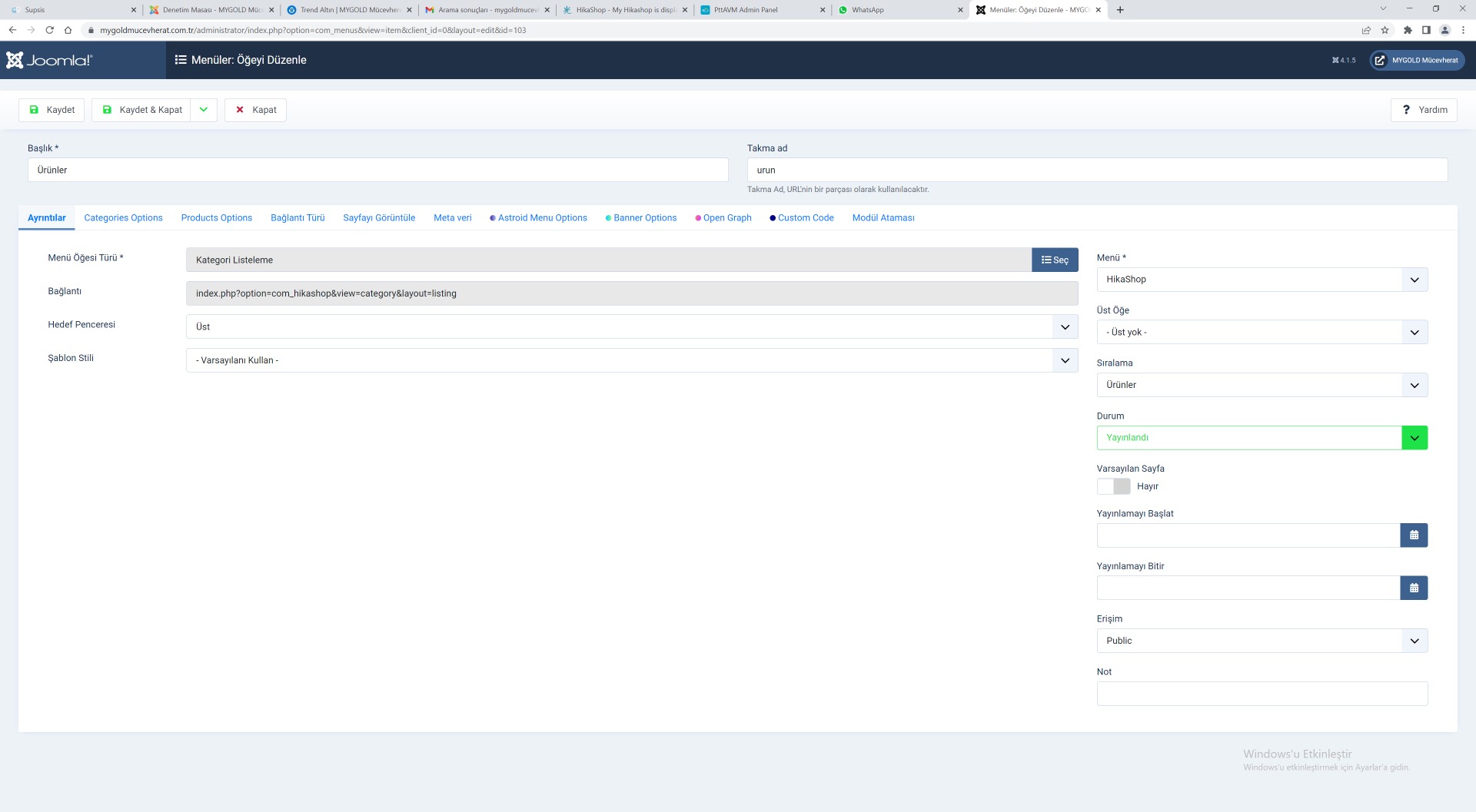

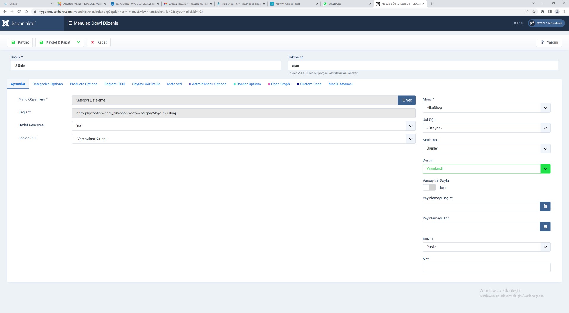

When I first opened the Products page, it was displayed properly. I opened the pages one by one, they were all fine. After that, when you return to the first page; The image appeared as in the attached kolye-limitstart0.jpg. This image is sometimes fixed by pressing ctrl+f5. This corruption may not be from hikashop, but from my htaccess settings, I don't know. My cache settings are off. Menu screenshoot: attached menu3.jpg

3 years 10 months ago #343895
We are still unable to reproduce on Chrome your issue shown in your image "kolye-limitstart0.jpg"...

I checked with chrome and opera browser. Both are problematic.
I connected the Necklace Menu to hikashop->productlisting, it was still problematic.
I've set the necklace menu to be displayed in the cassiopeia theme, it's still problematic.
Since I know the products, I can notice the repetitive ones.
Not the same product each time, but a random other product/products repeating. Sometimes it repeats 2 or 3 times.

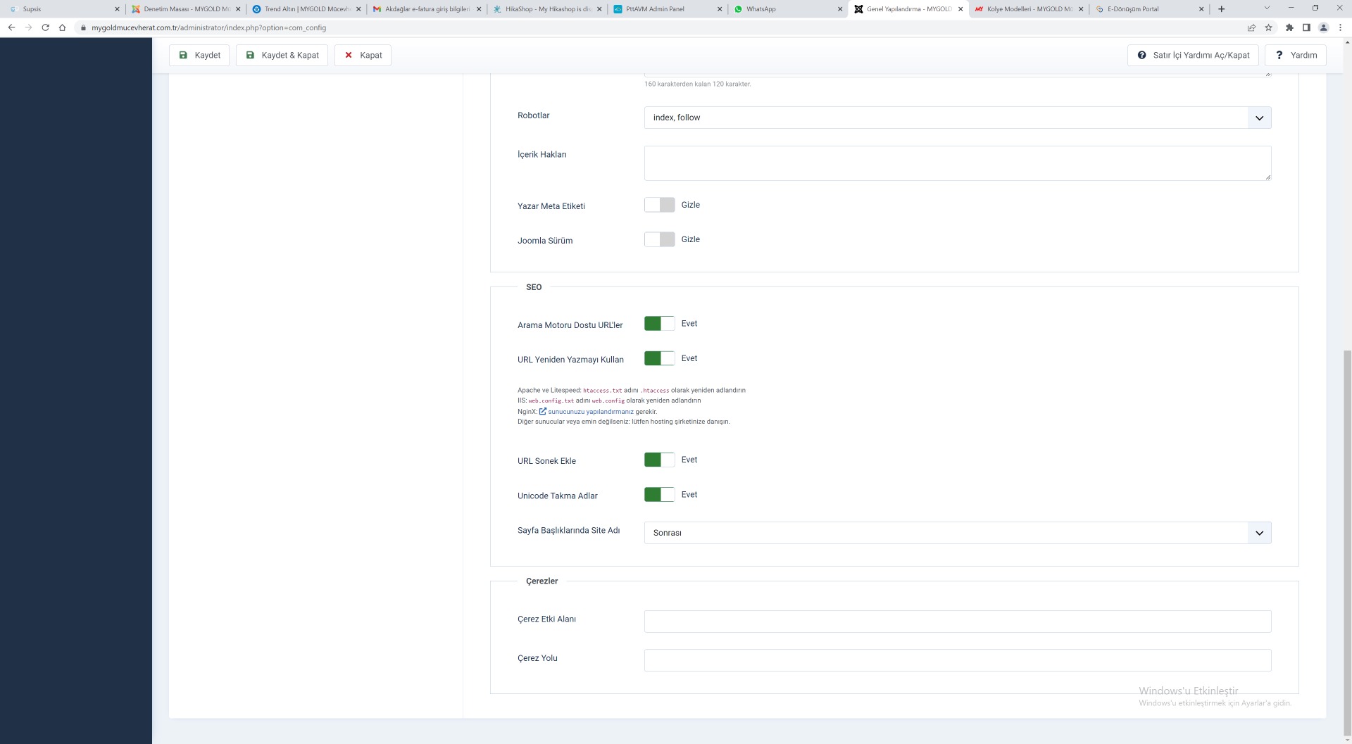

Could it be wrong with my settings like seo / canonical url / menu?

I did some debug and check your settings, and I think I understand what's going on.
Your problem is with the "ordering field" you selected and the fact that many products have the same stock.
You've asked HikaShop to order the products on your listing based on the "product_quantity" column.
So the MySQL query properly has a "ORDER BY product_quantity DESC" to order the products from the most quantity to the least quantity.
The problem is that this product_quantity field has the same value for many products. And in that case, there is no fixed rule given to MySQL on how to order the products with the same product_quantity value. This means that the order can be somewhat random between the products with the same stock.
Ironnically, this isn't a problem if the "random" setting is activated because the random system is handled by HikaShop and stores in the user session the ids of the products already loaded on the different pages displayed by the user so that the other pages of the pagination won't use these products, until you go back to the first page, which reset that user session ids cache.
I can see your products either have the quantity 0 or 1.
I suppose you did this ordering scheme so that products already bought would go at the end of the list and the customers would only see the products with stock while browsing the first pages of a products listing.
Instead, I would recommend turning off the "Out of stock" setting so that out of stock products do not appear and then changing the "Ordering field" setting to "ordering" or to a field which you know is unique for each product.
