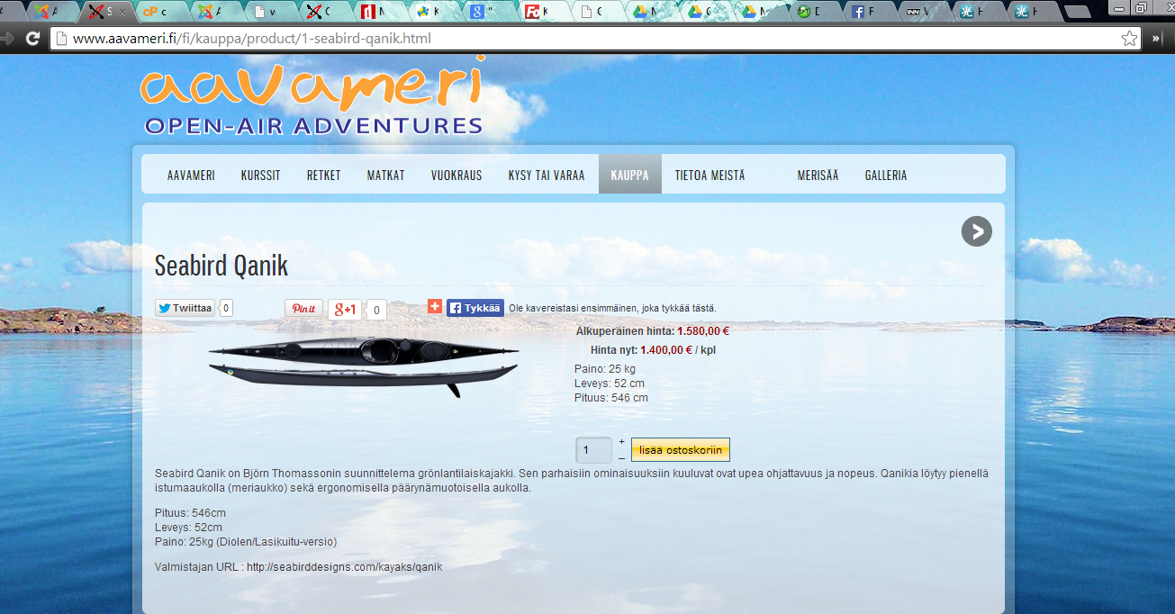

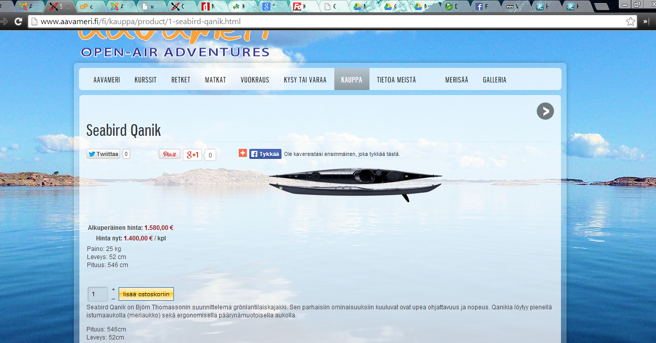

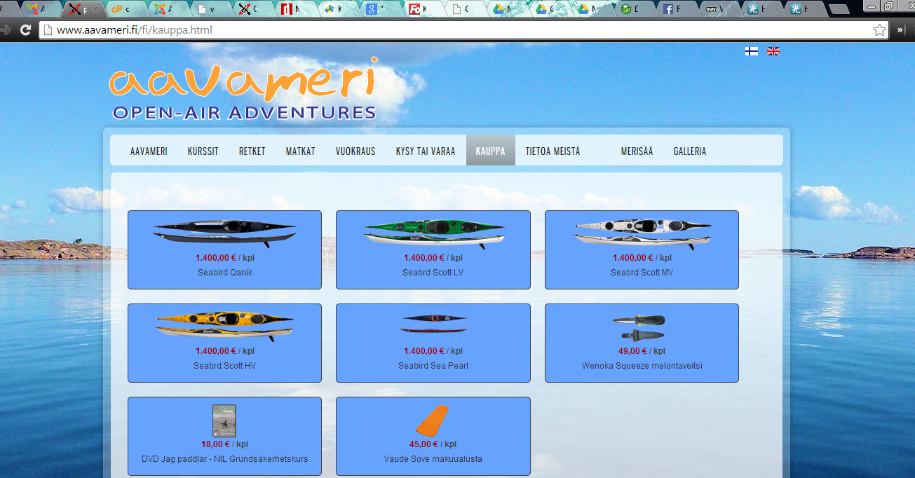

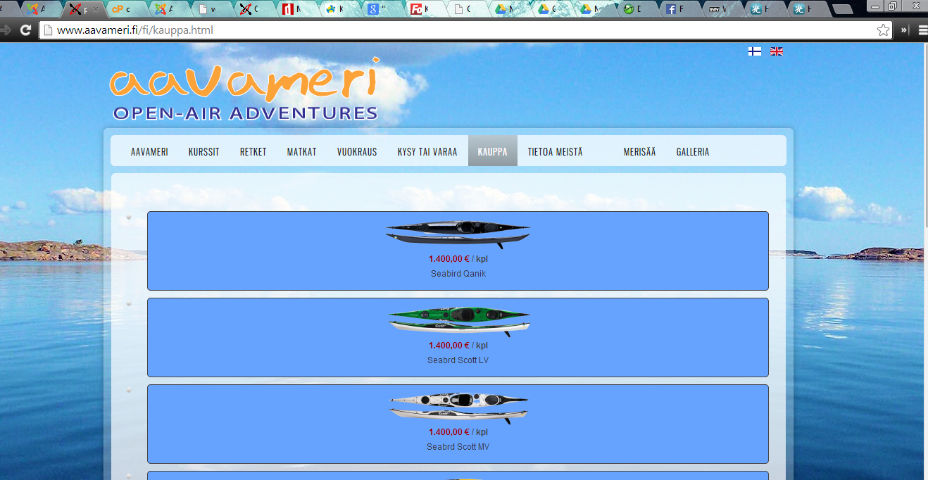

A. If I have the Configuration -> System -> Display -> Use Bootstrap design set to Yes, I get a category listing view that is NOT OK and a Product page that is OK (attached hb4a45ff.png = category page not ok and h54eec38.png = product page OK)
B. If I have bootstrap design set to No, I get a category listing view that is OK and a Product page that is not OK (attached heeec879.png = category listing OK and hbbc03d3.png = product page NOT OK .
C. I would be happy to get the OK versions of both these views :), that is products on the category page in columns on the same row, and the product text to the right of the product image on the product page. I have played around with the css but this does not help. Any ideas what is wrong?

I can see the listing and the product page both fine on your website at the moment. I don't know if you already found a solution but I don't see any issue with the way it is setup at the moment.
I see www.hikashop.com/media/kunena/attachments/30385/h54eec38.png and www.hikashop.com/media/kunena/attachments/30385/heeec879.png

11 years 8 months ago #137943
Either you activate the "use bootstrap design" option of HikaShop and thus the bootstrap options of the template have to be activated, or you turn it off and the views of HikaShop should display fine regardless of whether bootstrap is turned on or off in your template. In that second case, the fact that the right area of the product page goes under the right area on your website is just a problem of width which can easily be fixed with a line of CSS. We would need to see the issue on your website to be able to tell you exactly what line to add.

Category listing view OK: www.aavameri.fi/fi/kauppa.html
Product page breaks so that text goes below image: www.aavameri.fi/fi/kauppa/product/2-seabrd-scott-lv.html

11 years 8 months ago #137994
You can add such CSS:
.hikashop_product_top_part {
height: 100px;
in the frontend CSS file of Hikashop under the Display tab of the configuration.
