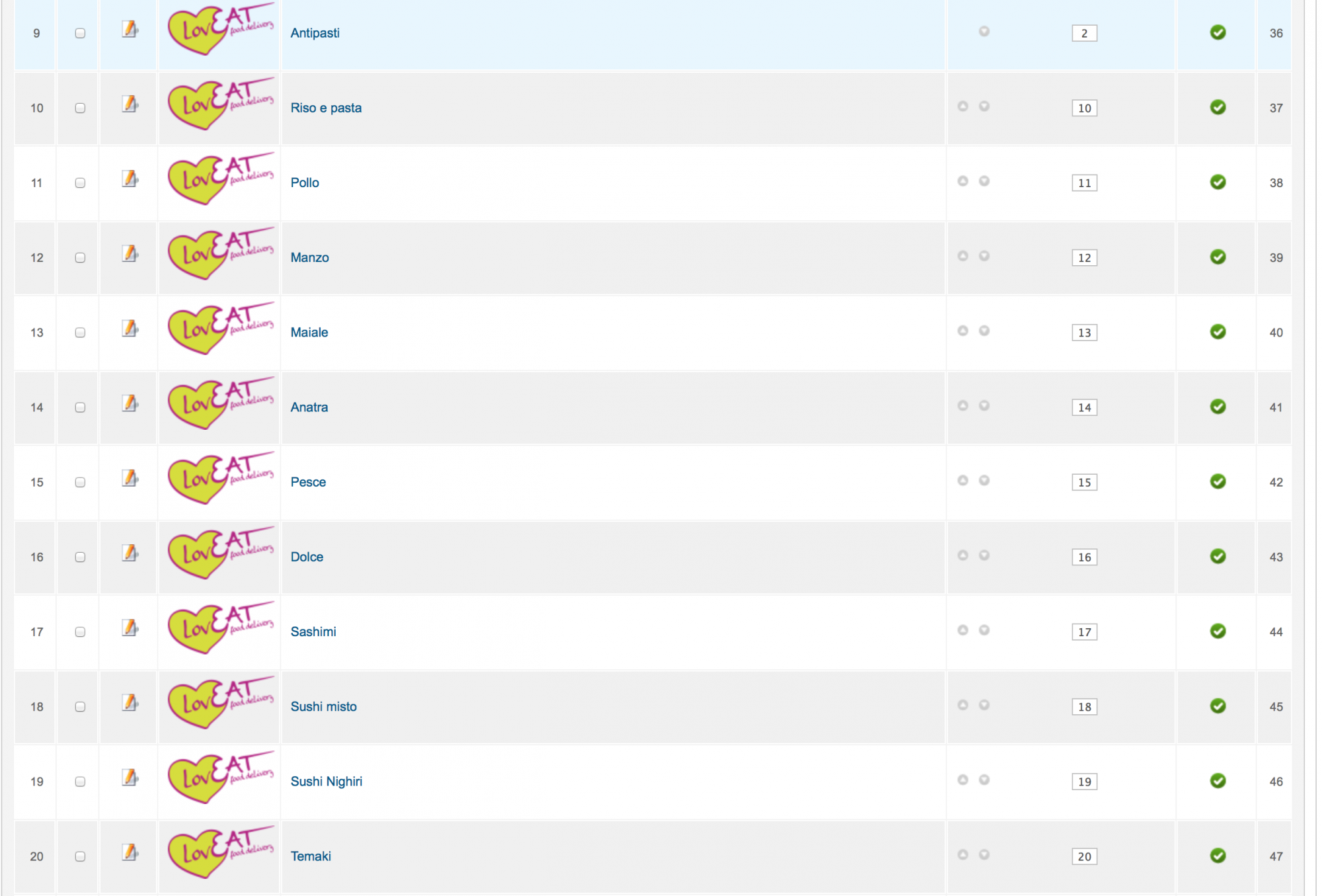

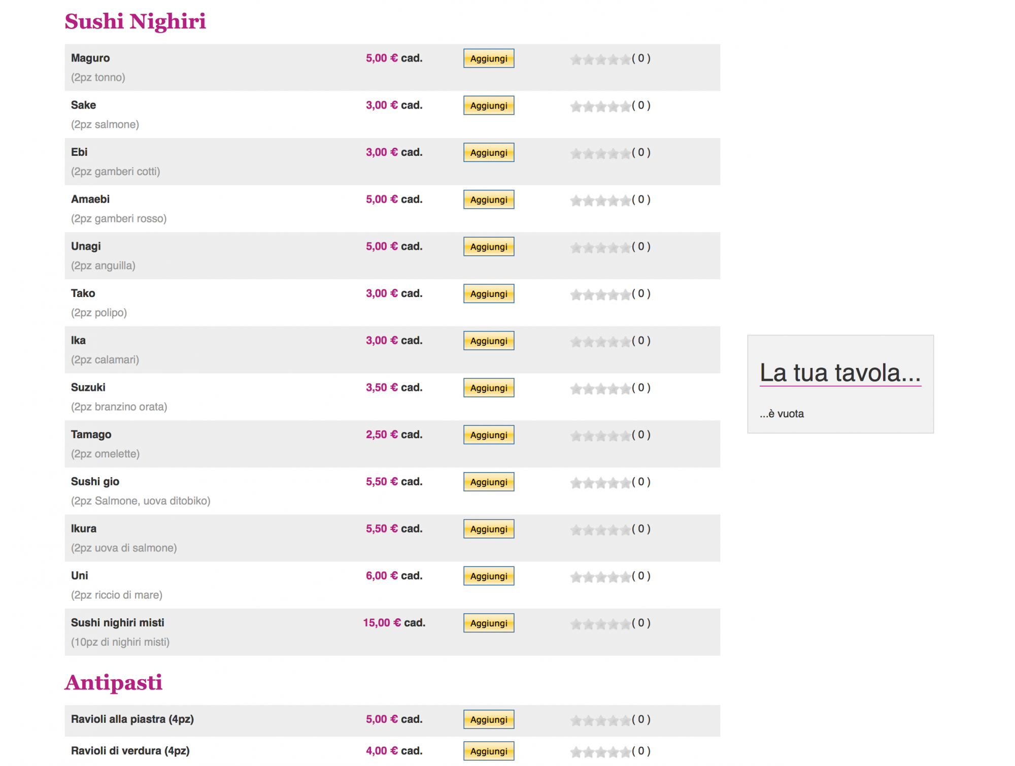

Hi, i have a problem with the order of categories, the order ID is not respected
In attach you may see back office configuration and front end display of categories (in particular Sushi Nighiri and Antipasti).

Thanks to your latest screenshot, we figure it out with Nicolas the problem that we weren't able to reproduce.
The sorting a working well but only if you have few categories, when the ordering have "low" numbers (under 2 digits).
The problem come from the function _sortCategories of the file "components/com_hikashop/views/products/view.html.php"
You have to replace
$id = sprintf('0.5%d-0.5%d', $i['category']->category_ordering, $i['category']->category_id);
By:
$id = sprintf('%05d-%05d', $i['category']->category_ordering, $i['category']->category_id);
And also
$id = sprintf('0.5%d-0.5%d-0.5%d', $i['category']->category_depth, $i['category']->category_ordering, $i['category']->category_id);
By
$id = sprintf('%05d-%05d-%05d', $i['category']->category_depth, $i['category']->category_ordering, $i['category']->category_id);
And it will fix the problem.
