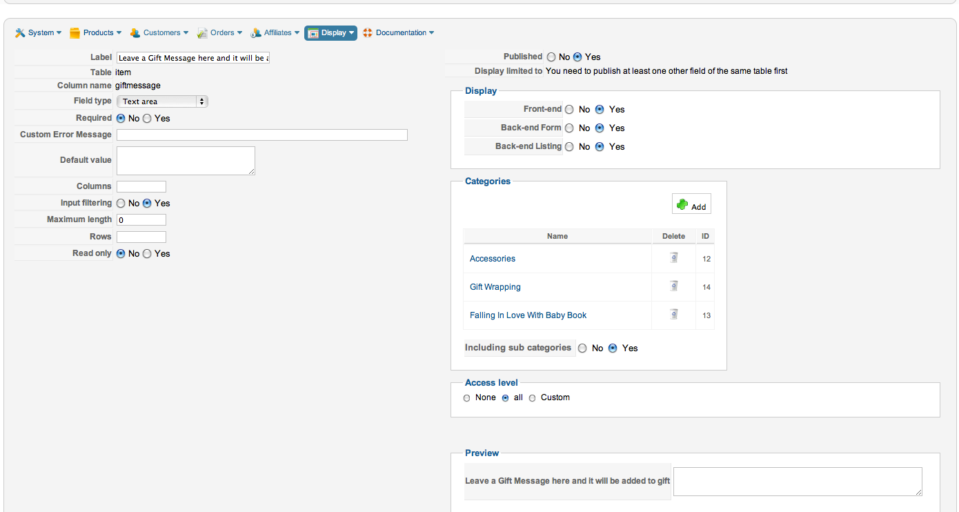

12 years 7 months ago #139593
Can you show me a screenshot of how did you configured your custom field ?
  • Posts: 15
12 years 7 months ago #139607
Sorry..i should have attached with post
here it is
thank you
12 years 7 months ago #139630
Thanks to check if the option "Display custom item fields" is enable in Configuration > Display > Default parameters for products.
Are you sure that the product is in one of the categories set in the custom field settings ?

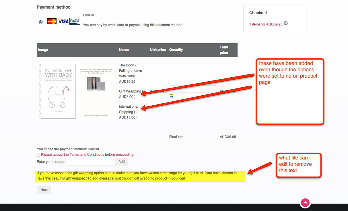

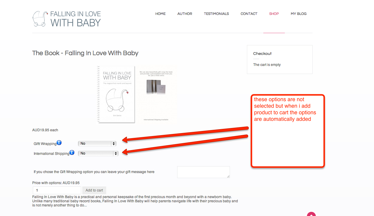

  • Posts: 15
12 years 7 months ago #139734
Hi Xavier
I think i am taking two steps forward then one step backwards
I have created custom field as you said above and that seems to be working :) however now when you go to shop and select the product without the options and proceed to checkout it is automatically adding options to product even though they are not checked. I also cannot delete product from cart
Also one other issue, i created some custom text a while ago on checkout page but for the life of me i cannot remember where to edit it.. i don't seem to have a custom field for there. Any ideas? ( see pic)
  • Posts: 86080
  • Thank you received: 14188
12 years 7 months ago #139811
Please make sure that you add a characteristic to your options as explained in the documentation:
www.hikashop.com/support/support/documen...ct-form.html#options
That should avoid the issue.

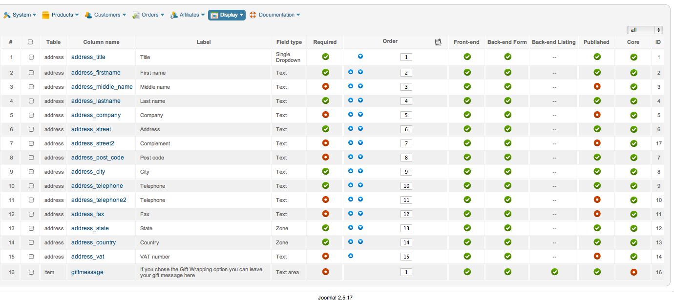

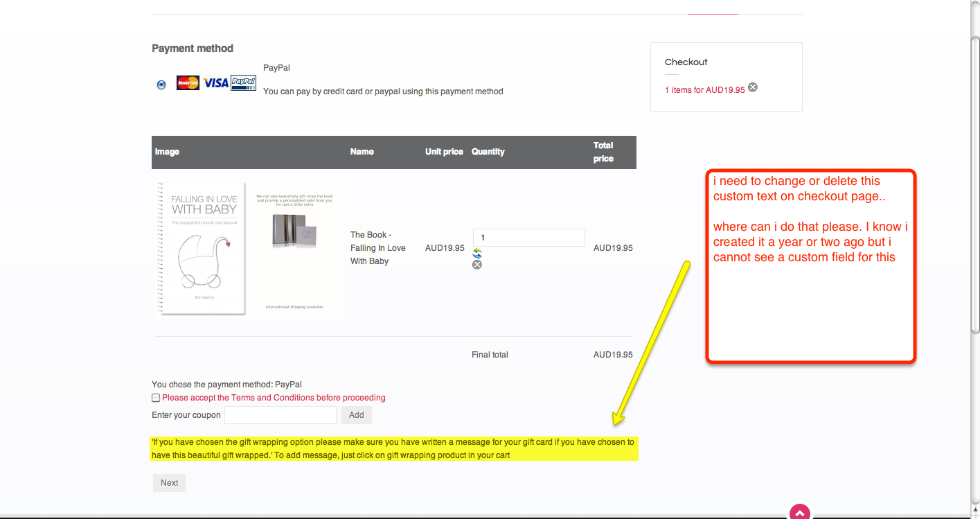

  • Posts: 15
12 years 7 months ago #139908
Thanks Nicolas
I have solved first issue however i cannot find where to edit or delete custom text on checkout page
I sort of remember editing a file over a year ago but not sure which one.. i have checked my display custom fields but nothing
i have attached images for your advice
thanks
12 years 7 months ago #139923
If you want to change or delete this custom field, you'll just have to go to your "giftmessage" custom field configuration page and un-publish it or edit it.
  • Posts: 15
12 years 7 months ago #139925
Hi Mohamed
thanks for quick response but the custom field i set up and visible on pic i sent you is for the input box and does not contain the text that appears on the check out page
please advise alternate fix please
des
12 years 7 months ago #139936
How did you add this text ?
  • Posts: 15
12 years 7 months ago #139938
I can't remember Mohamed... i think i may have edited a file
Hope u can help me
cheers
des
12 years 7 months ago #139942
Note that using some CSS code like this will probably do the job :
#hikashop_checkout_page p {
display: none;
  • Posts: 15
12 years 7 months ago #139944
In which file please Mohamed
I am not a coder but can insert code if you give me the path please
des
  • Posts: 86080
12 years 7 months ago #140211
That code should be added to the frontend CSS file of HikaShop as explained here:
www.hikashop.com/support/153-customize-the-display.html
