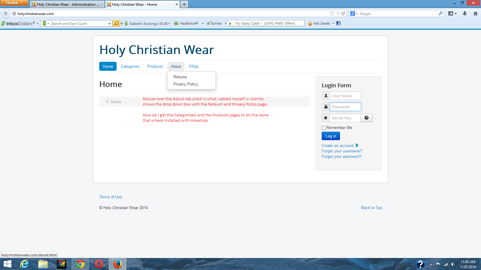

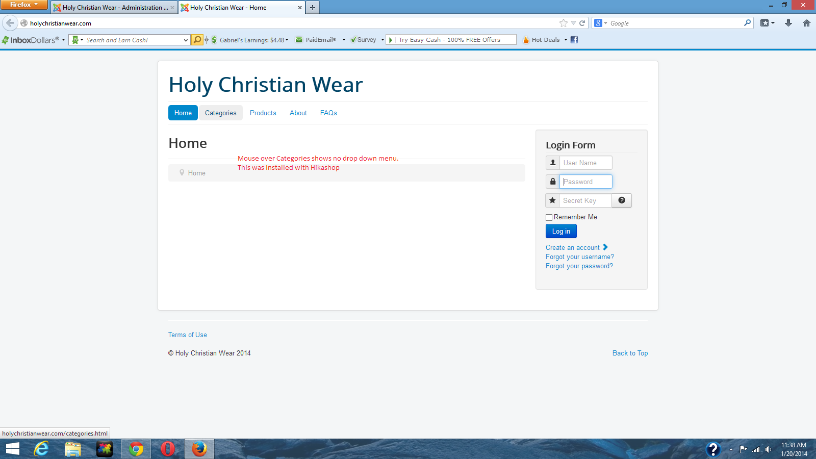

I am using Joomla Protostar template. I need to to have the Hokashop Categories and the Hikashop Products drop down on the main menu when the mouse is moved over it. If you look at my site listed above you will see that I have done it with the about tab. The about tab on the main menu when the mouse is over it will show the return and the privacy policy pages.
Since Hikashop categories and product tabs was added to the main men when I installed it I am not sure how I get it to work like the About tab on my site.

12 years 7 months ago #140410
From the screen shops above I hope that you can understand what I am trying to do not sure if I did this right and thanks for your help

You can do that in two ways.
The first one is to create one menu item per category via the joomla menu manager and for each one, set its parent menu item to the menu item of its parent category, and in the "hikashop options" screen of the menu item, select its corresponding category in the "parent category" option.
The other way is to use the integration with maximenu CK which can generate such display dynamically from the categories/products of Hikashop: www.joomlack.com/extension-joomla-maxime...ch-maximenu-hikashop
