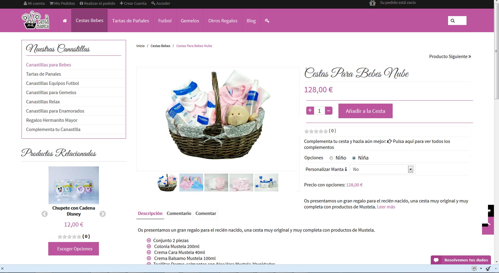

I would like to change the add to cart button position in my show_tabular view

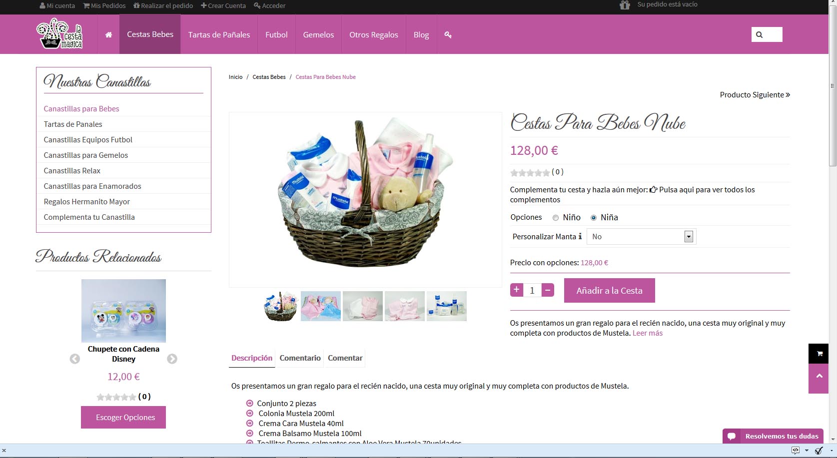

12 years 7 months ago #140323
Firstly can you show me how do you want to move your add to cart button through some screenshots ? so that I can give you some advice about how you should edit your "show_tabular" file.
  • Posts: 441
  • Thank you received: 24
12 years 7 months ago #140327
sure, here they are, first one as it is, second one as i would like it
