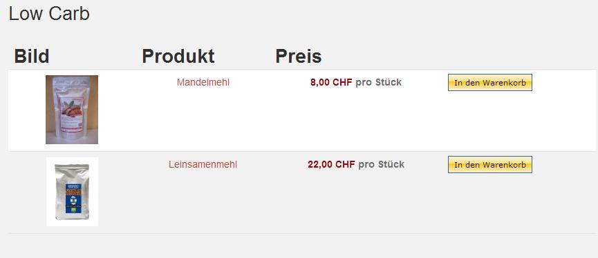

Hi there

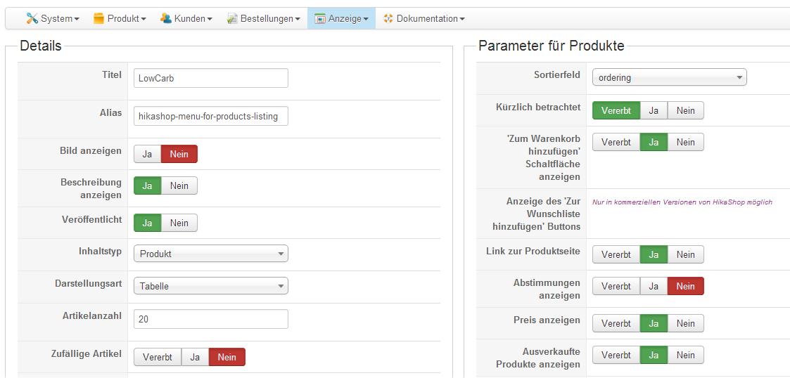

I am testing the hika shop with my new page. So far i'm very happy with it but there are some problems i couldn't get right. Here is my first one :)
Is is possible to show a little product desciption in the product listing?
I've turned the switch on for the descrition but nothting is shown.
Am i doing anything wrong?
Thanks for help

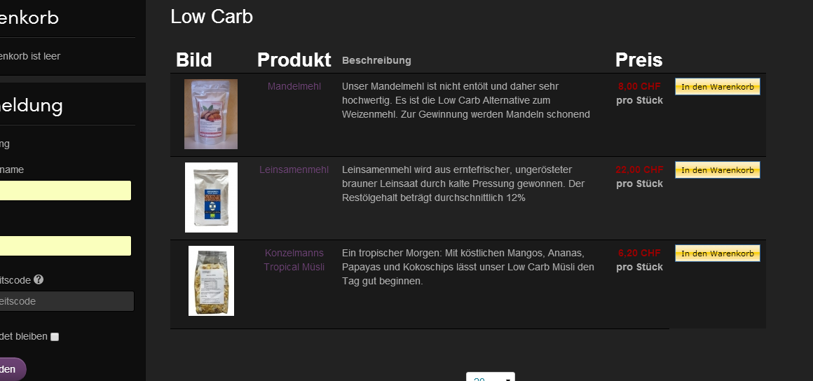

11 years 11 months ago #140549
Hi Mohamed
Thank you.
So far the description work.
But the problem is, that i only want the text before the mark "read more" is that possible?
The Idee is that in the product table, is only a short descrition of the product.
But in the product detail page, there will be more descrition for the linked product.
Best wishes
Marsipulami

  • Posts: 27
11 years 11 months ago #140564
Damn...
Mohamed you're my man :)
Many thanks....it looks great like this.
That is a product listing, like it have to be ;)
You have to be patient with me :P
