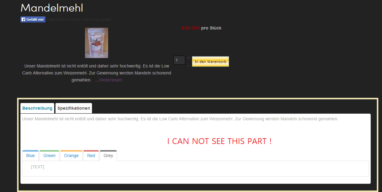

Here is my next wish during the hikashop evaluation
I would like to make the product description on the product detailpage with a tab plugin.
So far no problem.
But can i deactivate the hole descrition in the product detailview createt from the hikashop?
On the picture is a white box around my tabs.
I would like to remove it.
Only want my colored tabs not this white one from the shop.
Any Ideas?
Thanks for your support

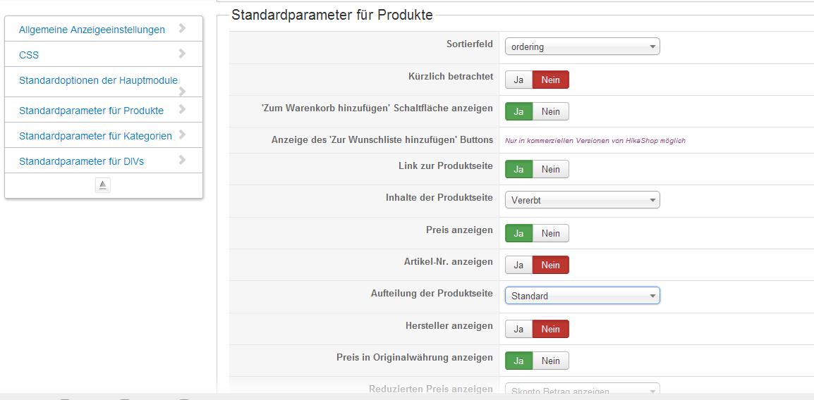

The solution will probably be to set the "Layout on product page" option to "Default" through "Hikashop->System->Configuration->Display".
  • Posts: 27
12 years 7 months ago #140736
Hi Mohamed
Still the same problem with this settings in the picture.
Did you mean this setting?
You have to be patient with me :P
  • Posts: 86077
  • Thank you received: 14184
12 years 7 months ago #140770
Then it means that you set the "layout on product page" option of categories or products to "tabular" instead of the default "inherit" value.
You can all set them to "default" and they will use the "default" product page view which doesn't add the white tabs.

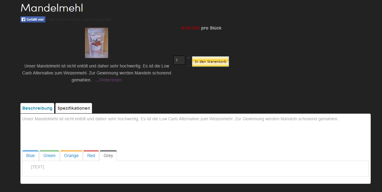

10 years 11 months ago #213479
Dear Nicolas,
I can not see the "detailed explanations/reviews" part in the product page.
Is there a special plugin or module for this?
I am sending the snapshot of the image you guys shared in this topic to show which part I am missing.
Best
Ali
  • Posts: 86077
10 years 11 months ago #213484
The tabs will only display if you change the "layout on product page" setting of the HikaShop configuration to "tabular".
Then, the tabs displayed will depend on other settings. The reviews tab for example will only display if you activated the vote and comments settings in the Features tab of the HikaShop configuration.
