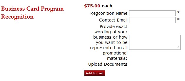

12 years 7 months ago #140739
Sure, here it is.
Alan
12 years 7 months ago #140803
You have to override the view "front-end / you template / upload / file_entry" in order to cut the file name which is displayed by this line:
<span class="file_name" style="white-space:nowrap"><?php echo $this->params->file_name; ?></span><br/>

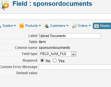

12 years 6 months ago #141478
I'm having problems having the Ajax file upload field to appear even though I have enabled and assigned to right category as an item custom field. Please advise on what I need to do to correct this.
And the field name has underscores in it rather than normal field type name like "ajax upload"
See attached. Thanks
  • Posts: 73
12 years 6 months ago #141484
Never mind, found the solution on another thread. Missing CSS code.
