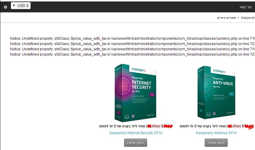

For those products defined in ILS currency when the site the currency switcher is pointing to USD, in category listing I experience the following error messages:
Notice: Undefined property: stdClass::$price_value_with_tax in /var/www/html/administrator/components/com_hikashop/classes/currency.php on line 727
Notice: Undefined property: stdClass::$price_value_with_tax in /var/www/html/administrator/components/com_hikashop/classes/currency.php on line 716

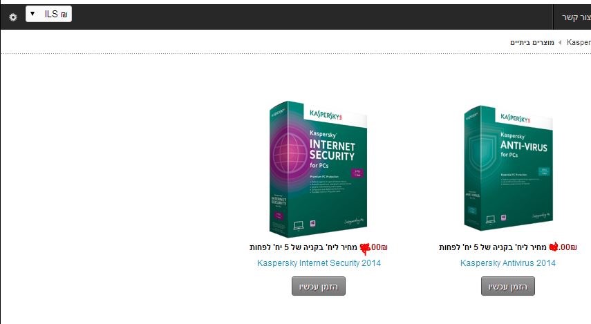

If the currency switcher is pointing to ILS the error message disappear

Turn off the "error reporting" option of the joomla configuration and you won't see them.
We'll fix the notice messages for next version.
