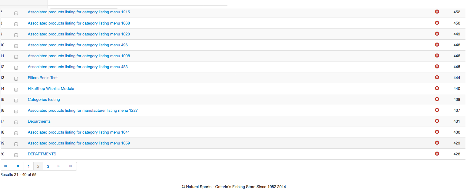

Okay I will try that - but this is what I don't understand.
How does this make a difference when I don't even have that published? see attached.
  • Posts: 108
12 years 6 months ago #141724
Okay, so I changed the ID 431 (which is unpublished) to DIV, that fixed the display issue. What I don't understand is why this has anything to do with the primary product listing in the main body? When I turn ID 431 on, it displays the products in the left menu - in addition to keeping the products in the primary body. Something seems messed up with Hikashop. How can I have it unpublished, make the change, still unpublished, but corrects the issue.
12 years 6 months ago #141741
This module was the associated module of your category listing content menu which have the ID number 1070, reading the documentation will probably help you to understand :) :
A category listing menu is only displaying the categories by itself, so that's why there the "Associated modules" option. Once you display once your menu on your front end, you should get a products listing module generated automatically and added to that "Associated modules" option. That's this module which will display the products listing under the categories. So, you can personalize the listing of the products by going in the menu Display->Content modules and editing the module associated to the menu you created OR by just clicking on the link of the module in that "Associated modules" option. You will again see lots of options to configure your products listing the way you want it.
