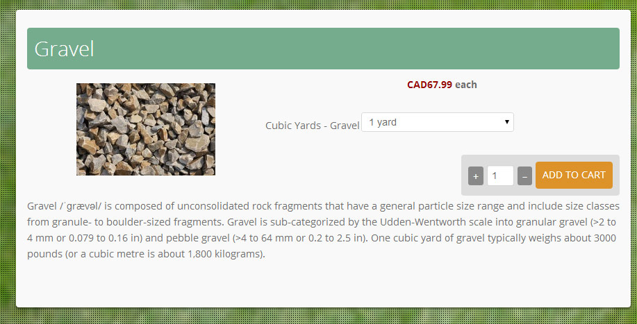

So what I'd like to do is have all items (plus, minus and quantity) display horizontally like the image I provided. I find tables incredibly frustrating to work with so any help would be appreciated. I should be able to manage the alterations providing I can figure out where exactly to make them.

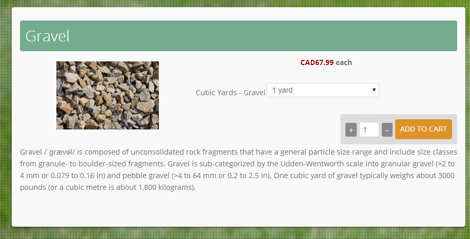

Thanks a ton, Nicolas :)
I've uploaded a screen of the updated quantity section. It's just a placeholder for now, but I think everything is ready to go into full addition mode now thanks to you!
