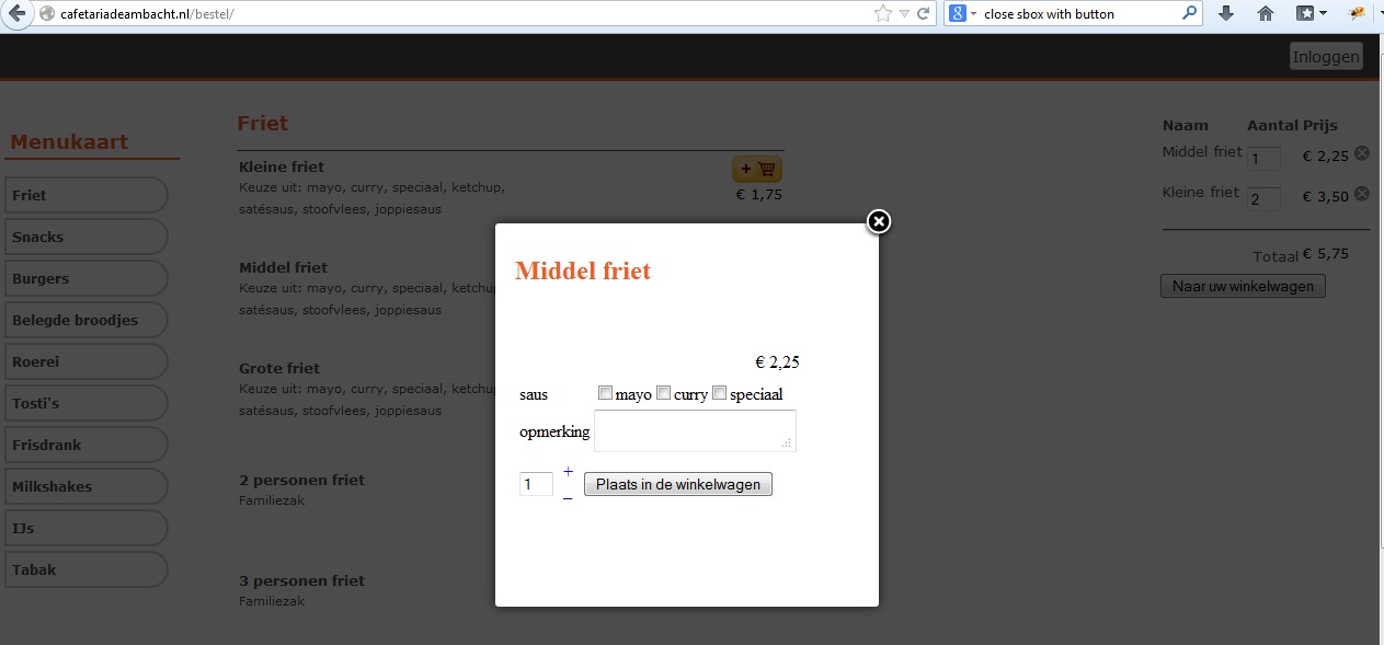

-- url of the page with the problem -- : cafetariadeambacht.nl/bestel
-- HikaShop version -- :HikaShop Business: 2.2.3
-- Joomla version -- :2.5.17 Stable
-- PHP version -- :5.4.17
I want my product view to show in a pop-up, i have done it like explained here: www.hikashop.com/forum/2-general-talk-about-hikashop/64478-characteristics-options-in-add-to-cart-popup-help.html
And it works fine but now it has to close when i click on the add to cart button. is this possible??
thanks frank

I changed the line in the quantity file. and now he close with the button :) , but he doesn't do the add to cart function anymore.
do u have any suggestion what could cause that?

Really? It does close but doesn't add to the cart, that's not what Nicolas' code should do?
Anyway it's going to be a bit harder than I though. The code that add to the cart end up by reloading the page so you can see you added your product. In this case the code closing the popup can't be executed so it will require mode code at different steps.
