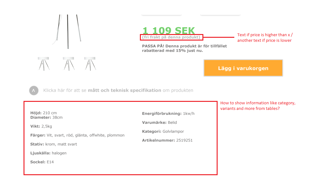

Can you guys please help us how to display information from tables such as show category and variants on product page, and how to display a certain text if the price is lower respective higher than a x value as in the attached image.

1. The solution will be to directly edit the code of the "show_default" file of the "product" view of your front-end template through the page "Hikashop->DIsplay->Views"
2. Adding your tab through your product description can be a solution :).

Yes, i know which view but not what to write to get/show the information, such as
<span id="hikashop_product_code_main" class="hikashop_product_code_main">
			<?php
      echo "Artikelnr: ".$this->element->product_code;
		</span>
but i need to show information about category name etc.
/Henrik

Using this kind of code will probably do the job if your product don't have any variant :
  if($this->element->prices[0]->price_value_with_tax > X){
  echo 'Price greater than X';
  }else{
  echo 'Price lower than X';
Note that if your products have variants, it will be more complicated to do that.
Last edit: 12 years 6 months ago by Mohamed Thelji.
