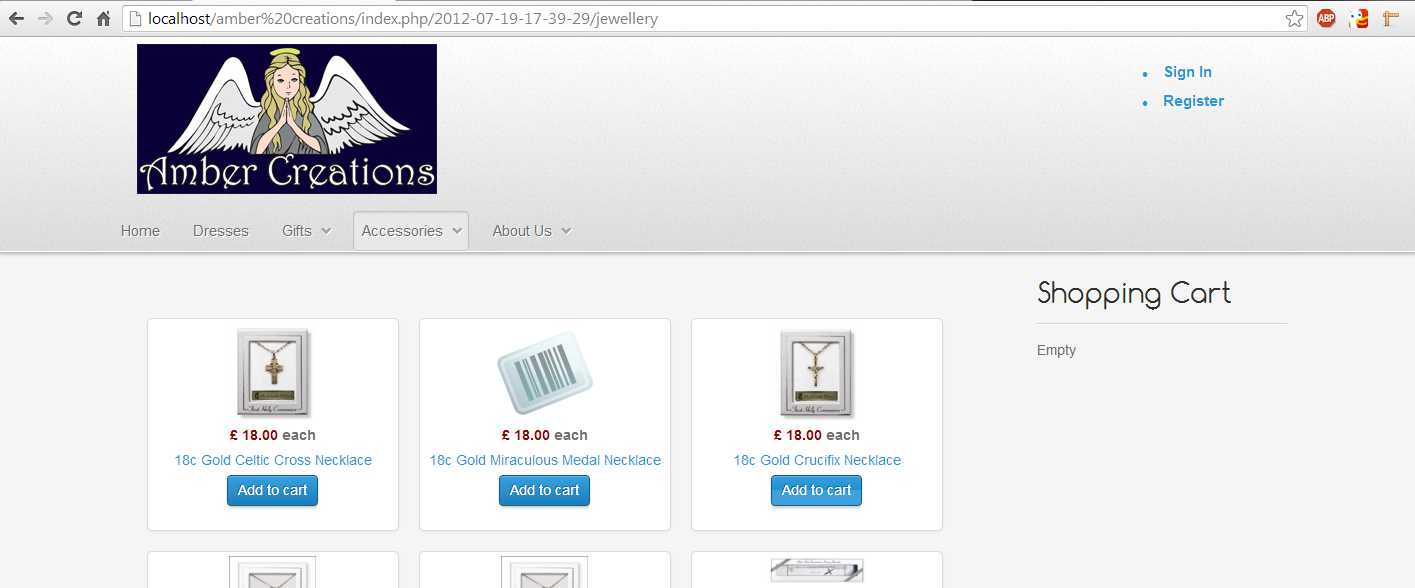

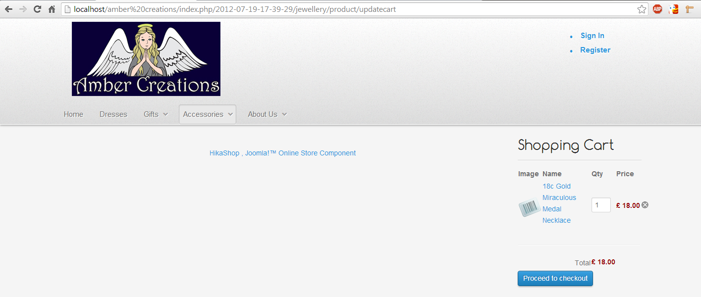

Upon Adding a product to Shopping Cart, I'm Re-directed to a white content screen with "HikaShop , Joomla!™ Online Store Component" even though I've checked the configuration option within Hikashop to "Stay and display popup notice" or "Always stay on the same page".
All the product's get replaced with "HikaShop , Joomla!™ Online Store Component" but the shopping cart on the right remains with the addition of the extra product.

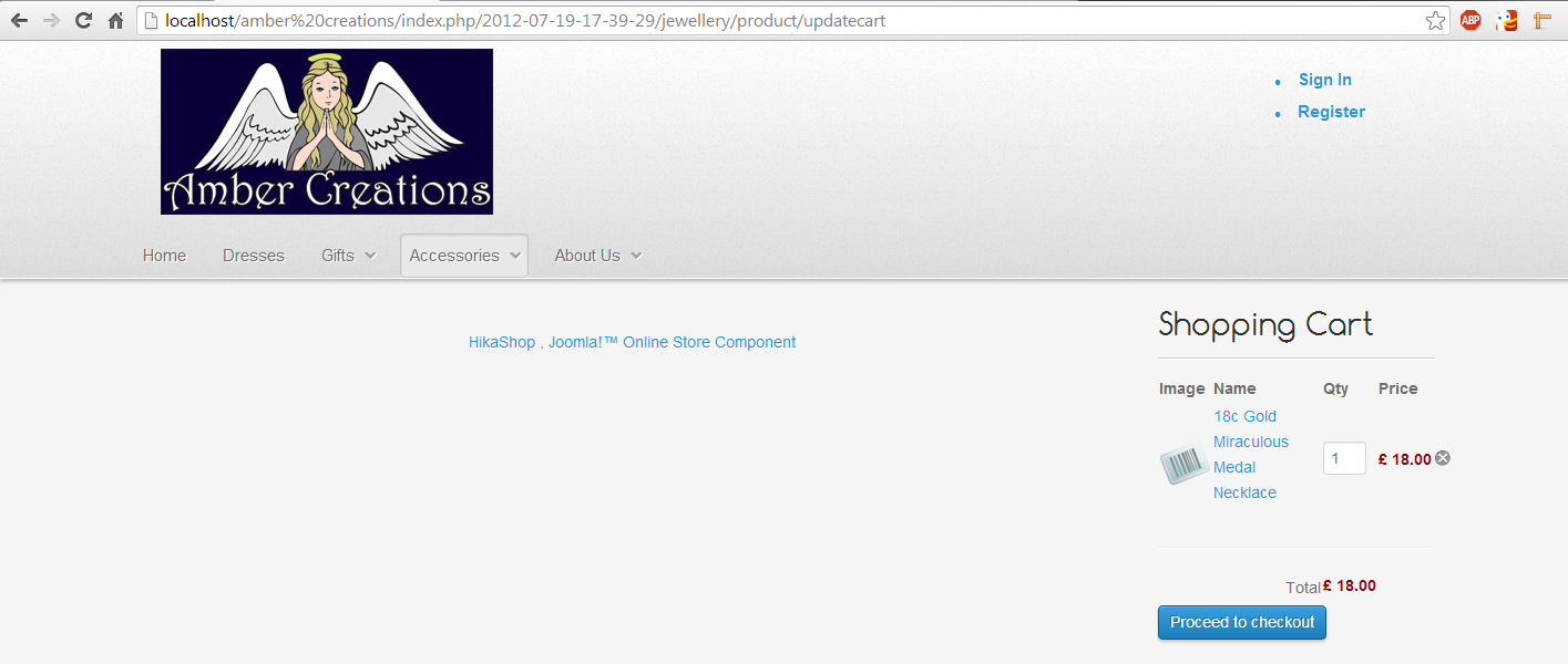

I access my product listing page through my Drop down menu to a page filled with products within a category.
When I press Add to Cart, It does not remain on the same product listing page and refreshes to the following:
No errors at all during any of this process far as I can see.
