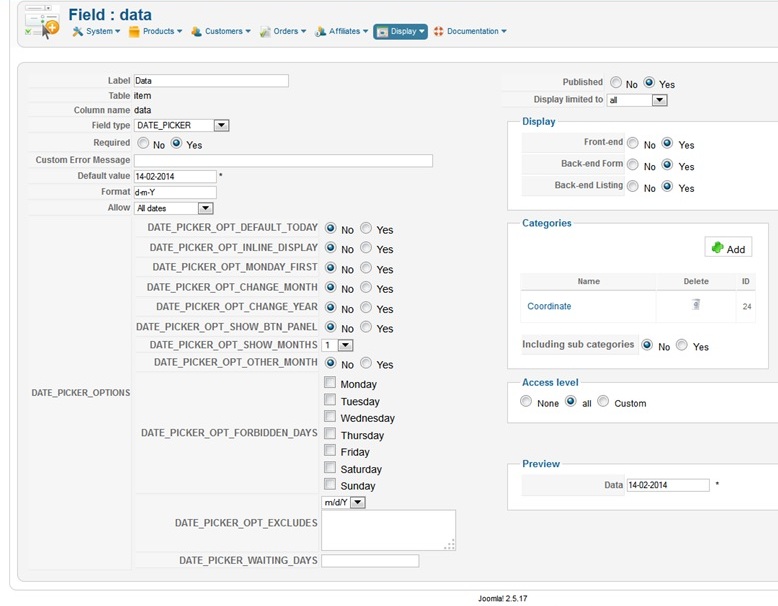

12 years 6 months ago #145551
I manged to remove the error!
Now, I have problems on labels names as you can see in the attachment.
Is the label named like you see, like "Date_picker_opt_default_today" and so on?

12 years 6 months ago #145767
The datepicker comes with an english language file.
Can you please check that the file "en-GB.plg_hikashop_datepickerfield.ini" exist in your website ?
I will try to reproduce your problem, see how the language file can not be loaded correctly.
If the problem still persists, you could copy the content of this language file into the HikaShop language override. At this moment you will be sure that the language content will be loaded.
The option "excludes" allow you to exclude specific dates ( 02/25/14 ) or date ranges ( 02/25/14-02/28/14 ). To exclude several years, you have to exclude several months ( 02/14-02/16 )

12 years 6 months ago #145805
You can use these translation, I am currently making some test on the plugin.
DATE_PICKER="Datepicker"
DATE_PICKER_OPTIONS="Datepicker options"
DATE_PICKER_OPT_DEFAULT_TODAY="Default today"
DATE_PICKER_OPT_INLINE_DISPLAY="Display inline"
DATE_PICKER_OPT_MONDAY_FIRST="Monday first"
DATE_PICKER_OPT_OTHER_MONTH="Show other months"
DATE_PICKER_OPT_FORBIDDEN_DAYS="Forbidden days"
DATE_PICKER_OPT_EXCLUDES="Exclude days"
DATE_PICKER_INCORRECT_DATE_FOR="Incorrect date for: %s"
DATE_PICKER_OPT_CHANGE_MONTH="Month selector"
DATE_PICKER_OPT_CHANGE_YEAR="Year selector"
DATE_PICKER_OPT_SHOW_BTN_PANEL="Show buttons panel"
DATE_PICKER_OPT_SHOW_MONTHS="Show months"
DATE_PICKER_WAITING_DAYS="Waiting days"
The plugin hasn't been designed for including dates, mostly for exclude some.
I have to test it in order to confirm it but you should be able to use :
01/1900-12/2012
01/2016-01/2100
Or maybe, I could see to let the calendar options "min date" and "max date" available in the plugin options. At this moment you would be able to specify the minimum and maximum available date.
