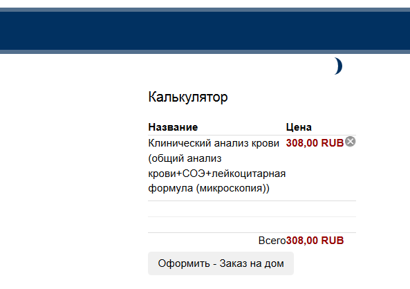

Problem with my cart, cant see Print icon.
  • Posts: 7
12 years 6 months ago #144371
-- url of the page with the problem -- : md-test.ru/index.php/2014-01-28-18-35-30/2014-01-28-18-36-20
-- Joomla version -- : 3.2.1
-- PHP version -- : 5.2.17
-- Browser(s) name and version -- : ALL Safari, Firefox, IE, Chrome
-- Error-message(debug-mod must be tuned on) -- : there no error because i cant see the icon
I don't know what else I can do, everything is enabled at settings (I think) Using T3 template - t3-framework.org if adding manually print code to site its printing the whole page, and what I need is just to print the cart.
Last edit: 12 years 6 months ago by george1988.

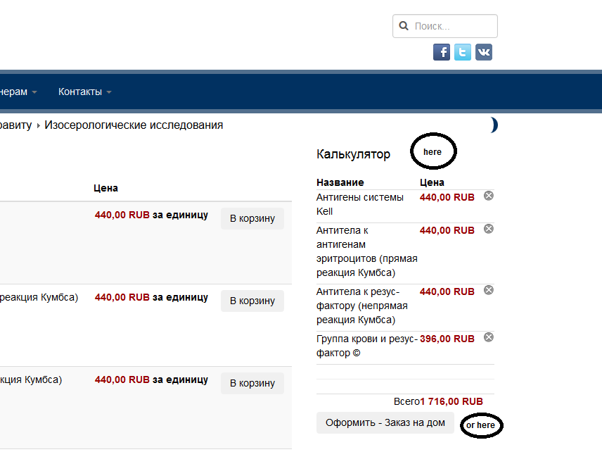

12 years 6 months ago #145269
If possible I want to add the "Print" icon to my cart, the picture is below.
Thanks a lot.

  • Posts: 7
12 years 6 months ago #145406
Jerome wrote: Hi,
The print icon is available when you are displaying the cart but is not displayed in the cart module.
if you open the page " index.php?option=com_hikashop&ctrl=cart " you should see the print icon with the special link to print to cart.
Thanks this little HTML code and to the feature of view overrides, you can override the view "product | cart" and add the print icon like you want in the module.
More about view override :
www.hikashop.com/support/documentation/i...op-view-listing.html
www.hikashop.com/support/documentation/i...ashop-view-form.html
:-/ any ideas how I can add it to the module?

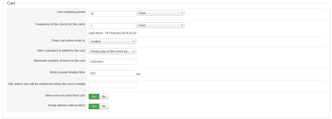

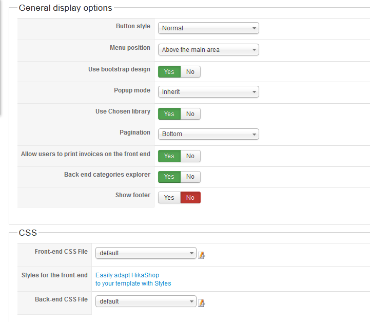

12 years 6 months ago #145517
There's already an option to do that, so you'll just have to set the "Allow users to print their cart" option to YES through "Hikashop->System->Configuration->Main->'cart'".
  • Posts: 7
12 years 6 months ago #145847
Mohamed Thelji wrote: Hi,
"Allow users to print their cart" is already enabled! but I see nothing! at the cart itself.
this is the reason why opened this thread. :huh:

12 years 5 months ago #146464
