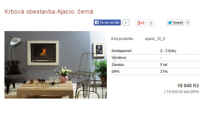

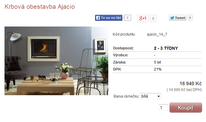

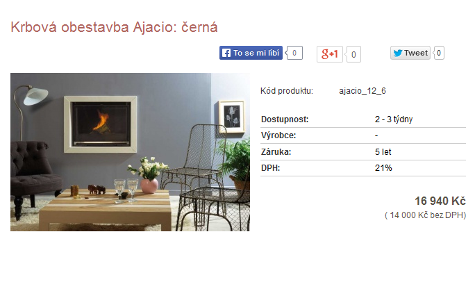

On front-end page I see them.
When I choose one of the characteristic I see the page withou "add to cart button" and without possibility to choose different value of charactersitc.
See pictures.
The amount of pieces is set up on unlimited.
I can not find the mistake or solve the problem. Could you help me, please?

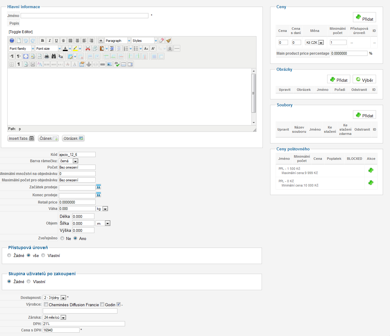

Can you show me through some screenshots how did you configured one of your product variants which doesn't show any add to cart button through your product page ? Also, giving me a link to the page where you're having that issue will probably help me to understand the problem.

The page with configuration of the variant is in attachement.
I comapre the setup with the set up which is at demo version of Hikashop. I did not see any difference. Maybe I aredy doesnť see the difference. I try to find where the problem can be.
note: The value "bez omezení" means "unlimited".
