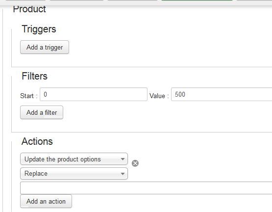

  • Posts: 41
12 years 6 months ago #145570
Mohamed Thelji wrote: Hi,
1. Note that regarding the Triggers and Filters options you'll probably find your answer by reading the documentation :
Triggers : Triggers allows you to specify when the mass action should be processed. You can either use it to execute your mass action on a regular frequency (for example you can import a csv with your products every day, updating your data according to the modification you made in the file), or execute the defined action on a given trigger like after a product is created. This way, you will be able to define for example a weight for a newly created product if you didn't specified any, avoiding shipping method errors. If you use a time trigger or click on the process button, the system will use all the data available but if you choose a trigger like "after a product is create", the mass action will run only on the data of the trigger, so only on that product in that case.
Filters : Here you can add filters to your mass action. For instance, you can specifically select products which belong to a category or customers living in Europe. Thus, you can process actions only on the selected data. Note that the number of elements filtered will be displayed next to the dropdown, letting you know how for example much products will effectively be processed in the given category.
2. You should :
- Add a Filter on "product columns" where "product_weight" = 0
- Set "update values" for the Action where "product_weight" = 100 (for example)
Thank you Muhamed
I have attached a screen shot of the settings I used because I still can't get it to work.
I can't see where I've gone wrong.
  • Posts: 86080
  • Thank you received: 14186
12 years 6 months ago #145622
In the "Value" field of the filters area, please enter a big number like 3000 so that is applies the actions on all the products.

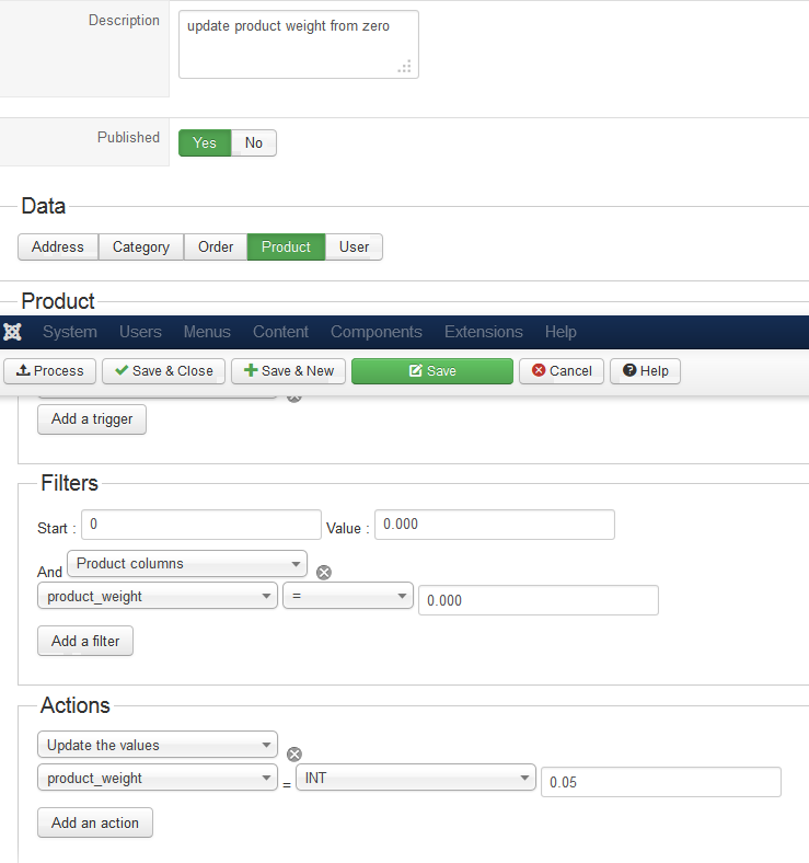

12 years 5 months ago #146667
Thanks to try with the new config I made, and make a backup before :) (like an export of your products)
The problem was that you had to specify "FLOAT" instead of "INT" in the action part to allow the decimal numbers.
The following user(s) said Thank You: signpost
  • Posts: 41
12 years 5 months ago #147278
Thank you very much for your help, we finally got it to work.
