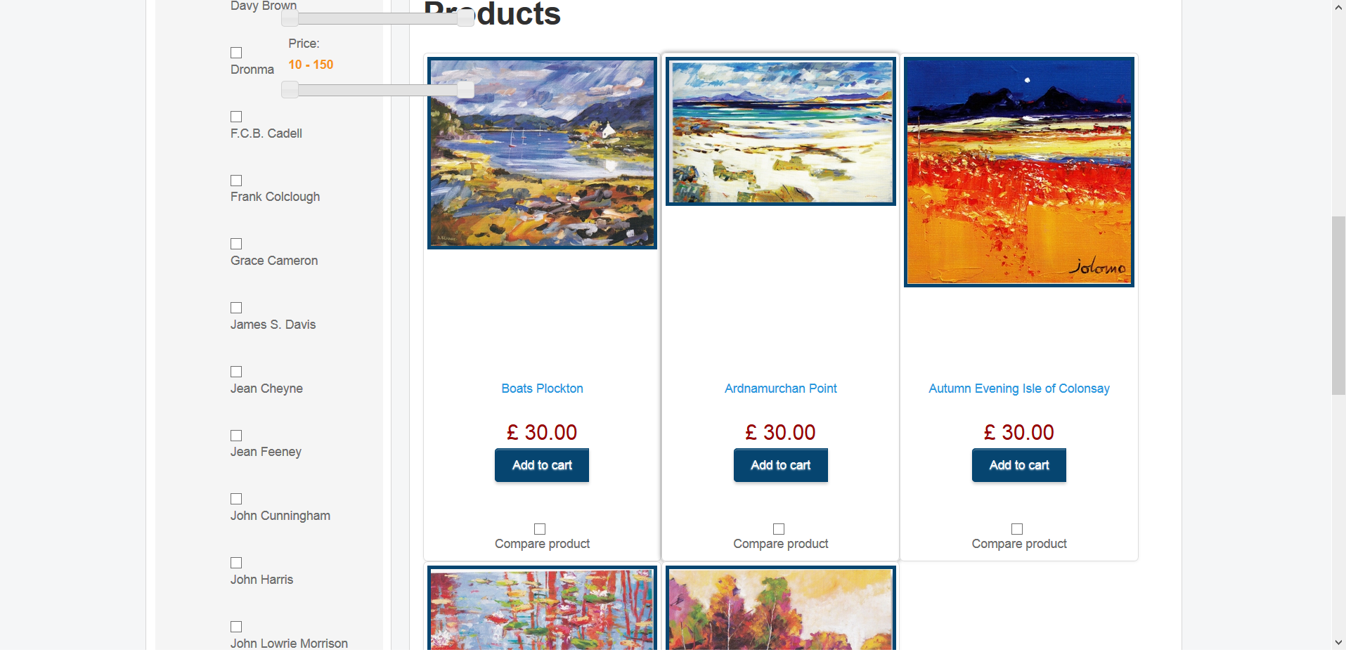

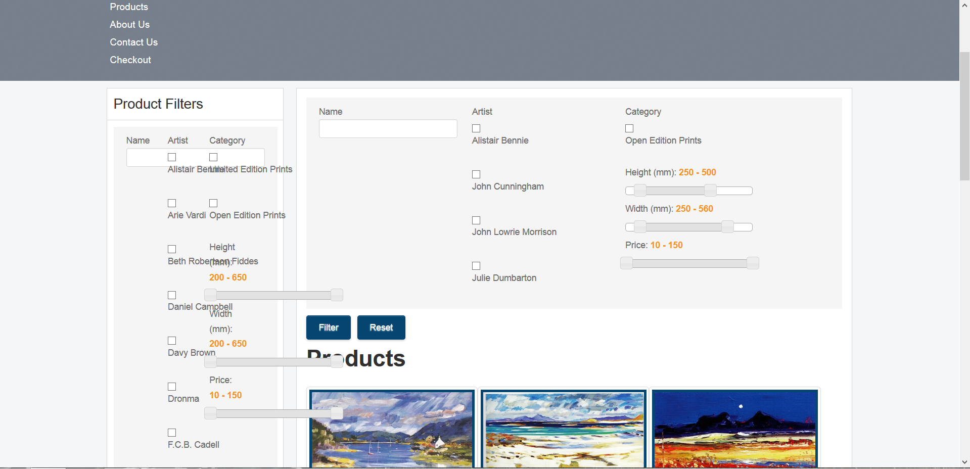

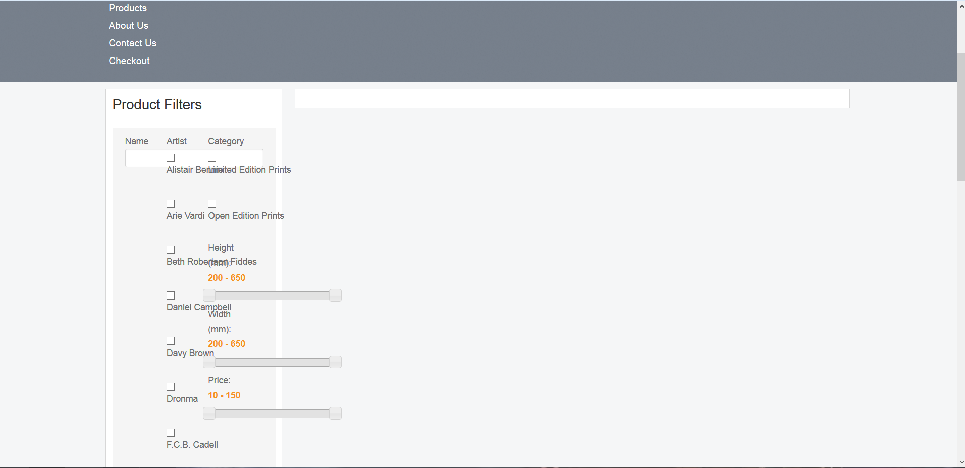

1. The formatting of my main menu and the filters sections of my website are all wrong. The menu does not move horizontally along the bar at the top like it's supposed to, although it's possible this could be a template issue. The filters for some reason display on every page on my website in the sidebar, but then show every available option even when there is nothing in that option, and then try to cram them all into a small space where they end up displaying over each other rather than splitting into columns or some better solution such as changing into an expandable category. In the products section they actually display twice, once at the very top of the page (which aside from being aligned the wrong way works as it should) and once in the side. I'd appreciate some help with that. Images are below.
2. The filters appear on every single page, not just the products page, so I'd like help with that.

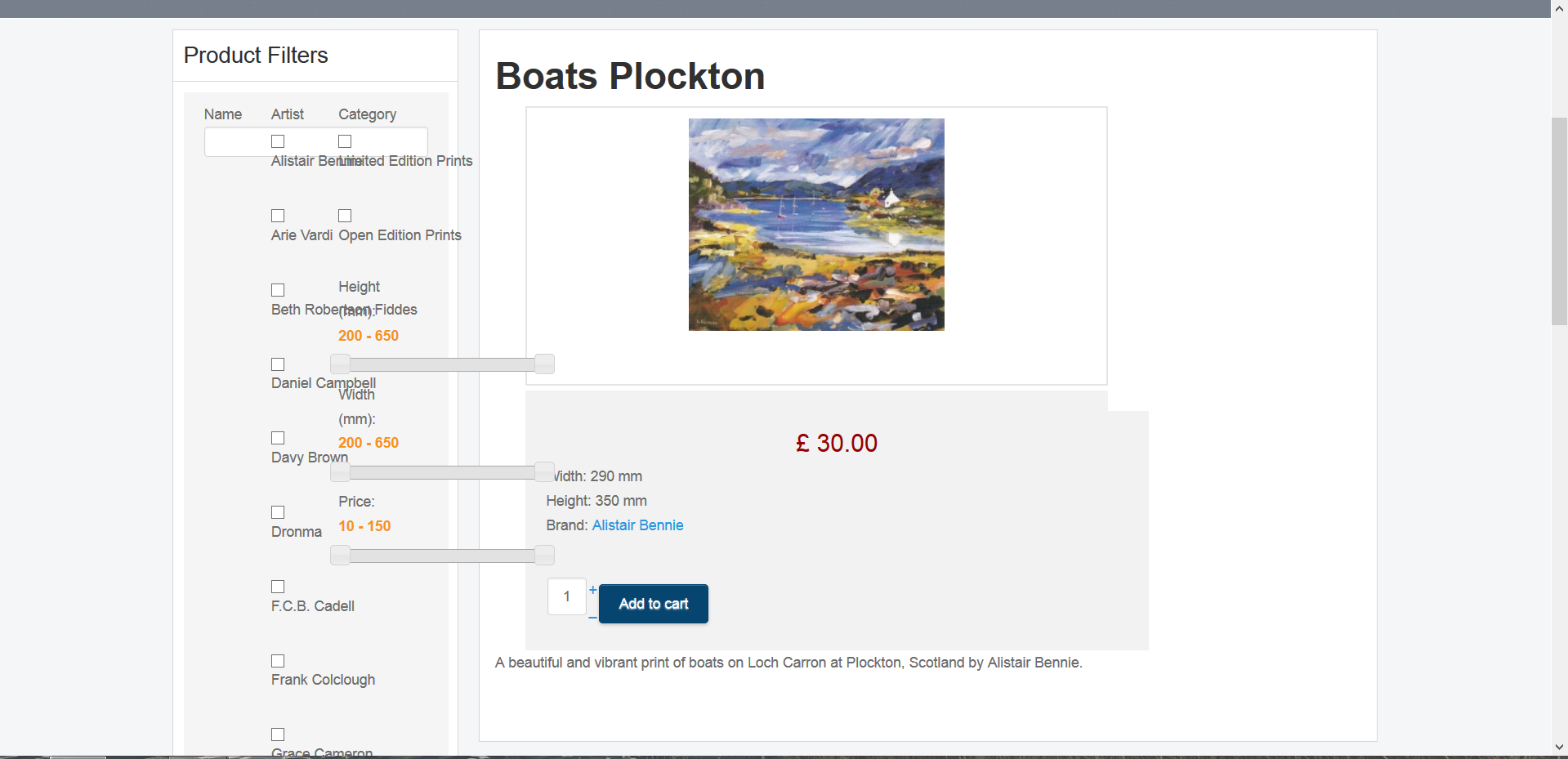

4. On the page of the individual product I would also like the description to be within the grey box, between price and width, and would like the awkward, uneven grey strip at the top of the box removed.

I just fixed issue 2, but the rest still stand. It also seems having two filter modules on display causes chaos with the one you don't use when a filter is applied, and even more when you add a filter on one and then remove it on the other.

1. If you leave the filter selection option empty, the module will display all the filters. If you don't want to display any filter on the side, instead of leaving that option empty, you could disable the module. If you select some filters in the option, only these filters will display on the module.
You see them like that because the module "number of columns" option is set to 3 or empty instead of setting it to 1.
And you see the filters on the top of the listing because you have the "display filters" option of your products listing menu/module turned on. And you see the filters on the side after you choose one because you have the filter module assigned to the menu item for which you entered the id in the force menu option of the module.

4. As this is apparently set by your template CSS, we would need a link to the page to be able to say what to do for the grey area not being correctly displayed. For the description, you can move it inside like that:
www.hikashop.com/forum/2-general-talk-ab...ove-add-to-cart.html

6. Ah yes, if you display the same filter on different filter modules, it won't work properly as the ids of some of the elements will be the same. It should however work fine for different filters.
