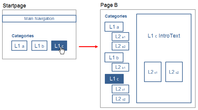

We have to setup a new HikaShop structure like this:
Our problem: We can't mark the selected category from startpage on the "Page B".
Any ideas?
  • Posts: 86080
  • Thank you received: 14187
12 years 6 months ago #145362
In the "menu" option of the module of the start page, make sure that you selected the same "menu" that you have selected in the "menu" option of the module of the Page B and that should help. You can check that via the menu Display>Content modules of HikaShop.

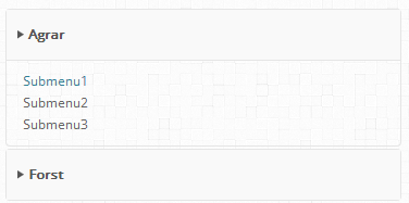

Here is a printscreen of my left navigation ("Page B"):

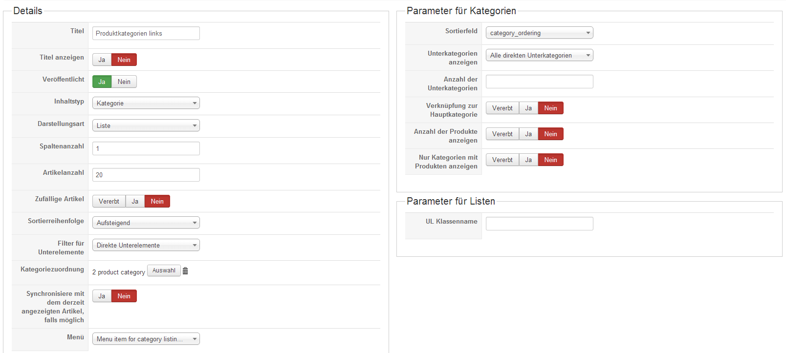

  • Posts: 19
12 years 6 months ago #145695
Here it is:
12 years 6 months ago #145764
The configuration seems to be correct.
A link to your website could help us to solve the problem.
Actually it's difficult to know why it's not working the correct way.

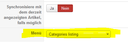

  • Posts: 19
12 years 6 months ago #146049
I got it. The problem was the wrong menu assignment in the Hika Modul:
It should be "Categories listing"
But, now the next problem:
