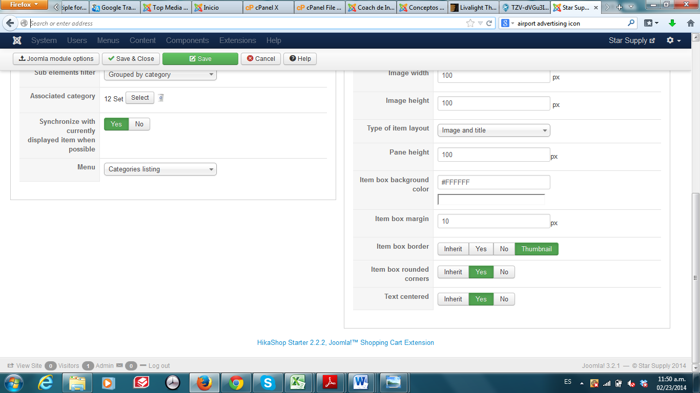

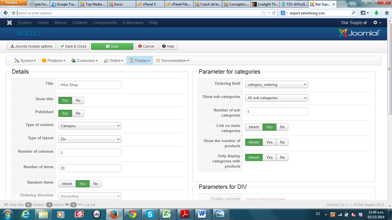

It's probably that you configured the module options in a way that doesn't display any product/category.
Could you provide a screenshot of the Hikashop options of your module (via the menu Display->Content modules) ?

The module is not configured properly as far as I can see.
First, the synchronize with currently displayed item when possible option should be turned off, otherwise, you might not see anything based on your page you are on.
Then, in the associated category option, you should select the main category where your categories that you want to display in the module and not select one of them.
Finally, the sub element filter option should be set to either direct sub elements or all sub elements.
