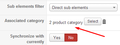

    • Posts: 22
    12 years 4 months ago #145518
    Hi again
    Still no luck with this, mostly I think because the Associated category in the Details of the module won't stay as the one I choose.
    No matter which one I choose, it always goes back to this after I click save:
    2 product category (which is the default one)
    12 years 4 months ago #145520
    I think that we already fixed that issue, so can you download the last Hikashop version again through our website, install it and test it again ?
    • Posts: 22
    12 years 4 months ago #145524
    Since 19th february?
    but hopefully :)
    • Posts: 22
    12 years 4 months ago #145525
    :whistle:
    Awesome!!
    works perfectly and would have the first time (probable would not have had to post for help :) )
    I thought I was going nuts!
