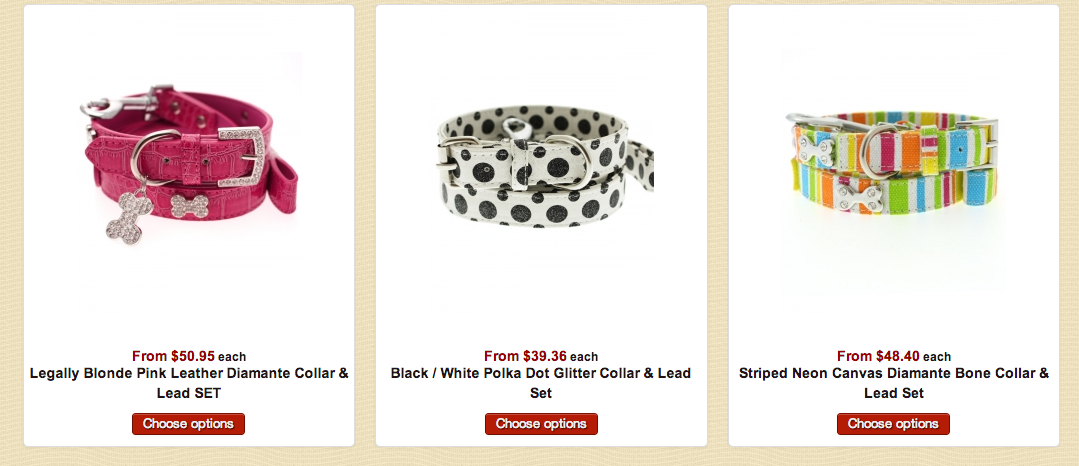

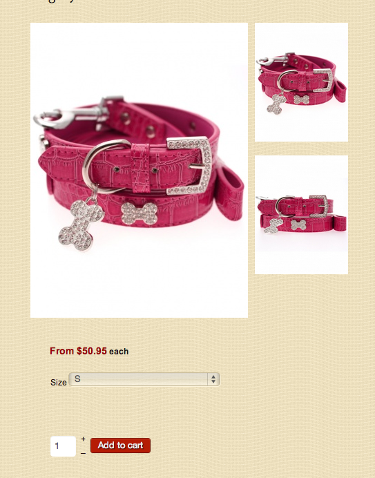

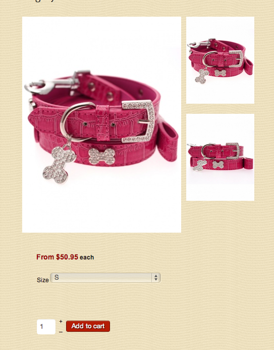

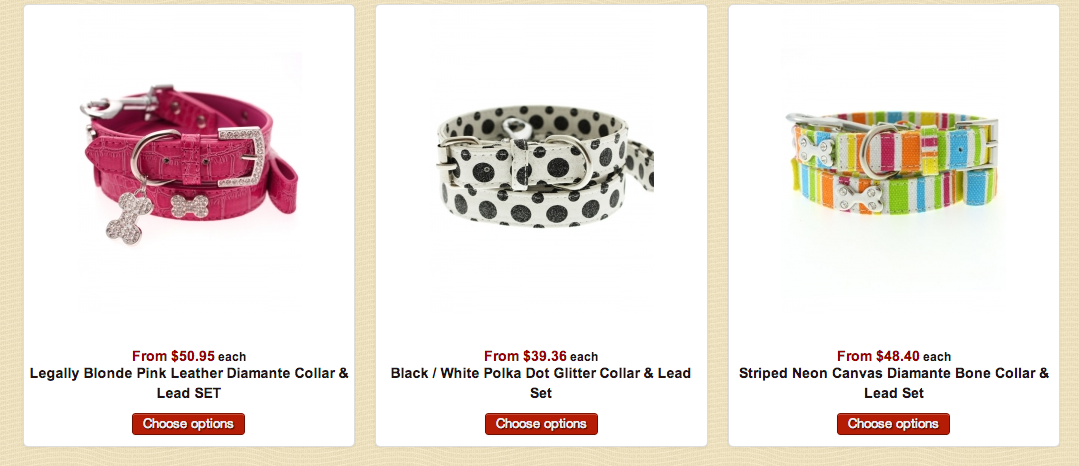

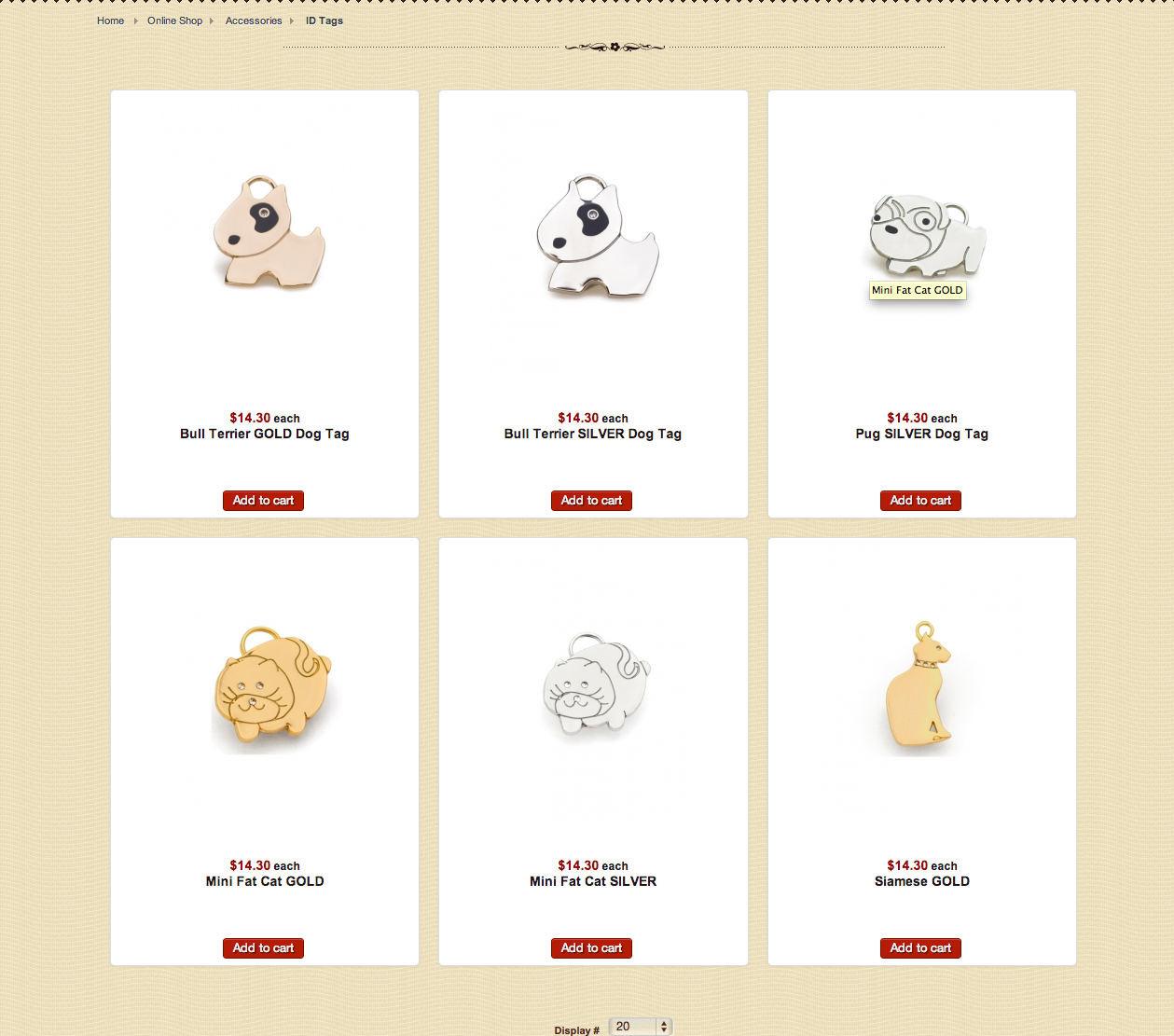

Hi, if possible I would like to show my product prices 'From $...' I only want it it like this where all the products are displayed of a partical Category as seen in my first attachment. I could change it by going to System-Currency, then change the code to 'From $' BUT as seen in my second attachment, I do not particularly want to show my product prices with each characteristic displaying 'From $30', 'From $40', From $50' ...etc for a particular product. It may just confuse a client.

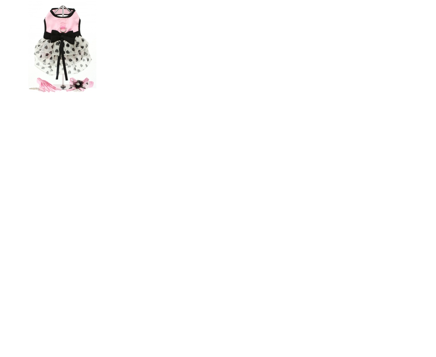

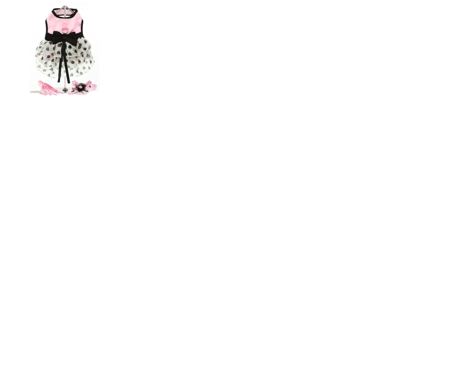

Unfortunately, that did not work either...Once I add 'From $' to the file and I go to click on one of my categories, I only see one of my products randomly on the left hand corner of a white page. See photo attached.

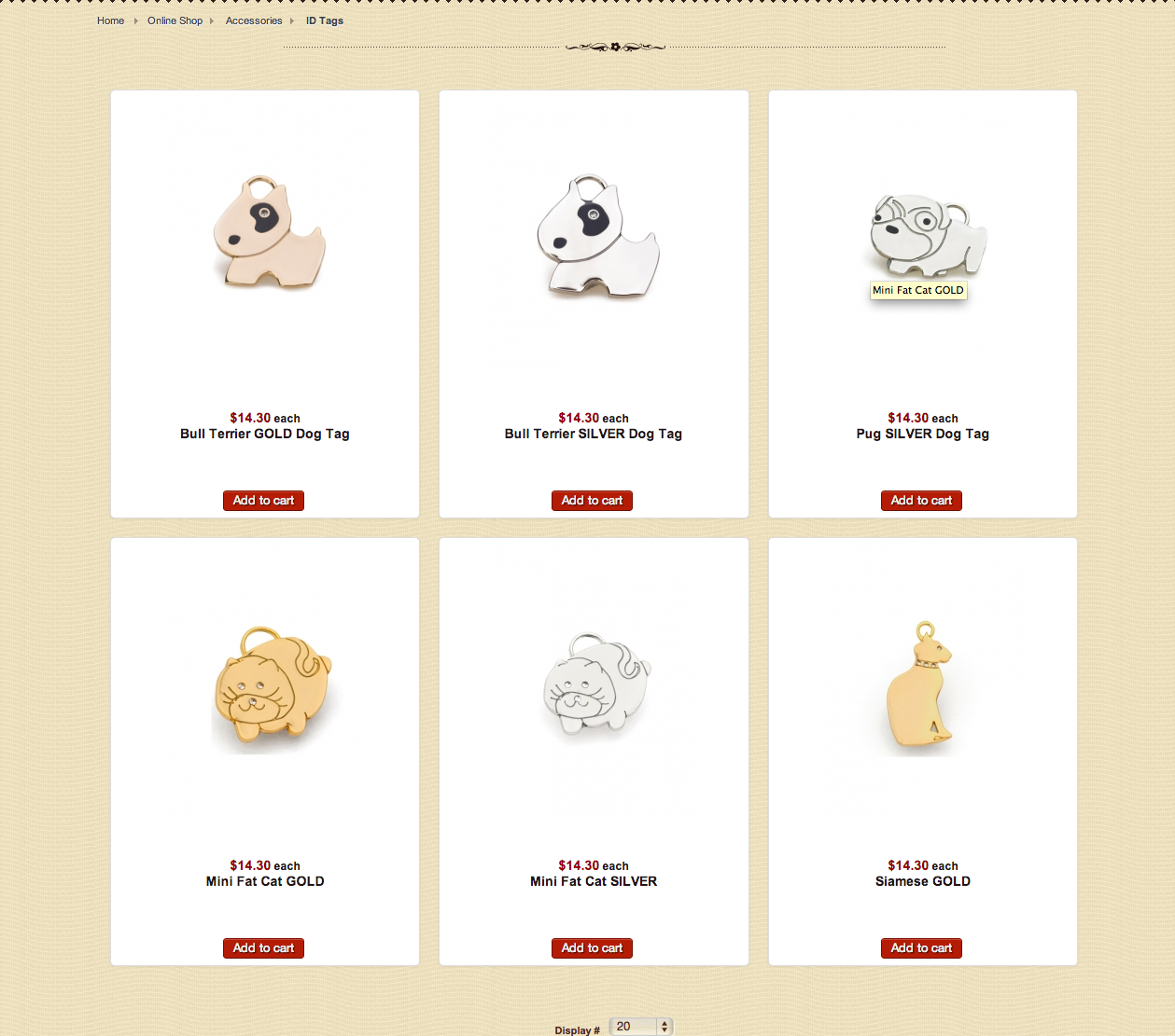

You are most welcome to add the required codes to my website, but I do not expect you to do it for me! :) However, if you are happy to do it, then could you only add 'From $' to the products displayed in blocks in each category. See attachment to understand what I mean.
