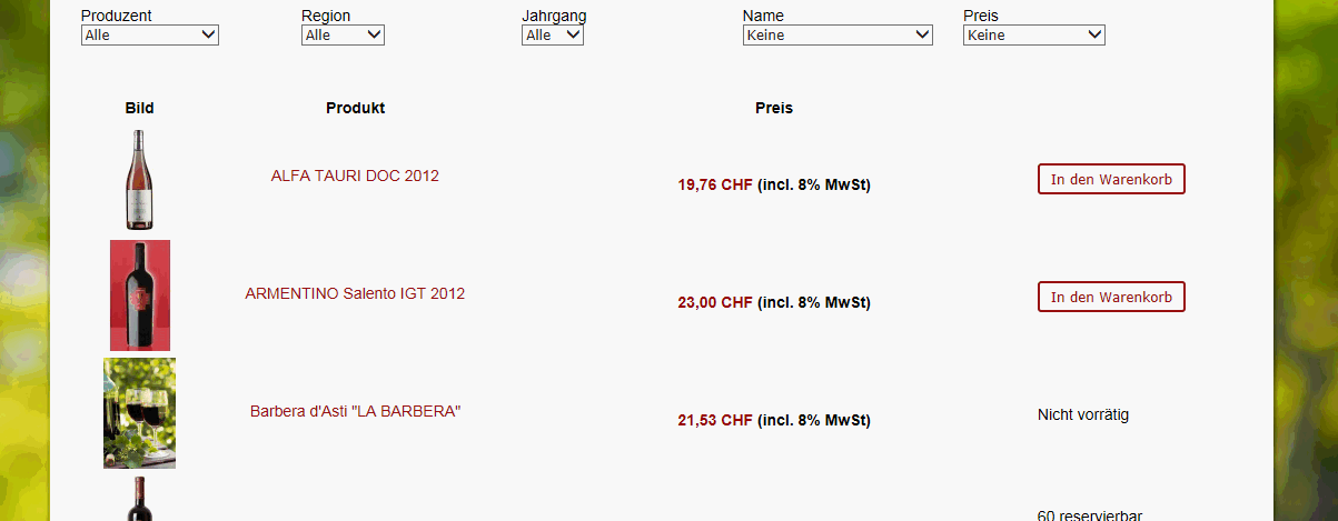

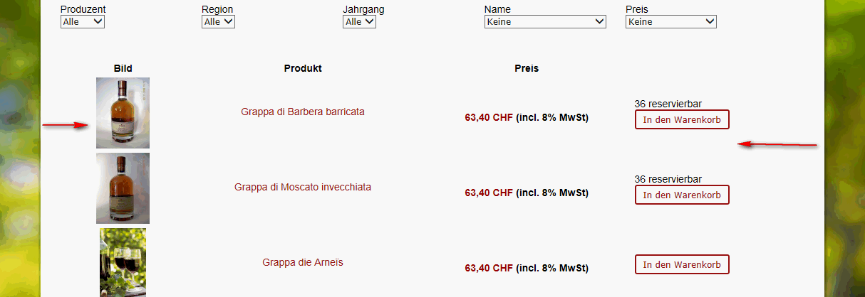

I have different views on the categories.
But the menu settings are identical. It is not always used the same width.
What am I doing wrong?
Examples Categories:
Cat1
Cat2
Examples Manufacturer:
Man1
Man2

12 years 6 months ago #145838
The two tables are the same, same CSS properties, etc.
The thing which change the way they are displayed is their contents.
If you remove the long titles and/or prices so the table will go back to the left as the second link.
