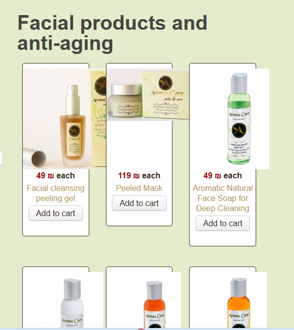

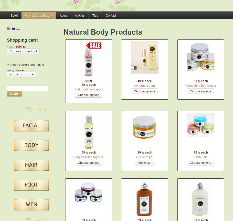

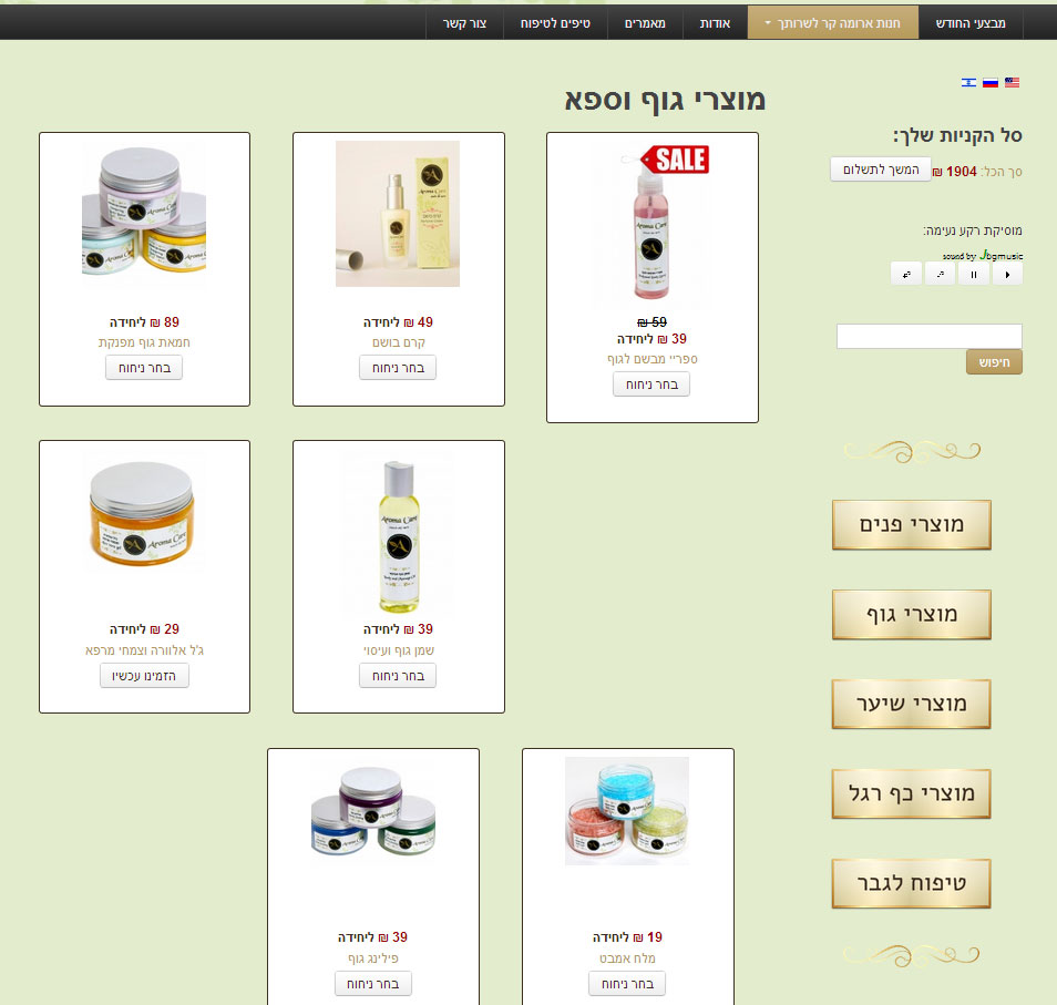

Hi, I just have this problem with the product listing page, everything is working fine besides that, RTL & Bootstrap. I dont know why you cant see the site, its fine: www.aroma-care.co.il/ but anyways here are some jpg - english (ltr) in bootstrap design & in Hebrew (rtl) in bootstrap design. If bootstrap design set to NO, there is no problem! but I want the site to be accessible via smartphones as well.

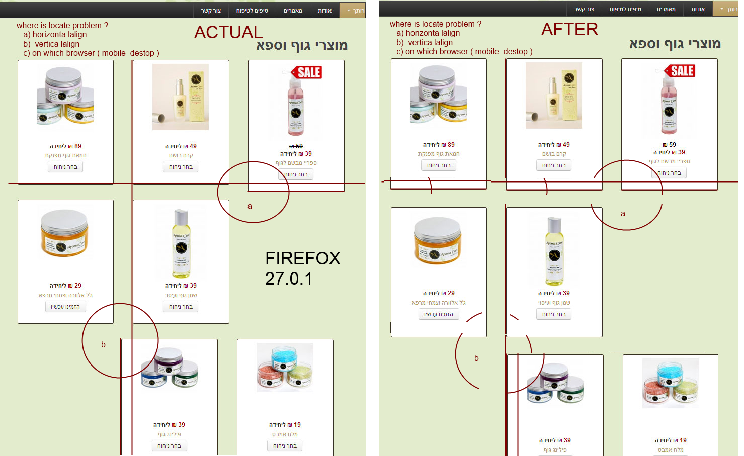

a---the layout using english is wrong when we reduce the width size of the browser
b-- in default language there is wrong alignmeent vertical and horizontal ?
where is the problem ? can you create a virtual capture screen with what i have and what i want and highlight the problem in one raster file ?
c- THERE IS 17 js and 40 css !!!!!!!
d- you use the bootstrap T3 blank FW ( i don't test it a lot )
e- 17 mediaqueries but only 8 breakpoints !!! WOUAHH !!! ( don't test or try to understand logic )
I dont really think it is a rtl problem . capture screen is not efficient if you don't highlight the problem ( arrow annotation ) .
An image is 1000 words but ti s easier with some informations ( capture screen before after , actual - aim ) .
So refer to the problem ( image outside box , different vertical/horizontal alignement ) ,here is 2 changes that i think could resolve the problem ( don't know if related to the post ) . It can create other problems because i not test combination of language & mediaqueries ( size width of browser )

Hi, thanks for helping, the problem is that in ltr language the products are oriented in a nice table and in rtl they are not. If you know how to solve this I'll appreciate it a lot. Purchasing ans Installing Hikashop Styles didn't work... :S
