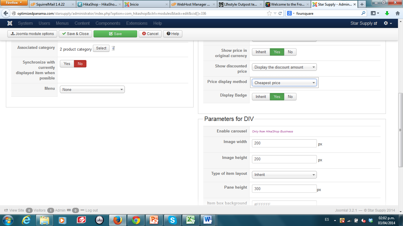

  • Posts: 122
12 years 5 months ago #146600
I am editing Display / Content Module / HikaShop Content Module / Parameters for DIV
Where should the settings go?
Mike

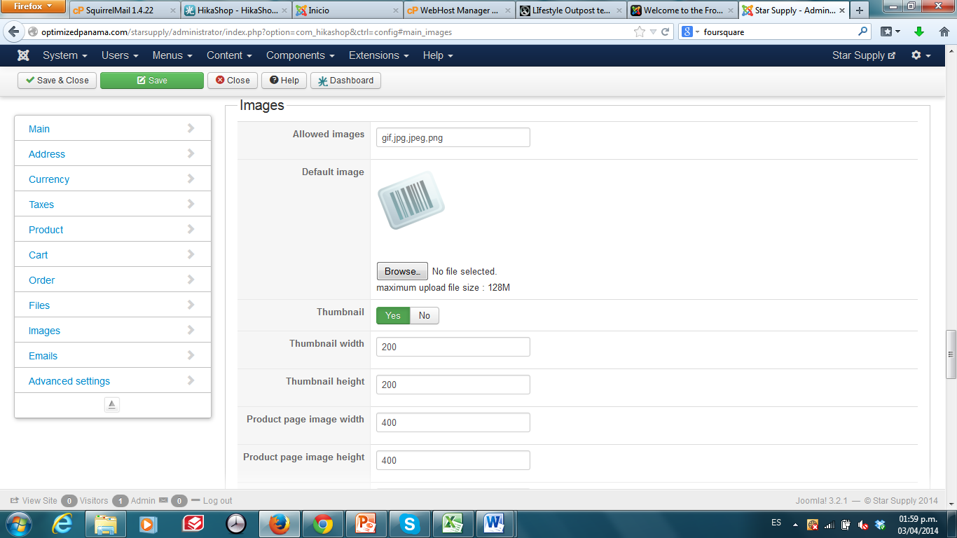

12 years 5 months ago #146628
I think that you have to change the settings in Configuration > Main > Images.
  • Posts: 122
12 years 5 months ago #146739
Configuration > Main > Images. are now also set to 200 x 200 but the default product image is still overwriting the title and the price.

  • Posts: 122
12 years 5 months ago #146866
Hi Eliot,
I attach 2 screenshots both showing 200 x 220
I just need to find out how to adjust the appropriate config that is making you see 100 x 100
Mike

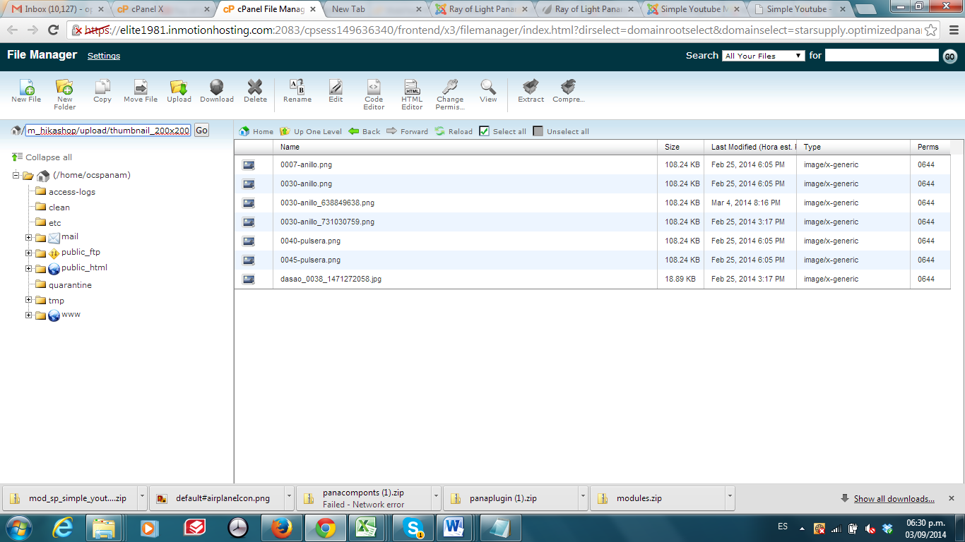

  • Posts: 2334
  • Thank you received: 403
12 years 5 months ago #146912
Are you sure you are editing the right module/menu?
Also, do you have a caching system enabled on your site? If yes, you should try to disable it.
Could you also check that you have the right thumbnails in media/com_hikashop/upload (there should be a 200x200 folder)
  • Posts: 122
12 years 5 months ago #147596
Hello Eliot,
Sorry that I have taken so long to get back to you.
I only have one module published - and I edit via Display / Content modules - is this correct?
Caching is disabled
I attach a screen shot of the file manager folder with the 200 x 200 images
I am sure that you can see the 100 x 100 set up somewhere but I just cannot.
I can send you my login details for you to have a quick look so that we can move on and set up the project - please let me know how to send them to you.
Thanks,
Mike
12 years 5 months ago #147619
We can see that 100x100 thumbnails are used in frontend thanks to the browser console.
Editing via Display / Content modules is indeed correct.
Thanks to update your version with the newest one, the 2.3.0, if the issue is still not fixed, thanks to give us the login details via private message with the link of this topic.
