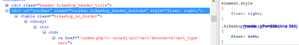

I have checked with firebug and it is ".hikashop_header_buttons" found at "frontend_custom.css?v=230". At that file I change to float:left but nothing changes.
At the top of firebug script I see :
element.style { float:right } and that still keeps floating to right
Any idea of how I can change this ?

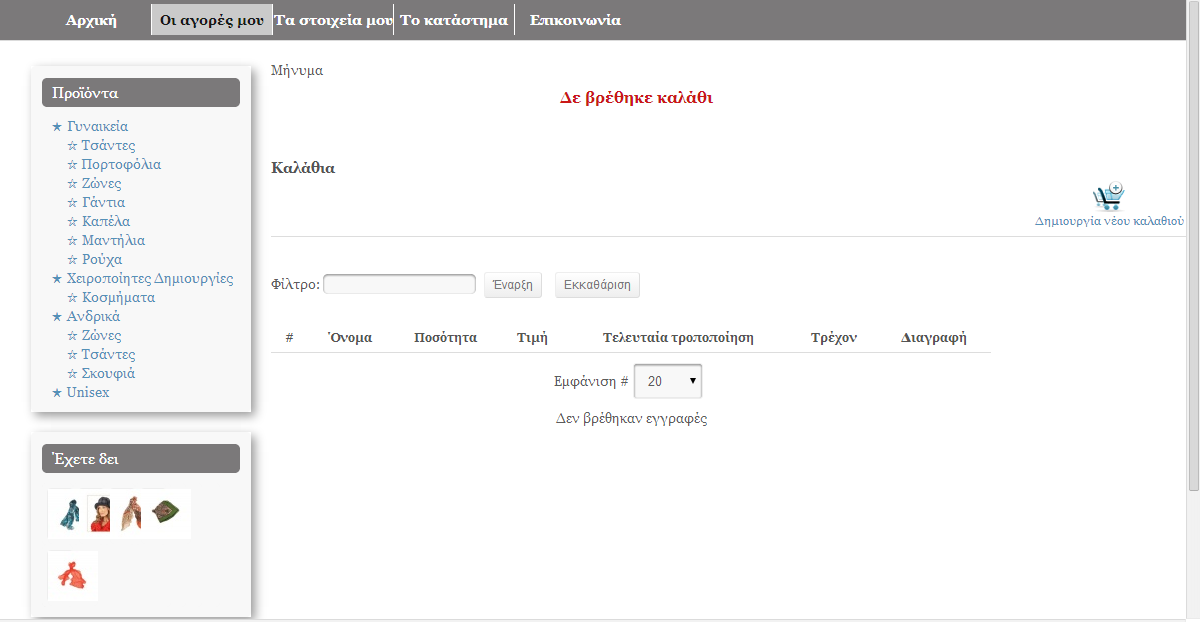

As you see at page-min.png the icons are out of the border of the page.
I want to align that bar left so it will appeare under the title.

I have read that tutorial but did not help as I can not find where that "element.style" comes from

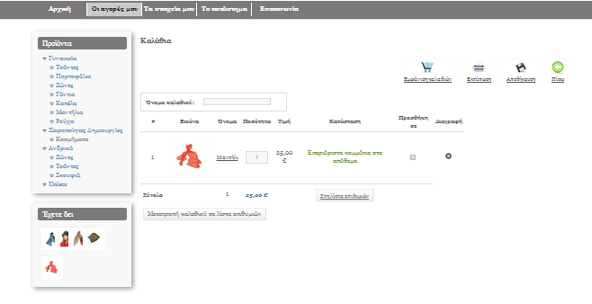

.hikashop_header_title is shown at header possition of the template that I use and its width was set to 960px.
As I had a left module active, that was not correct. I changed to width: auto and everything is fine now
