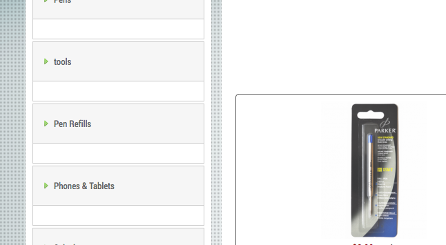

Guys,
I'm having trouble getting a content module to display multiple category levels. Set up is as follows:
The module displays as follows:
Pen refills has 5 sub categories but these aren't displaying.
Template is JSN Mico but I have the same issue on JSN Glass.
Not sure if this is a module problem or a template issue. Any advice appreciated.

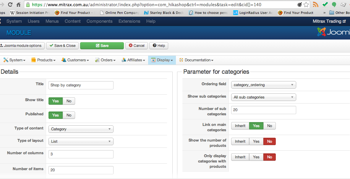

You're not looking at the correct options. Your options screenshot is for the category listing menu item, while the category listing on the left of your frontend is a category listing module.
So go in the menu Display->Content modules, edit your module (id 140) and here you can configure if you want sub categories to display and how in your left module.
  • Posts: 76
  • Thank you received: 5
11 years 6 months ago #147604
Thanks Nicolas,
The options for module 140 are below
I think I am looking in the right place , could you check what I have done ?

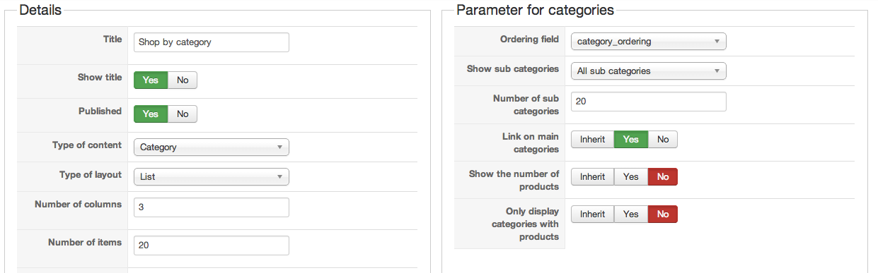

11 years 6 months ago #147618
Can you try it with the Show sub categories and Sub elements filter of you Hikahsop content module category listing to All direct sub categories/Direct sub elements ?
Thanks :).
  • Posts: 76
11 years 6 months ago #147623
Changed config as follows:
It does change how the module is displayed but sub categories still aren't displaying.

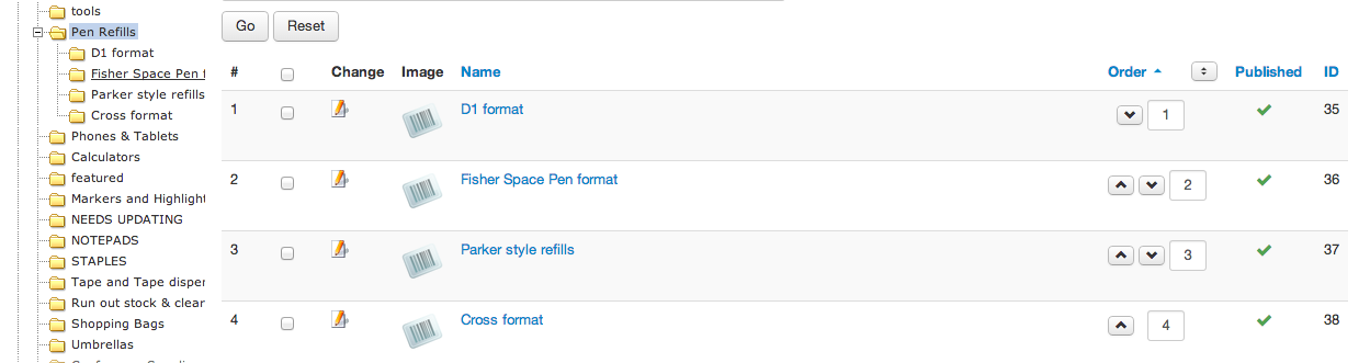

Ok, and can you show me some screenshots of your "category three" through "Hikashop->Products->Categories->'Explorer'" ?
  • Posts: 76
11 years 6 months ago #147743
That pointed me in the direction I should have looked in the first place. For some reason ( probably human error ) the sub categories were not published. I have published them and now they have appeared in the main content screen but they still don't appear in the left side menu.
