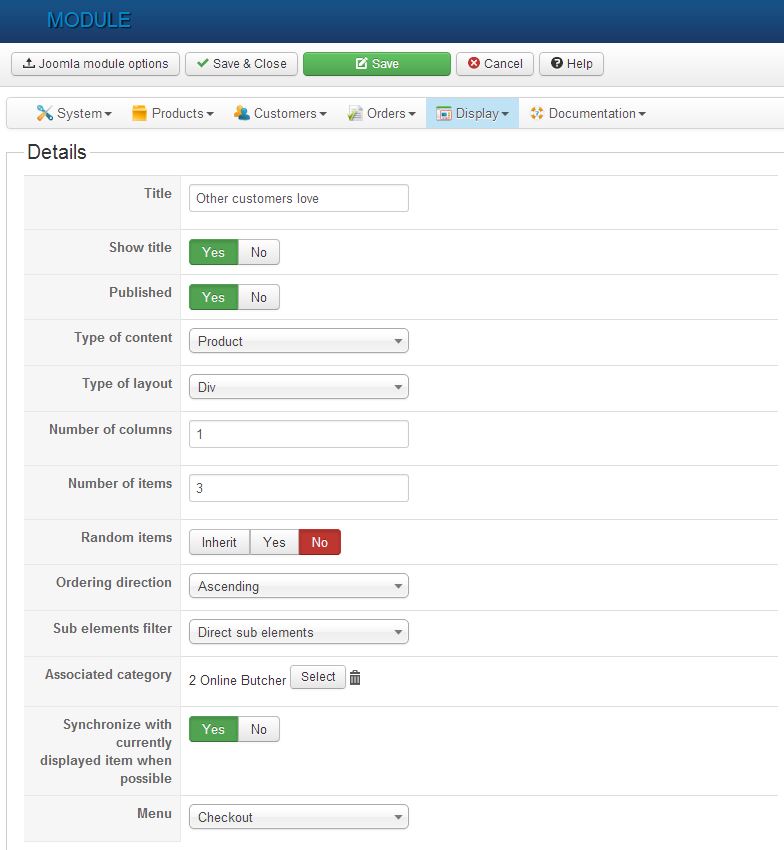

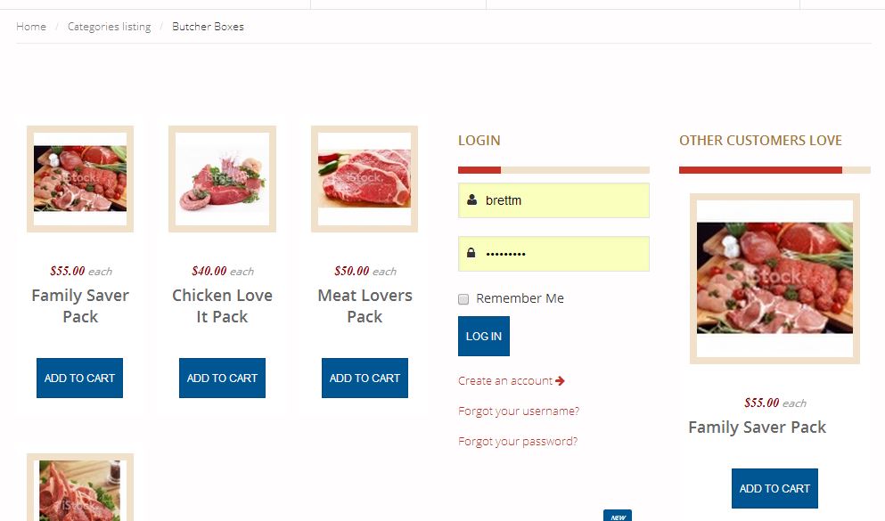

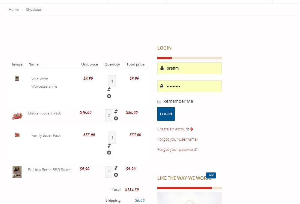

  • Posts: 107
  • Thank you received: 8

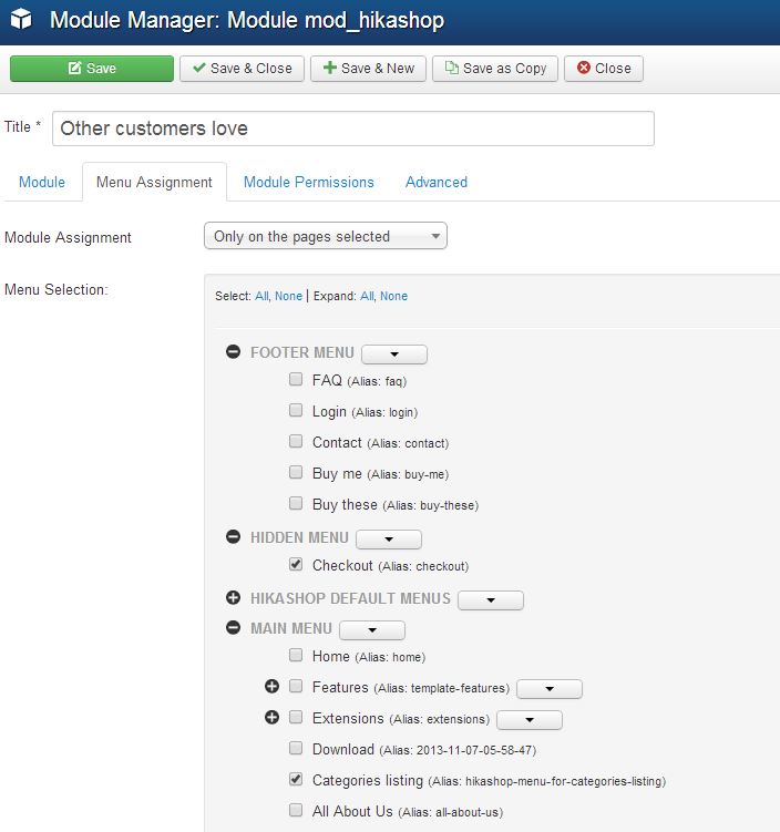

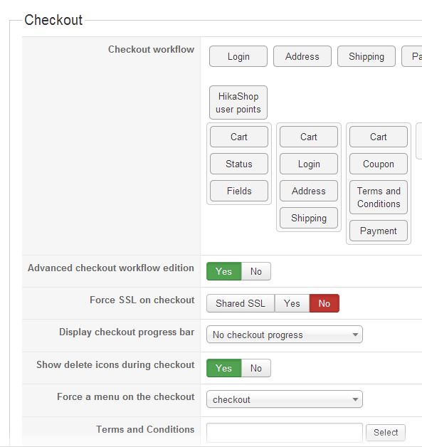

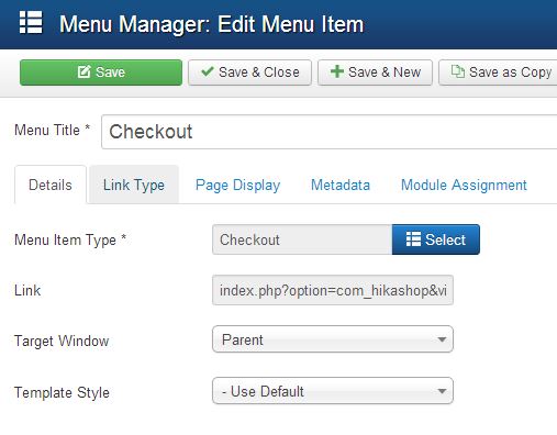

12 years 5 months ago #148730
Thanks Mohamed
Here are my screenshots:
1. "Hidden Menu" for checkout:
2. Module assignment - Related Products displays ok for menu item Categories Listing but not for the Checkout menu item
3. Hikashop options for Related Products module
4. Hikashop checkout configuration forcing menu "Checkout" - menu is forced correctly but module not displayed (space is created for it but it is blank)
5. Site page Categories Listing where Related Products is displayed correctly
6. Site page Checkout where Related Products is not displayed.
Really appreciate your help.
Brett

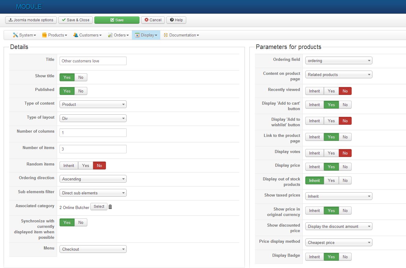

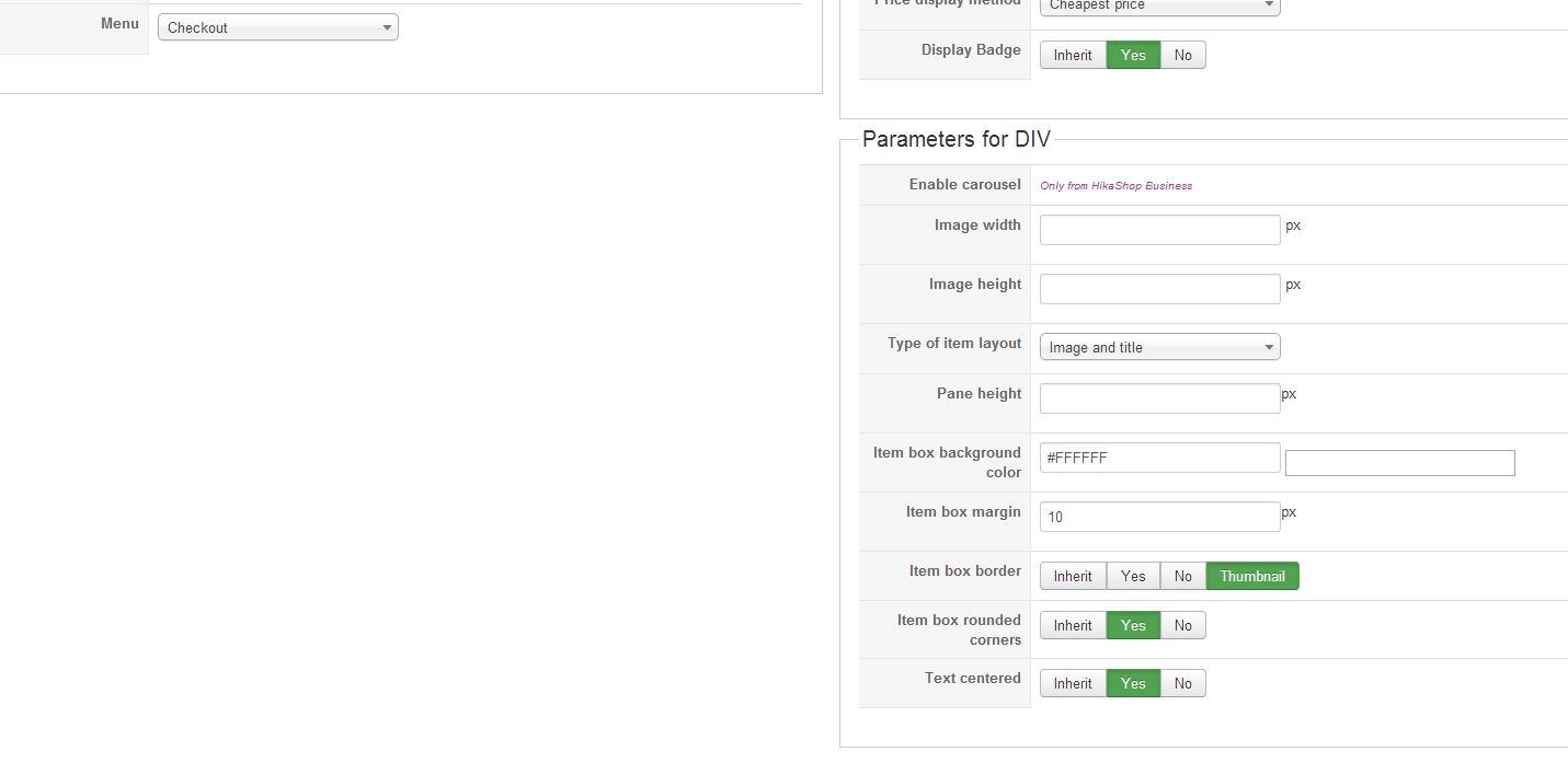

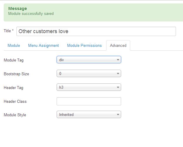

  • Posts: 107
12 years 5 months ago #148870
Thanks Nicolas
I set the "menu assignment" to all menus and I see the heading for the Related Products on all pages now EXCEPT for the Checkout menu.
Here are the Hikashop options as well as the advanced options:
