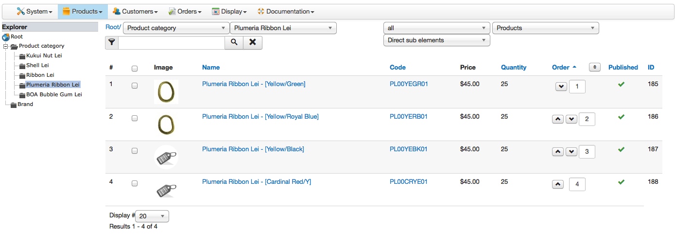

see category listing:
www.noveltylei.com/index.php/store/categ...-plumeria-ribbon-lei
1st product listing:
www.noveltylei.com/index.php/store/produ...bon-lei-yellow-green
Click Next arrow and you find yourself in a different sub-category ? :(
There are 4 items in this sub-category and I'm getting products from other sub-categories that are not related...
And yes, the products are only in 1 category and yes I have rebuilt the Menu Structure and cleared cache just in case and no I haven't edited any of the Views.

12 years 4 months ago #150242
Merci d'éditer le fichier "components/com_hikashop/views/product/view.html.php", dans la fonction "show()" ajoutez:
$filters['category'] = 'a.category_id = '.(int)$category_id;
Après (dans le "if"):
			if(empty($category_id)){
				$query='SELECT a.category_id FROM '.hikashop_table('product_category').' AS a WHERE a.product_id='.(int)$product_id.' ORDER BY a.product_category_id ASC';
				$database->setQuery($query);
				$category_id = $database->loadResult();
Ce problème est général, nous allons améliorer cette partie pour la prochaine release.
