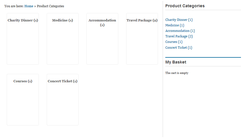

My result so far is, when I create the menu item -> categories listing - my categories are listed but a bunch of products are shown under.

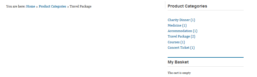

Categories are now listed without the products under but when clicked no products from the categories appear.

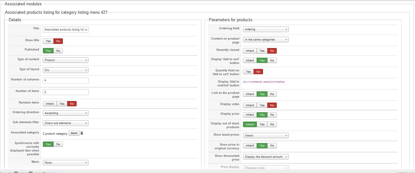

You should not delete the associated module. It is used to display the products for that menu.
Instead, you should just change the "sub element filter" to "direct sub elements" in your associated module options.

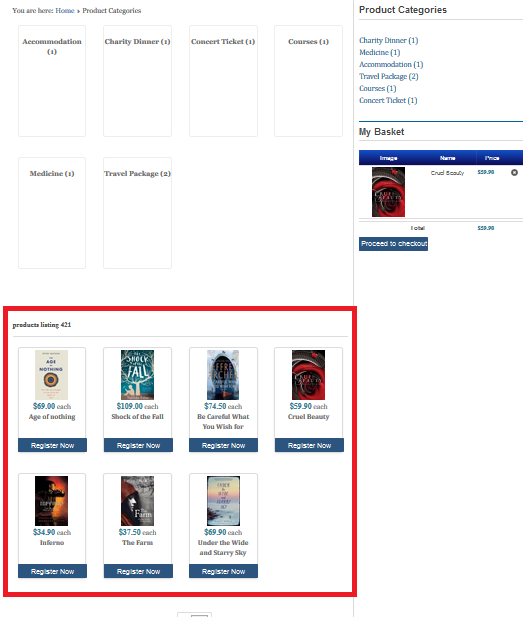

How to disable the product list(red mark) under the product categories ? I have changed the associated module to direct sub elements , but the product list still there.
Last edit: 12 years 4 months ago by dellasys.

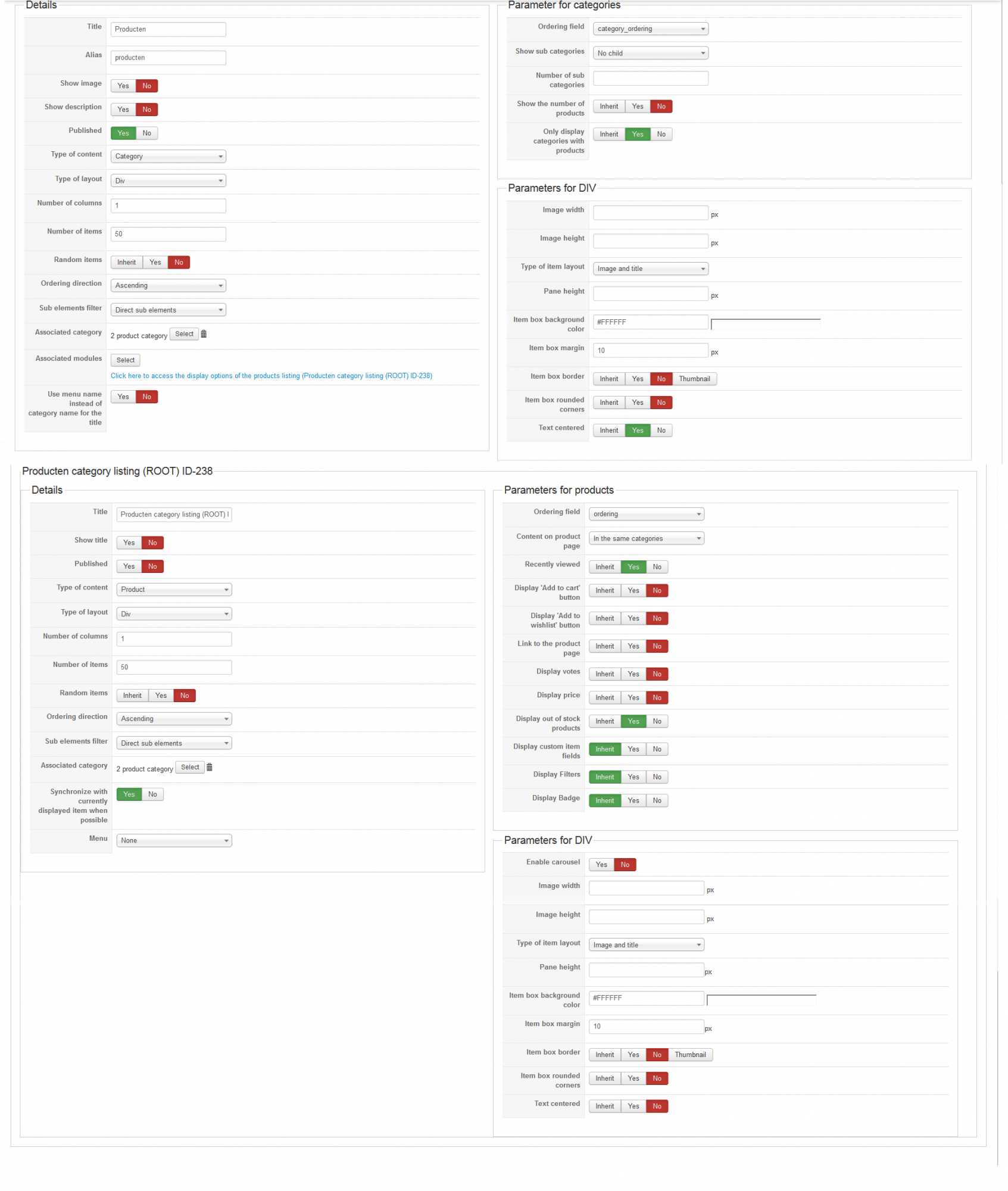

Take a look at how my category listing is set up. Maybe it helps.
Last edit: 12 years 4 months ago by Hristov.

You should :
- Remove the associated module of the "associated modules" option of your Hikashop content menu category listing
- Delete the associated module of your Hikashop content menu category listing through "Hikashop->Display->Content modules"
The following user(s) said Thank You: dellasys

Note that if you don't want your products to be displayed through some categories, the solution will be to remove these products from these categories through the "Category" tab of your products configuration page.
