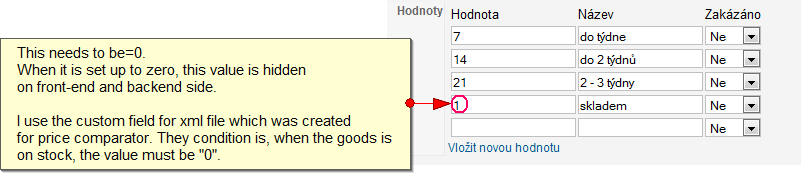

12 years 4 months ago #150955
I would like to have possibility to setup in custom fields value="0" and display this field on front-end and also at back-end side of eshop.
For price comparator I need to set up value "0" for availability.
Availability zero means that the goods is on stock.
Could you please, help me to solve this problem?
Best regards

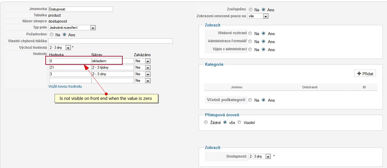

12 years 4 months ago #151019
I need to have possibility to full fill the value of the custom field which is equal to zero and display this field on back-end and front-end side of eshop.
Now, when the value = 0, the custom field is not display.
See attachement

  • Posts: 68
12 years 4 months ago #151295
I realy talk about value. When the value is setup to "0", the title can be anything, than this exact item with value=0 is not visible on the FE even on BE.
The title is not case. I don´t find solutin for title.
