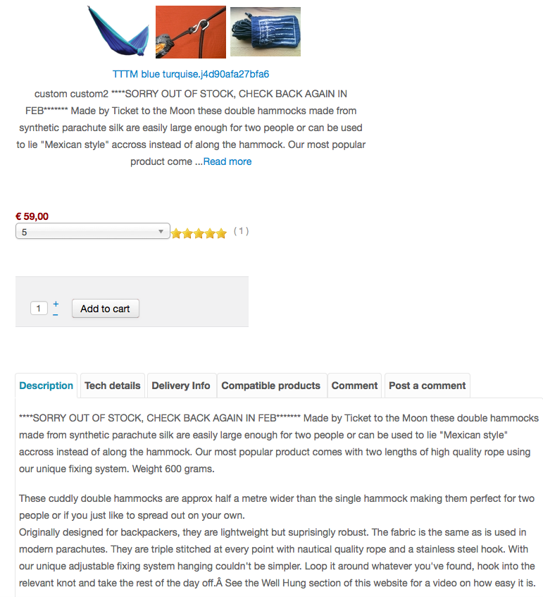

I enabled the tabular layout on my site, but I'm not sure what should appear in the Specification tab or how to populate it and I added 2 custom tabs that I'm not sure how to populate neither. I read some existing threads and your FAQs, but can't get it working.
What I did so far was I added 2 custom fields to the "show_tabular" file as per below code (1) and I added two divs to the product page description with the same ID with text: "custom" for the first tab and "custom2" for the second tab.
All the tabs are showing in the front end, but Tech details (originally specifications), Delivery info & Compatible products info is not showing (see screen grab). Could you please help me to solve the issue?
Any help much appreciated!
Thanks,
Kashka

12 years 5 months ago #151160
You have put the new tabs in the description tab div, that's why nothing is displayed when clicking on the desired tab.

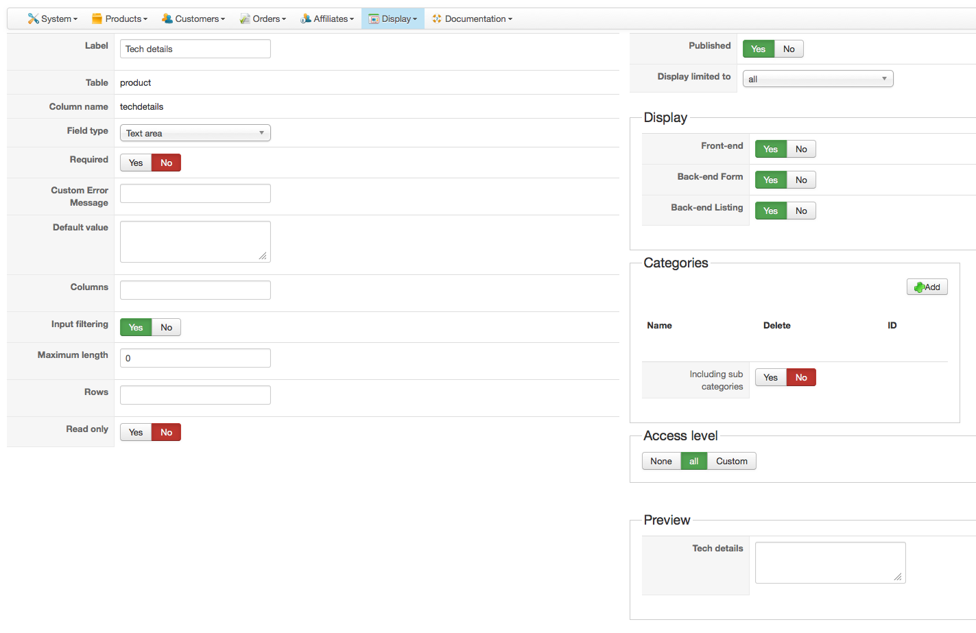

12 years 5 months ago #151465
To have a different content in the custom tab for each products, you have to use the custom fields.
Create a new custom field in the table "product", with the type "Wysiwyg", then fill the content for each products via the product edition page.
And finally in the tab use this kind of code:
<?php echo $this->elements->CUSTOMFIELDNAME; ?>

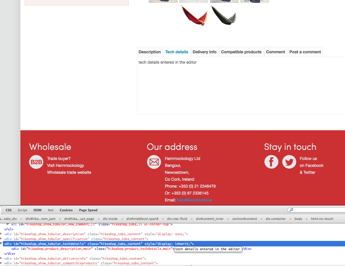

12 years 4 months ago #151746
Hi Xavier, Mohamed,
Thank you so much for your help, I'm nearly there but still missing something,
I added 3 custom fields, which represents 3 custom tabs: I see them in the product page, all of them were showing under specification, but I want each of them to display in separate tab so I commented the specification related code in the tabular view and I followed your advice and added suggested code in tabular view (file attached):
I added 3 new li and divs as per below, but the tabs are not populated, I didn't define JText variables, does that make difference?
It's very annoying, I know it's very simple but I'm not PHP savvy at all, so not sure what I'm missing, please help!
Thanks,
Kashka
<li id="hikashop_show_tabular_techdetails_li" class="hikashop_tabs_li ui-corner-top"><a onclick="displayTab('hikashop_show_tabular_techdetails');" href="javascript:void(0);"><?php echo JText::_('TECH_DETAILS');?></a></li>
<li id="hikashop_show_tabular_deliveryinfo_li" class="hikashop_tabs_li ui-corner-top"><a onclick="displayTab('hikashop_show_tabular_deliveryinfo');" href="javascript:void(0);"><?php echo JText::_('DELIVERY_INFO');?></a></li>
<li id="hikashop_show_tabular_compatibleproducts_li" class="hikashop_tabs_li ui-corner-top"><a onclick="displayTab('hikashop_show_tabular_compatibleproducts');" href="javascript:void(0);"><?php echo JText::_('COMPATIBLE_PRODUCTS');?></a></li>
<div class="hikashop_tabs_content" id="hikashop_show_tabular_techdetails">
<div id="hikashop_product_description_main" class="hikashop_product_techdetails_main">
<?php echo $this->elements->techdetails; ?>
</div>
</div>
<div class="hikashop_tabs_content" id="hikashop_show_tabular_deliveryinfo">
<div id="hikashop_product_description_main" class="hikashop_product_deliveryinfo_main">
<?php echo $this->elements->deliveryinfo; ?>
</div>
</div>
<div class="hikashop_tabs_content" id="hikashop_show_tabular_compatibleproducts">
<div id="hikashop_product_description_main" class="hikashop_product_compatibleproducts_main">
<?php echo $this->elements->compatibleproducts; ?>
</div>
</div>

  • Posts: 107
12 years 4 months ago #151920
Guys this is not working for me at all, I'm getting a bit impenitent because the tabs should be a standard functionality, with ability of customize them, but it's not and it needs a good knowledge of PHP to get it working and I'm not that saavy with it.
I used the code you gave me and it didn't work, there were some obvious name mistakes that I fixed, still not working, I can see in the front end that the custom divs are called in the front end, and in the editor I can populate them by entering text (see screen grab) but the content is not pulled from the custom fields in the back end, I tried to wrap the content with the custom divs but it didn't help either, can you please please help me to get it working and improve your documentation for other people like me?
I attached my tabular view, screen grab of the page where I entered the content via editor and custom field settings, please help,
URL: hammocks.ie/hammocksUAT/index.php/hammoc...veral-colour-options
Thanks,
Kashka

12 years 4 months ago #152068
The tabs are working fine, the only thing missing is the content.
In the code i's actually "$this->elements->techdetails", thanks to remove the "s" to have "this->element->techdetails"
  • Posts: 107
12 years 4 months ago #152193
Hi Xavier,
such a little thing so much nerves! I amended the tabular view and it's working exactly the way it should, fantastic!
Thank you so much for your help!
Delighted and relieved:)
Kashka
