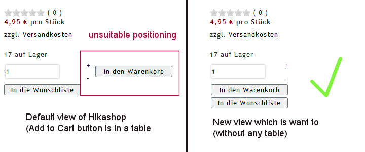

Please look at the screenshot in the attachment. I should tell everything what is want to. ;)

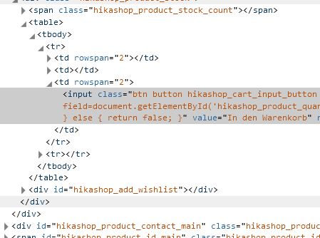

Apart from that, I don´t think that it has something to do with CSS as content from tables can´t be changed with CSS. It must have to do with PHP, what do you think?
In the attachment, you can see what I mean.
12 years 4 months ago #151372
Indeed it will require php edition because actually the add to cart button is in a table.
To have what you want, you will have to edit the file "administrator/components/com_hikashop/helper/cart" function "displayButton()" to edit the HTML part.

unfortunately, I can´t find the code of the button to move it above the code of the wishlist button. I was looking for this:
<input class="btn button hikashop_cart_input_button art-button" name="add" value="In den Warenkorb" onclick="var field=document.getElementById('hikashop_product_quantity_field_1');if(hikashopCheckChangeForm('item','hikashop_product_form')){ return hikashopModifyQuantity('1',field,1,0,'cart'); } else { return false; }" type="submit">
Can you give me a boost how to do it correctly?
There is only the table for the + and - buttons somehow.
