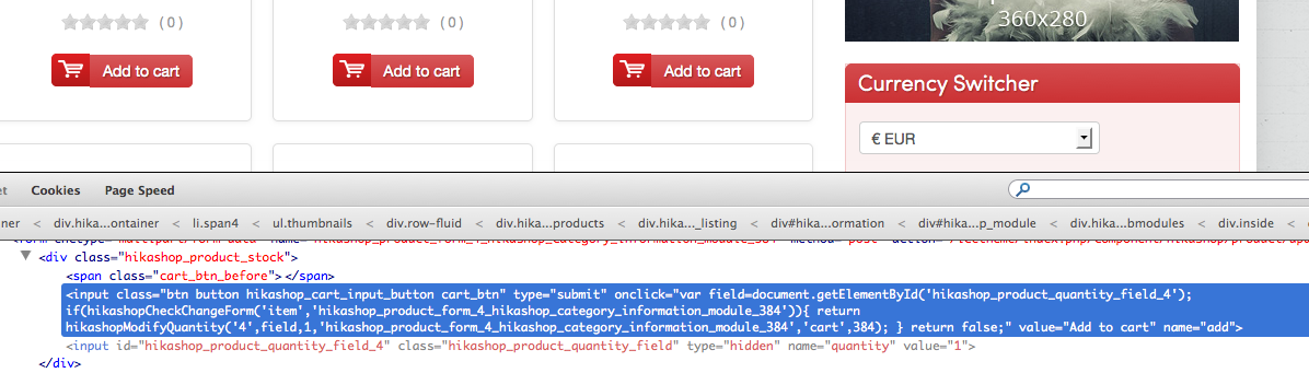

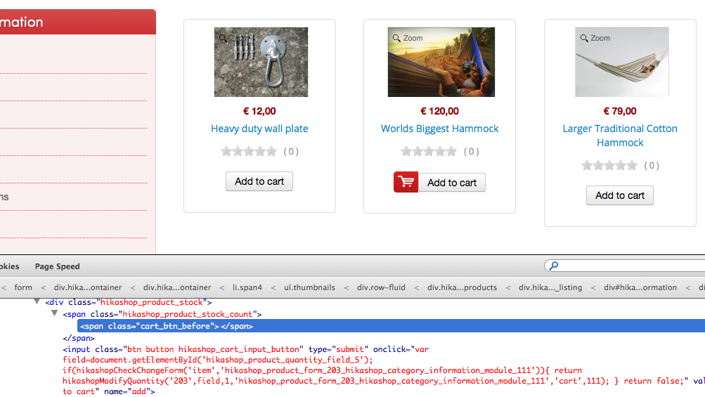

I have an Ice theme template and their demo's add to card button is red and has an icon on the left hand side (see screen grab), my template doesn't pull the same CSS class and I can see just a standard system button (see screen grab), I've been trying to get some answers from the template crowd but no success, I figured out that in order to pull little icon I need to have <span class="cart_btn_before"></span> before the button, how can I add the span? I noticed as well that the css class they use in demo is different then the one I have, I attached both, how can I change it?
I would appreciate any advice.
Thanks,
Kashka

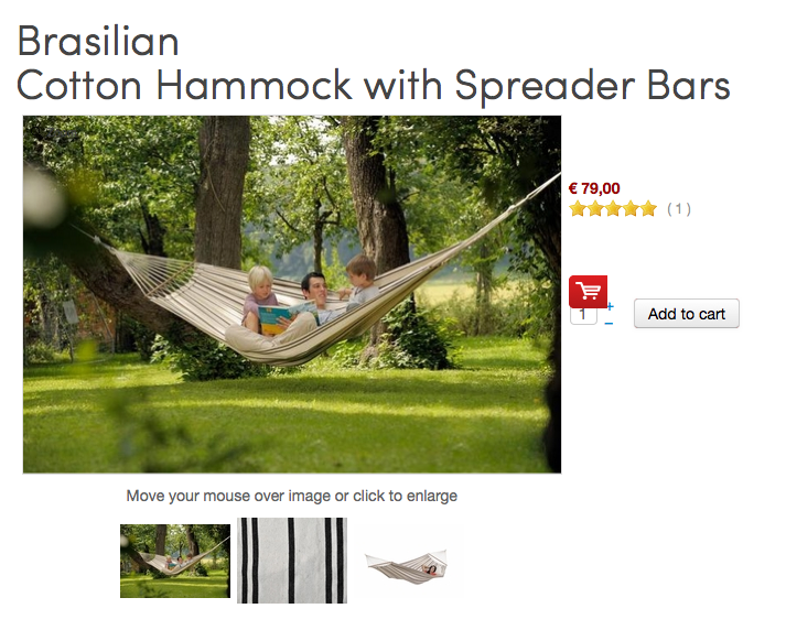

Yes, it worked on the listing page, but on the detail page is completely off, see the grab screen:(((
Will never get it right:((
Thanks for your help anyway...
kashka

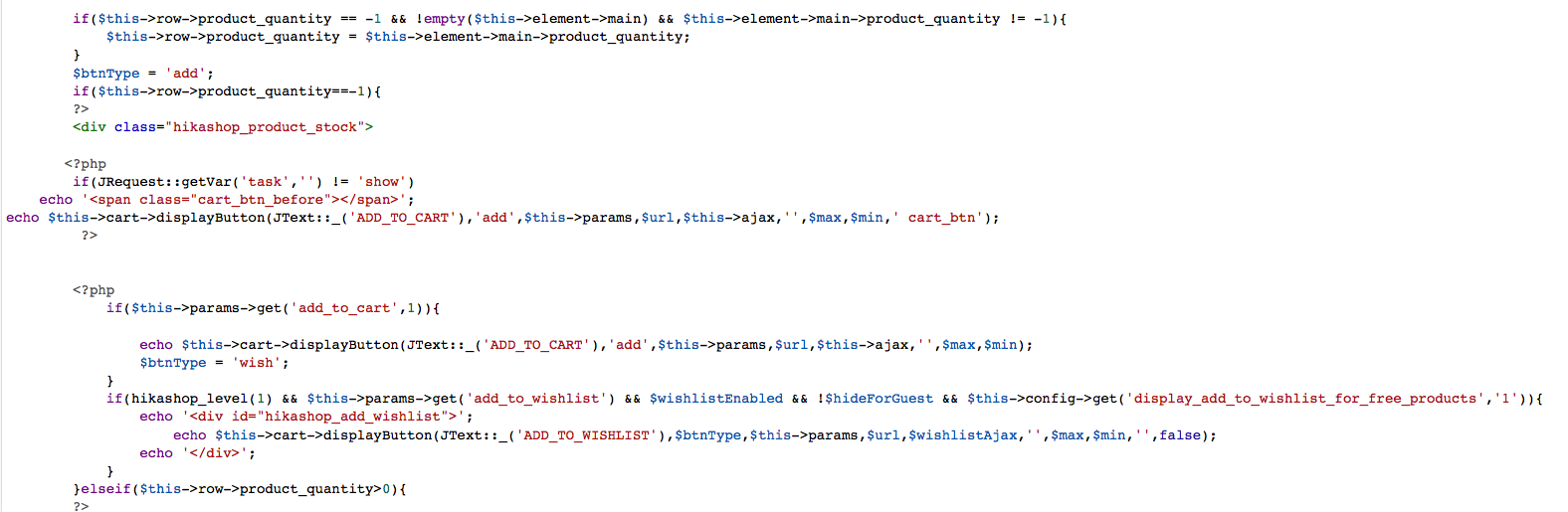

12 years 4 months ago #151921
I made the amend to the quantity view as per your code and it didn't work, the icon is still showing on the product page, see the screen grab of the view.
Thanks,
Kashka

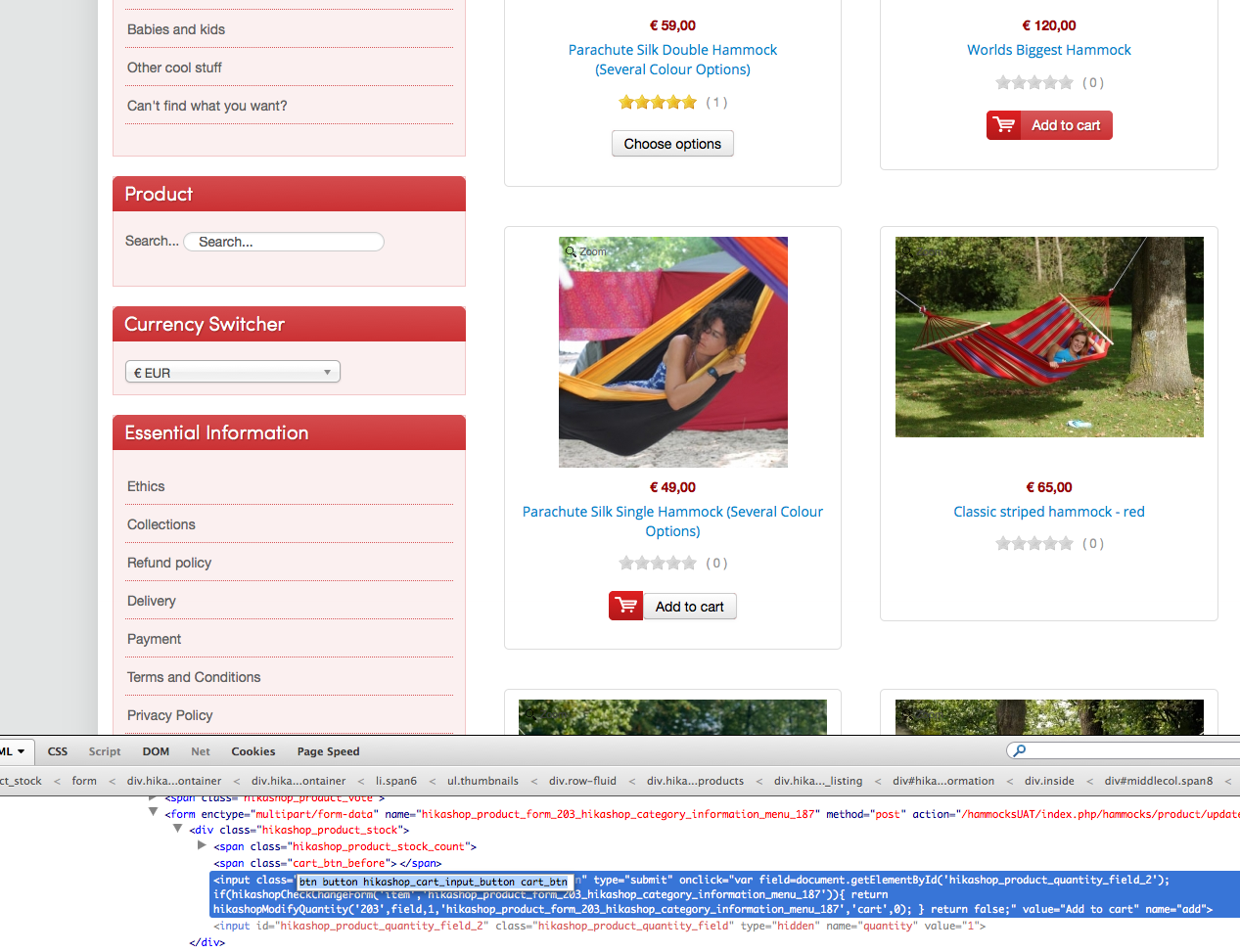

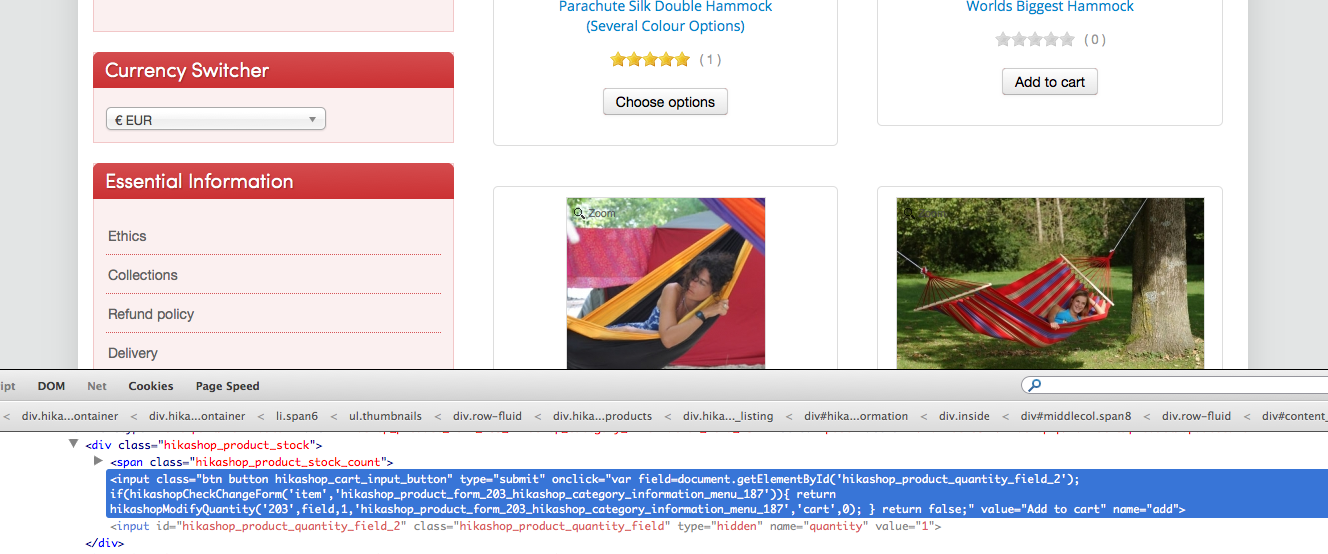

I think I know how to get the template style for my button, can you please tell me how to change the button input class from
a default one: btn button hikashop_cart_input_button to the btn button hikashop_cart_input_button cart_btn
by changing the class I change the style of my add to card button, see the screen grab, please help I can't find the view that pulls this class!
Thanks,
Kashka
