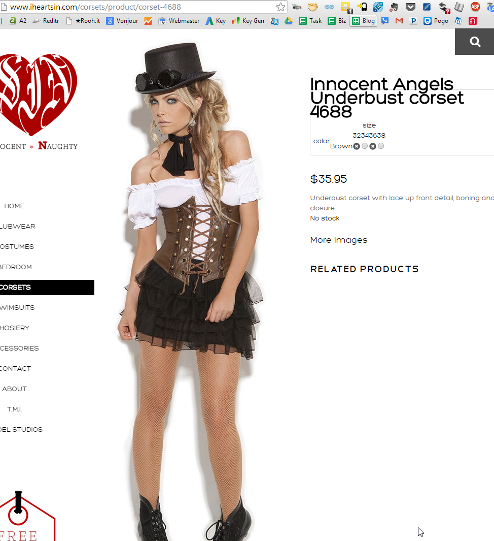

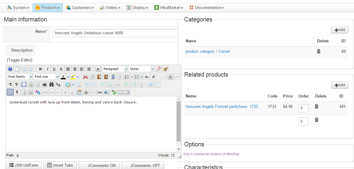

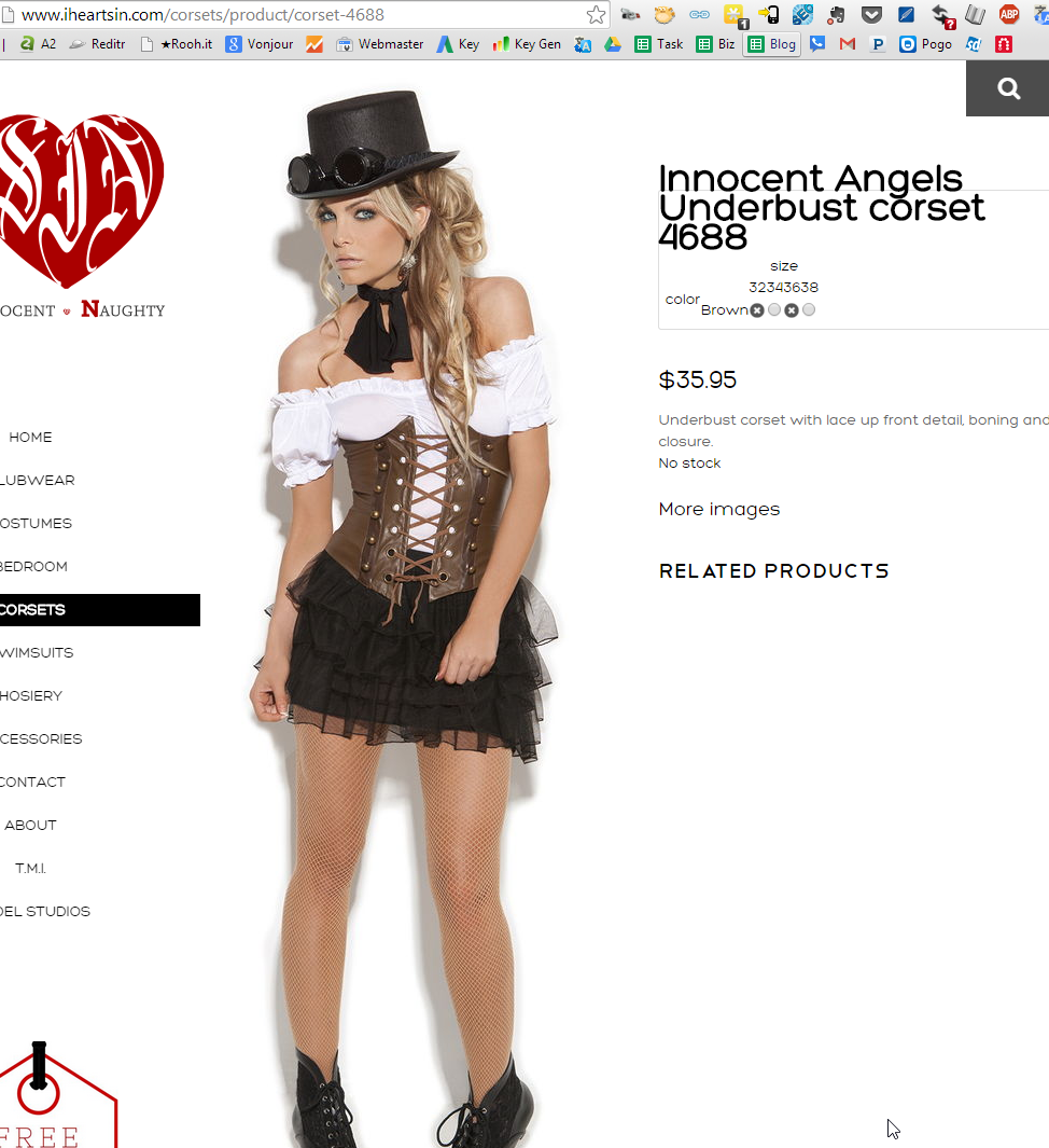

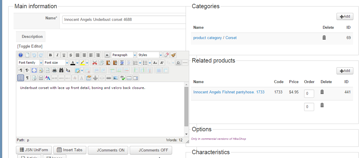

I am having problems with the Related Products Display. In the docs and on this post it references "Modules under the product page".
Did the label get changed? On my backend, I can only find "Modules to display under the main area" by using Configuration->Modules main default options.
If so, than I cannot seem to get it working.
My product page shows a title for Related Products, but no products show.
www.intelligenthustler.com/TEST_SERVER/T.../product/corset-4688

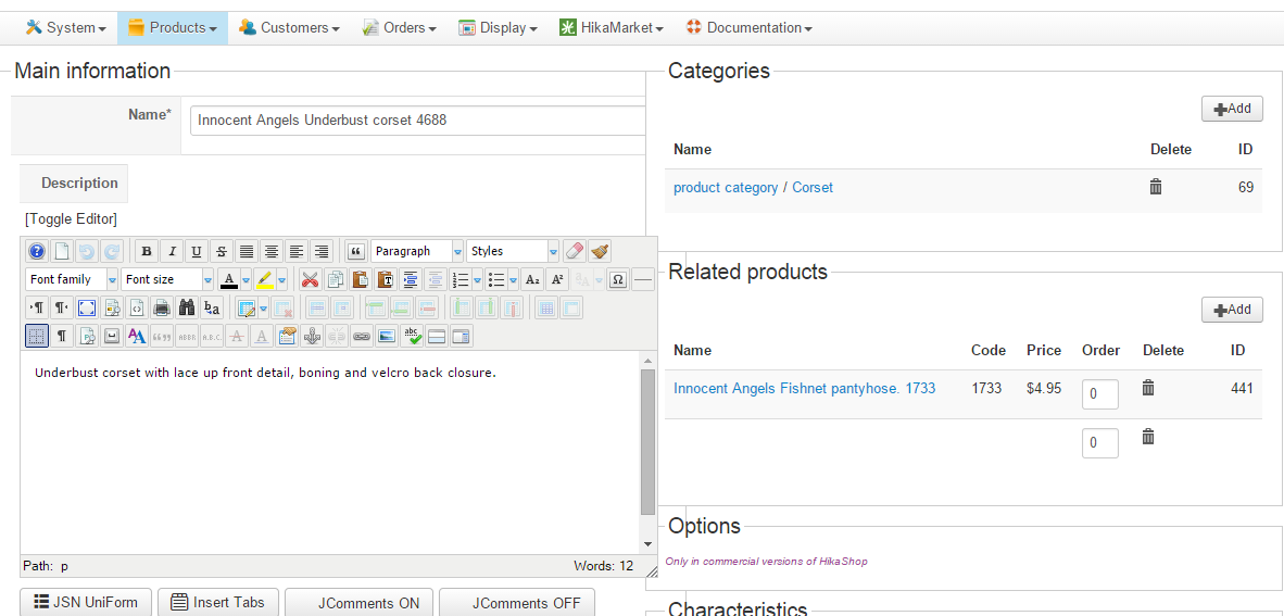

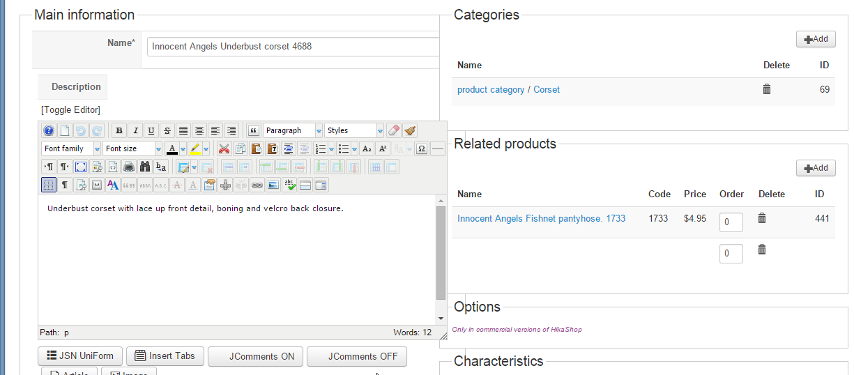

I have confirmed that the product page on the backend has product added to the Related Products (screenshot)
Did I miss a step or am I looking in the wrong spot for the "Modules under the product page" area?

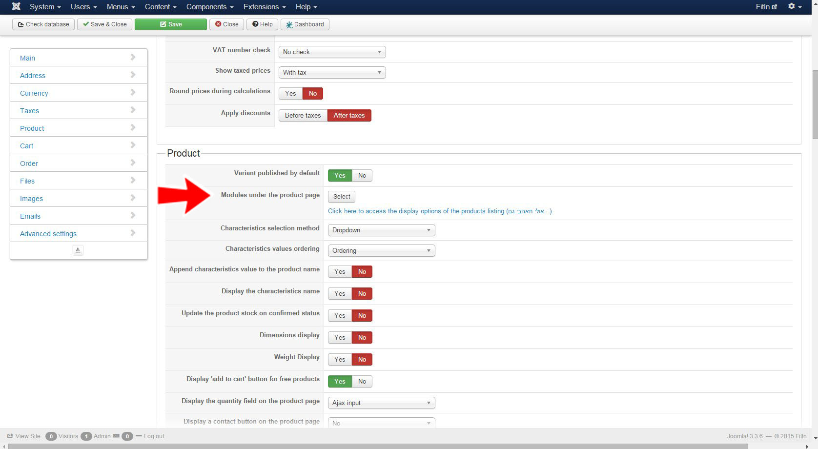

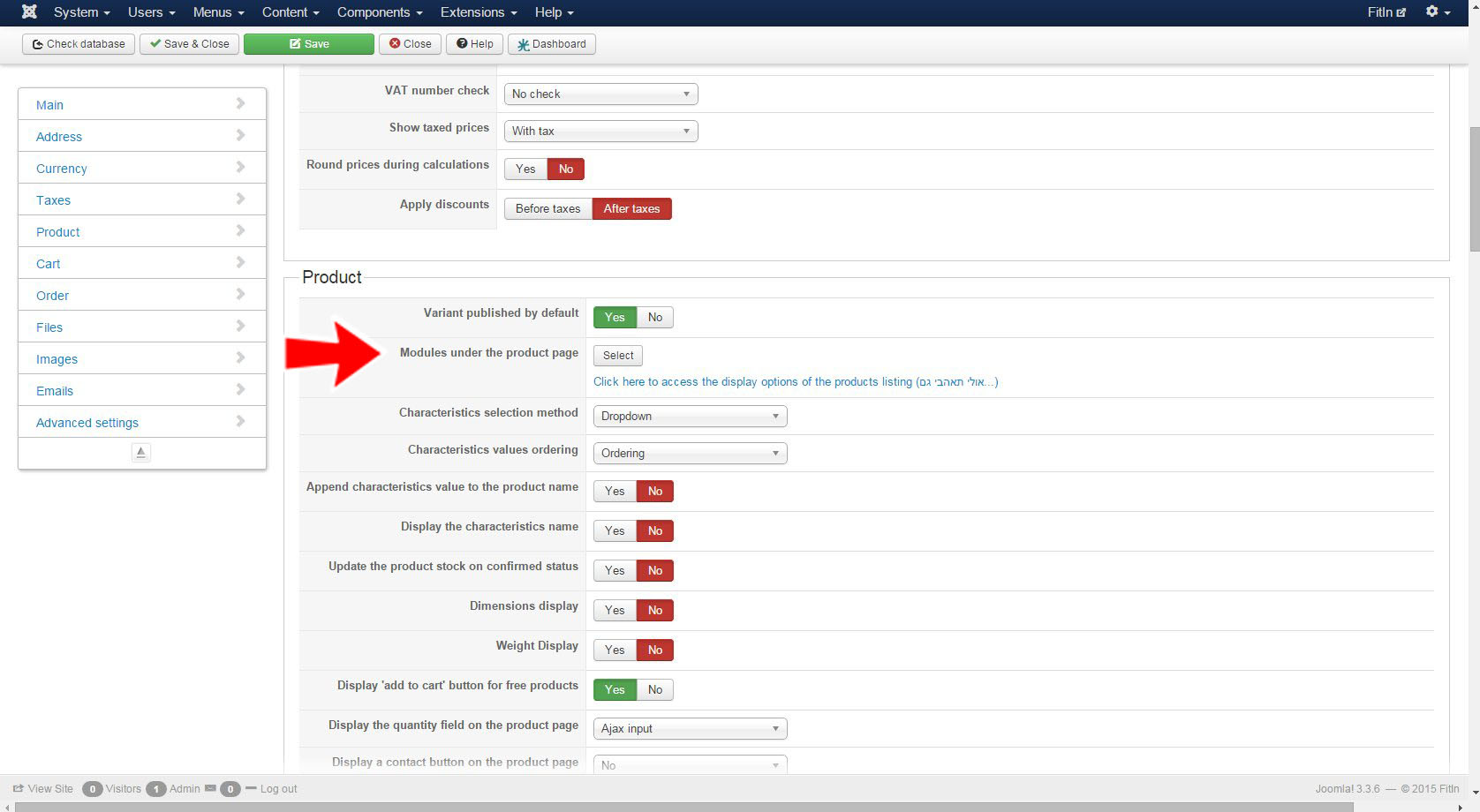

  • Posts: 228
  • Thank you received: 8
11 years 6 months ago #188150
I've made the same exact mistake. I guess for some people it's more intuitive to search under Display -> Module.
This option is actually under Configuration -> Main -> Product. See attached screenshot.

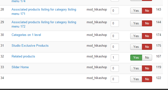

  • Posts: 146
11 years 6 months ago #188288
Thanks theguy, but apparently that is not my issue as it looks like that was already checked. Darn it.
Still not displaying the products, but I am seeing the Title on the product page.
Confirmed on the backend that there are products associated
Anyone have an ideas what I am missing here?

Check under "Modules Manager" and see if your "Related Products" module is assigned to a specific position. If so, remove the assignment. In addition, check the module's "Menu Assignment" and make sure it's set to "On all pages".
If that's not it, in the module, click on "HikaShop Options" and check that you've selected the proper "Associated category". Check that the "Content on product page" is set to "Related products". Check that the "Type of content" is set to product.
BTW, did you make sure that the product you've selected as a related product "Innocent Angels Fishnet..." is published?
If non of the above works for you, try deleting the module and the content of this module under "HikaShop Options" and try to recreate it.
  • Posts: 26381
11 years 6 months ago #188419
The module is right displayed and the related products are right displayed.
The issue is related to the HTML/CSS.
For an unknown reason, the product listing is display in a
<div id="portfolio" class="super-list variable-sizes clearfix isotope" style="position: relative; overflow: hidden; height: 440px;">
And with the hidden overflow + the CSS to force the size on "auto" with a relative container.. The final size of the block is "0px" height.
So the content is there, you just don't see it.
