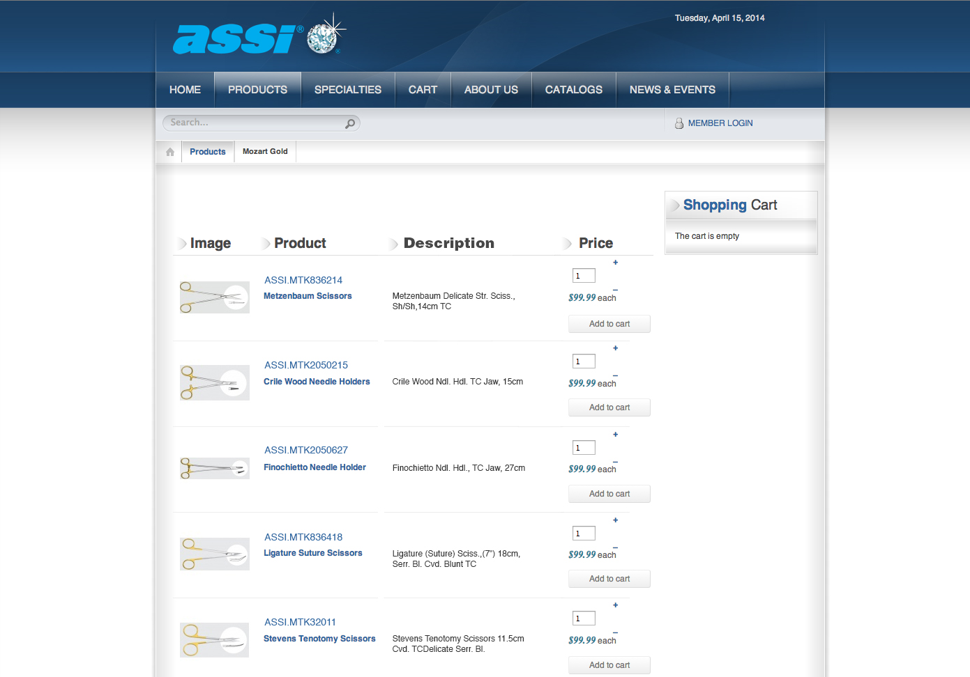

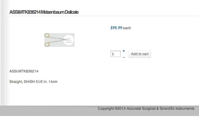

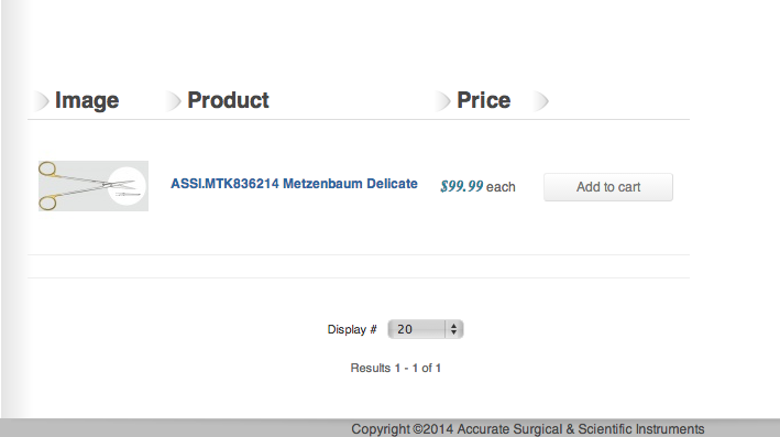

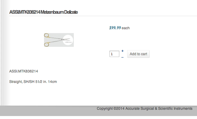

So I am fairly new at this and I think I have most of what I am trying to accomplish down however there are a few things I think I may need some help with.
In this attachment, I would like to get the "product description" in the listing here as well. And I would also like to get the "price" to display on top of the "add to cart" button. I would also like to set the image there to "auto height"
In this attachment, I would like set the image to display at 350 wide and auto height.
Can anyone help me please. I have been combing through codes for days and I cant figure it out.

12 years 4 months ago #152198
So you will have to modify the file "listing_table" of the view "product" via the menu Display>Views for that.
For the description you can add such code:
echo $this->row->product_description;
for example after:
echo $this->row->product_name;
For the price, you want to move the code:
$this->setLayout('add_to_cart_listing');
echo $this->loadTemplate();
after:
For the image, I'm not sure what you mean by "auto height" ? The height will be "auto" if you only provide the width in the options of the menu via the menu Display>Content menus.

Im sorry. I am not very familiar with php. Could you be a little bit more descriptive?
Ultimately, this is what I want the page to look like.
Abstract Image Group | Fulfilling all of your large format printing needs!
12 years 4 months ago #152325
It will be difficult to be more precise, Nicolas gave you all the needed php code and give you place to put the code.
Now it just need HTML customizations and add the php code given in the html where you want to display it.
Don't forget tu have the php code between php tags.

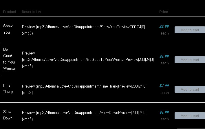

This code is very useful. I was able to format the table view to show exactly what is shown. The problem that I ran into is that I am trying to show a mp3 player in the description area. Using a joomla plugin for mp3 players. It uses the format {mp3}filename{/mp3}
In the product view the mp3 player shows and works correctly. When I set the product view to table layout I get the code and not the player.
I have tried to use the {loadposition} technique, with load modules enabled. To no avail. There is a piece of code that is clearly over my head that is needed here.
Any help or suggestions?

If you want the content tags to be processed in the description, instead of the code:
you should use the code:
echo JHTML::_('content.prepare',$this->row->product_description);
  • Posts: 15
12 years 4 months ago #152898
Ah!!!!! Success!!!!! Thank You!!!!!!!!

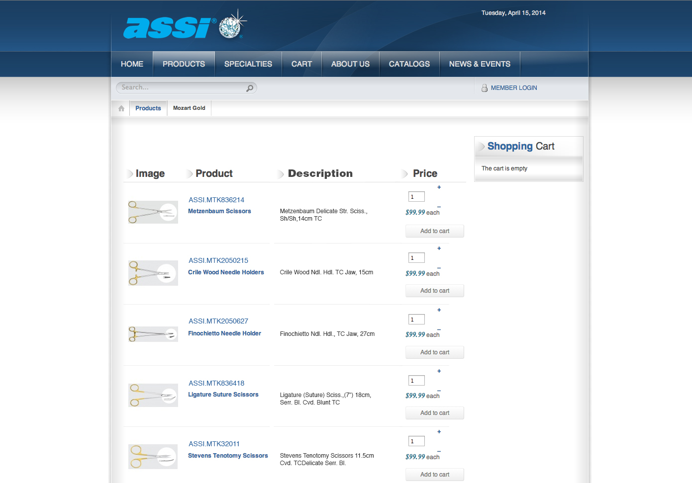

  • Posts: 37
12 years 3 months ago #154216
Here is the link to the page:
181.224.136.115/~accura84/index.php/prod...egory/22-mozart-gold
And the code file as well.

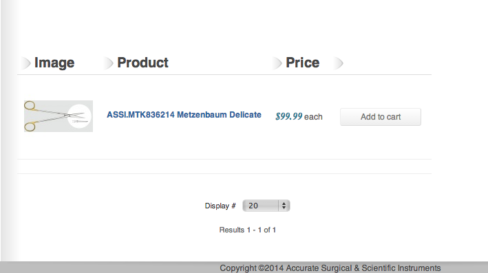

  • Posts: 37
12 years 3 months ago #154218
I was able to get the description in place. Thank you for that. However, now I need to get the "quantity" on top of the "add to cart" button, under the price.
Thank you all so much for your help, I really appreciate it.
Last edit: 12 years 3 months ago by abstractimagegroup. Reason: mistake
  • Posts: 86080
  • Thank you received: 14186
12 years 3 months ago #154224
You can do that with some custom CSS:
.hikashop_product_stock table tr, .hikashop_product_stock table td {
display: block;
float: left;
.hikashop_product_stock table tr:nth-child(1) td:nth-child(2){
 margin-top: -9px !important;
.hikashop_product_stock table tr:nth-child(2) td{
margin-top: -88px !important;
margin-left: 53px !important;
Based on the tests I made on your page, it looks like you want after adding that CSS.
  • Posts: 37
12 years 3 months ago #154336
And should I be placing that code in my template custom css file?
  • Posts: 86080
12 years 3 months ago #154338
Yes
