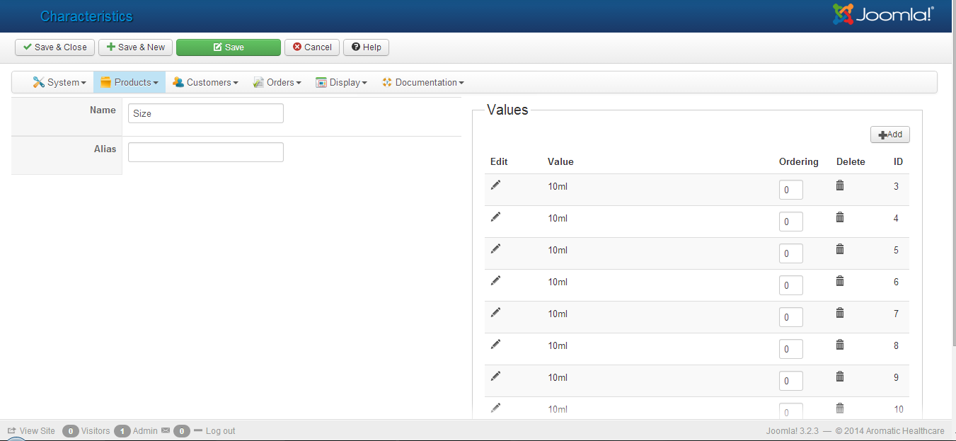

I created the characteristic for size but I do not see a variant function. Can you provide the supporting document link for it. Your documentation page isn't working properly I submitted a ticket in regards to that yesterday and your technical support person stated that they would look into it. Screenshot attached.
Last edit: 12 years 4 months ago by gomay. Reason: adding attachment
12 years 4 months ago #153276
Note that you'll just have to :
- Go to "Hikashop->Products->Characteristics"
- Create a new characteristics named "Size" for example and add 2 values like 6ml/ 12ml / ...
- Then go to "Hikashop->Products->Your product"
- Add your characteristic through your characteristic tab
- Then you can also manage your product's variants through the "manage variants" button
Also note that you'll find more information through the documentation : www.hikashop.com/support/documentation/i...html#characteristics
  • Posts: 43
12 years 4 months ago #153420
Not sure if this will work... because the products have different pricing based on their size. Ultimately I just want a person to pull the dropdown and have a price based off of the size they choose. The downside is that each products are not the same in price. So a 10ml on one product will say 5.99 but on another it may be 8.99
12 years 4 months ago #153426
As I said, You'll be able to add different prices for your product's variants through the "manage variants" button, this will work.
