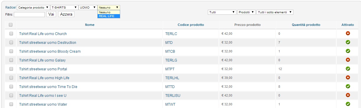

Hello Xavier, thanks for answered me.
I did not understand very well what you wrote me. In the attached file you find a screenshoot. What I need is to MANUAL sorting category UOMO with subcategory REAL LIFE.
As you see ALL the products are shown but the column "sorting" is disappear.
Hope you understand me.

12 years 4 months ago #153409
Sorry I was thinking that you were looking for such filtering in frontend not in backend.
In the backend you can filter to display products of one category, or of one category and all the subcategories but not on one category and one of it's subcategories.

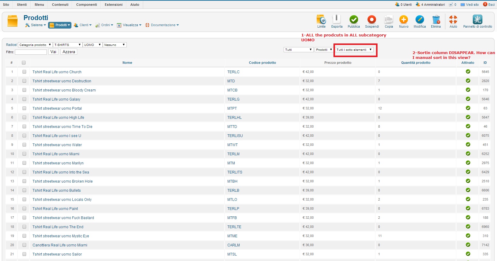

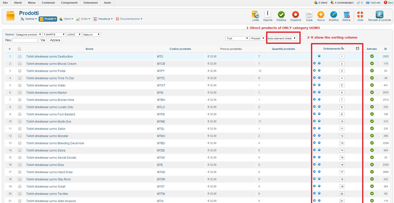

  • Posts: 84
12 years 4 months ago #153498
Sorry for my bad explication, I try again to explain you with 2 screenshoot in attached. Please have a look.
What I need is "How to manual sorting one category and all the subcategories?"
Thank you
12 years 4 months ago #153515
"Ordering" in two different categories is indeed not possible.
If you really want a specific ordering, I think that the best way is to use custom fields, then in the frontend in the module / menu options sort on the specified custom field.
