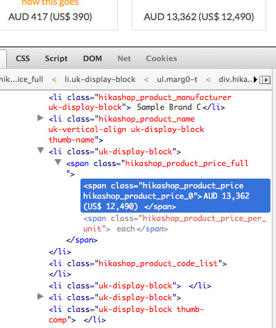

12 years 4 months ago #153500
Thanks for replying, Mohamed, but this is a known, I am using the currency switcher, otherwise I wouldn't get to see what I was describing next.
So, in a div - and same on the product page - this is what I get to see with only the main currency selected:
When selecting a second currency (yes, of course with the currency switcher), this is being displayed:
According to Firebug, this is one string in a span. I don't want that, though. The least I'd want is to have the main currency in front and the secondary following, as well as the parentheses around the secondary - not the main.
And while I'm on it, I'd like to apply a separate class to the secondary currency, so that I can alter its display via CSS.
So, which file has the code?
No matter what, yet it's the same classes on the price(s), no difference when another currency is selected.
Think I've been through all relevant views and any other *price.php and *currency.php file, but can't find this code... help, please.

12 years 4 months ago #153625
Dear Xavier,
I don't mean to be a smart*ss, but I think once you look closely again, you'll agree with me that it's not the listing_price.php.
Look at the content of the blue part, please:
Promised, if I use only the published currency US$, it's the very same, except for the "AUD 13,362" and the parenthesis around the US$ amount not showing, naturally.
Then look into the listing_price.php. The lines with that span are #70-#122. There's a lot with discount and tax, and a little bit with "currencyHelper" and, of course, "price_currency_id", but nothing that I can see fit.
In that section, there's not even the expressions ' (' and ')' as would be surrounding the main currency price. (That I find in line #33, but it doesn't help me at all.)
If I do a search for "currencyHelper" across my site, 95 files are coming up. Ok, many have names which are taking them clearly out of responsibility. Anyway, and please trust me again, but I've been through some of these files already, too. Oh, and through all 4 "currency.php" files as well. No luck.
You can tell already from the bits surrounding the blue box in the screenshot that I'm somewhat "familiar" with the general structure of views and editing them... been successfully customizing quite a bit without a glitch. So, thanks for the link, and no offence, but it's like handing the mechanic who needs to get into the transmission the user's manual of the car (and I've been through HikaShop's manuals a lot!)... :lol:
So, can someone please give me a another hint? In return I promise that I'll continue not asking questions that are already answered in the documentation or here in the forum. ;) Thank you once again.

12 years 4 months ago #153627
Iit's really the file "listing_price" of the view "product" that you want to edit.
You don't see the parenthesis there because they are added as a translation:
PRICE_BEFORE_ORIG=" ("
PRICE_AFTER_ORIG=") "
with the code:
if($this->params->get('show_original_price') && !empty($price->price_orig_value)){
				echo JText::_('PRICE_BEFORE_ORIG');
				if($this->params->get('price_with_tax')){
					echo $this->currencyHelper->format($price->price_orig_value_with_tax,$price->price_orig_currency_id);
				if($this->params->get('price_with_tax')==2){
					echo JText::_('PRICE_BEFORE_TAX');
				if($this->params->get('price_with_tax')==2||!$this->params->get('price_with_tax')){
					echo $this->currencyHelper->format($price->price_orig_value,$price->price_orig_currency_id);
					echo JText::_('PRICE_AFTER_TAX');
				echo JText::_('PRICE_AFTER_ORIG');
The "orig" in the code is for the price before currency conversion (the original price).
