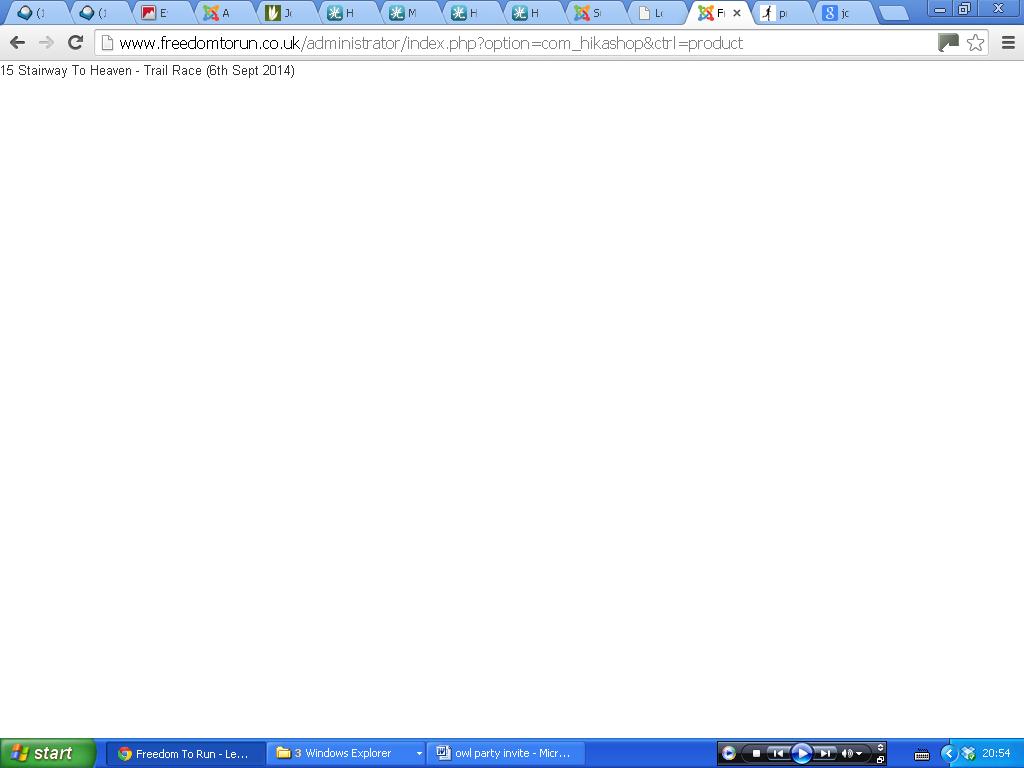

So I think I need to use the 'correspond to the product' option. When I click on this I need to select an item for the list. I do this and click add. I actually want to multi select here, because I have 4 separate events.
If I click on one event or all four, I get an error as in the following screenshot and it will not add the product to the form field.

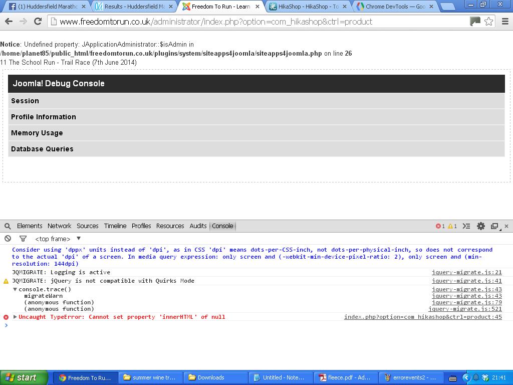

This error could be either :
1. A fatal error with no error message displayed. Please try again with the error reporting and debug mode options of the Joomla configuration turned on and see if you get any error.
2. A javascript error on your backend preventing the javascript of the 'correspond to the product' option to work properly. Look at the javascript console error log of your browser while on the custom field edition page and see if you get any javascript error.

  • Posts: 20
11 years 11 months ago #153917

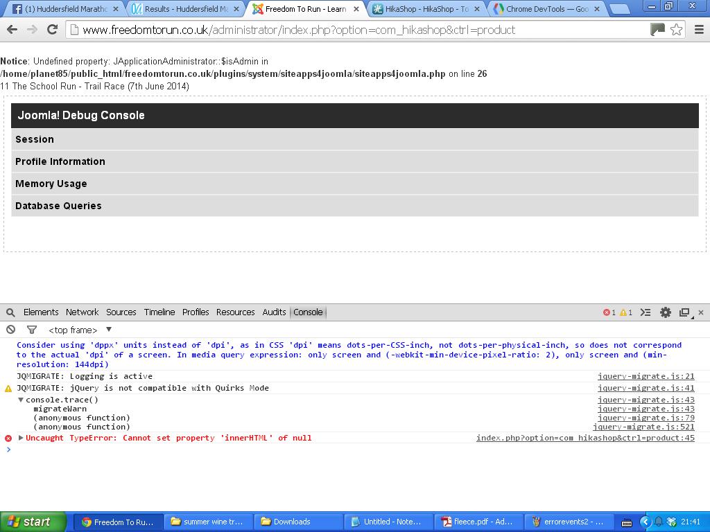

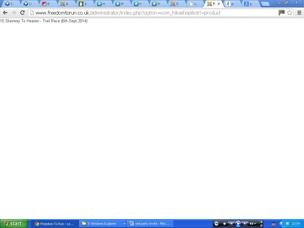

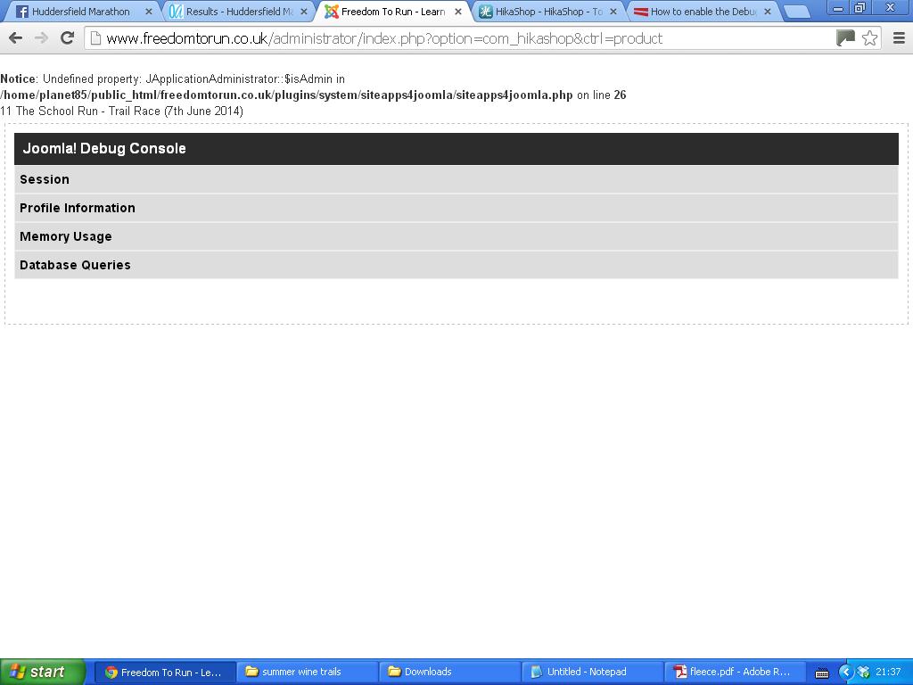

OK please see attached my screen before adding products to fields, the error I get when I click in debug mode and also the javascript error.
Thanks,
  • Posts: 20
11 years 11 months ago #153918
Thanks,
  • Posts: 20
11 years 11 months ago #153919
Thanks,

  • Posts: 85424
  • Thank you received: 13964
11 years 11 months ago #153934
So the problem is the javascript error.
Probably a system plugin which is loading something it shouldn't in the backend.
You have two things you can try:
1. replace the file administrator/components/com_hikashop/types/limitparent.php with the one in the archive below:
2. install and configure the plugin jquery easy for joomla:
extensions.joomla.org/extensions/core-en...jquery-scripts/18327
  • Posts: 20
11 years 11 months ago #154145
I've installed and enabled the plugin.
I can't see where to upload the .php file - there doesn't seem to be a folder called /types/ in that location.
I still get a white screen as before with this error:
11 The School Run - Trail Race (7th June 2014)

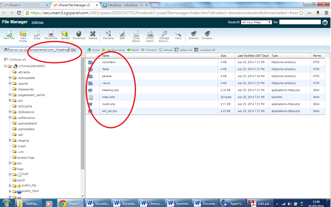

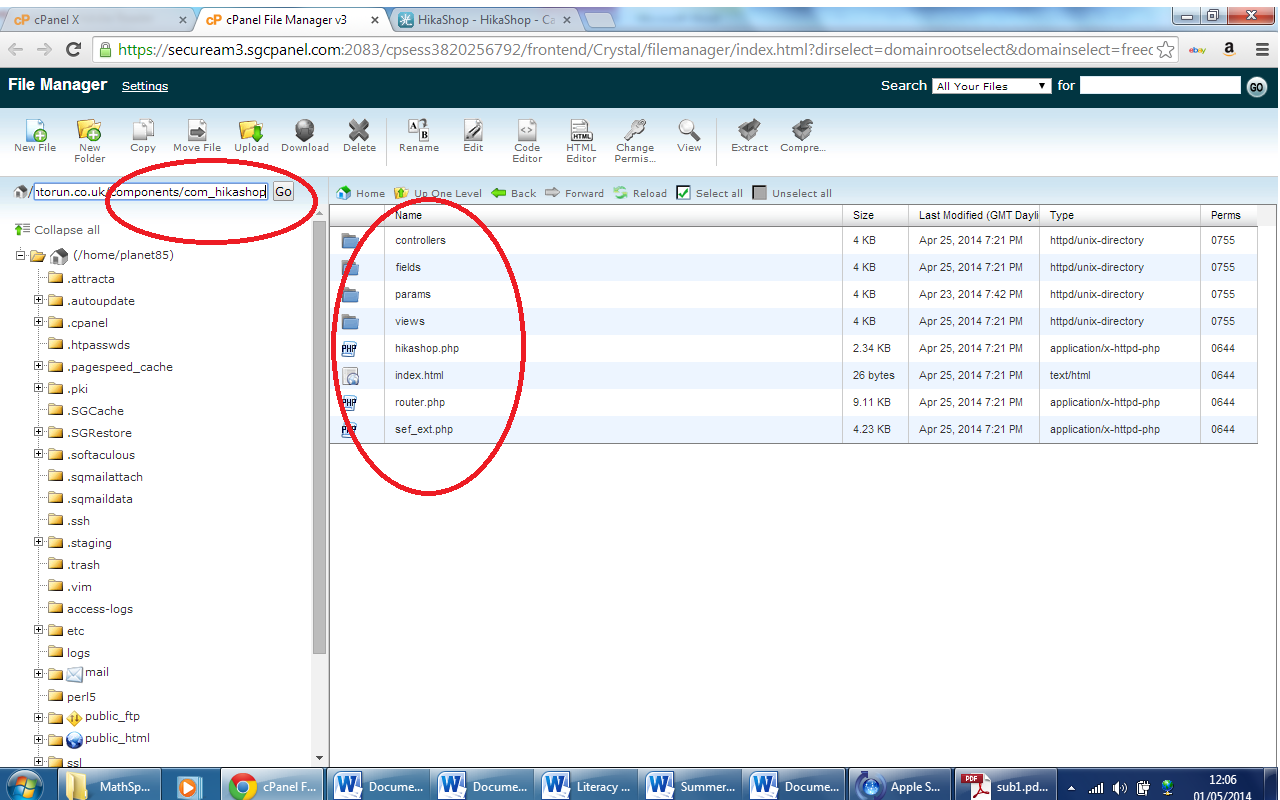

  • Posts: 20
11 years 11 months ago #154200
As you can see from the screenshot the folder is absent. Is this why Hikashop is not working properly?
Should I create the folder manually?
  • Posts: 20
11 years 11 months ago #154221
My host confirm there is no such folder in existence, or in a previous backup.
  • Posts: 85424
11 years 11 months ago #154204
You're looking at the folder components/com_hikashop and not at the folder administrator/components/com_hikashop as I said in my previous messages.

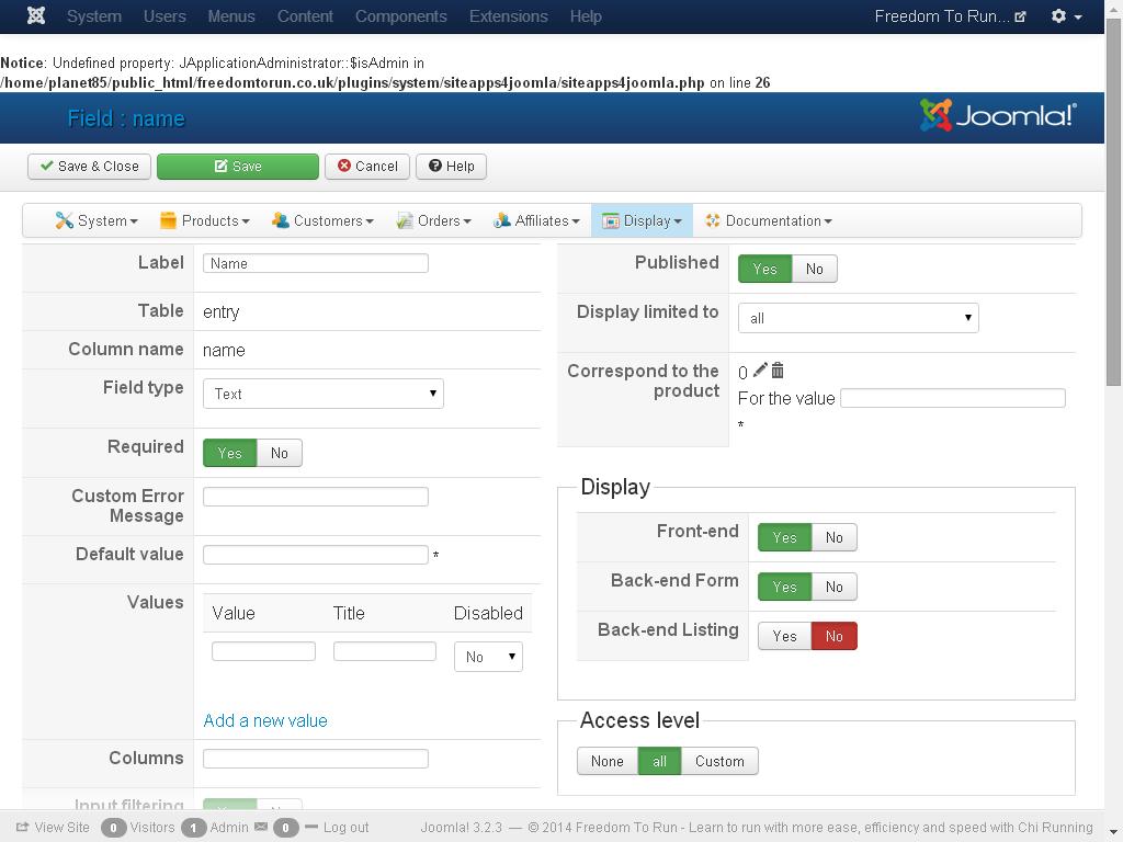

  • Posts: 20
11 years 11 months ago #154379
I've done that. I followed the tutorial before I started this thread. I don't think the correspond to the product is working properly, or somehow I'm misunderstanding the procedure.
  • Posts: 85424
11 years 11 months ago #154426
Please provide a screenshot of the options of your custom entry field. You must be missing something in it.
