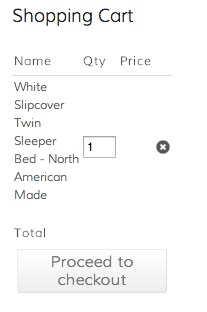

-- HikaShop version -- : Starter: 2.3.0
-- Joomla version -- : 1.5.26
-- PHP version -- : 5.2.17
-- Browser(s) name and version -- : Chrome 34.0.1847.131
-- Error-message(debug-mod must be tuned on) -- :
When a product is added to the cart, it shows the product name as it should, but no product price or total price is displayed (see attached).
I have a feeling I'm missing a setting somewhere in the configuration, but I cannot find anything related to this option.
Please advise.

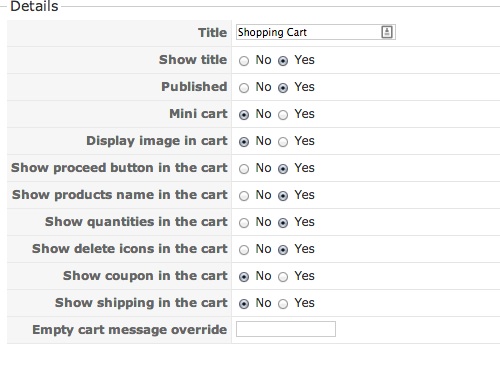

Go in the menu Display>Content modules and edit your cart module there. It's probably called "Shopping cart".
There you have options to control which information to display and which information to hide on the cart module of HikaShop.

  • Posts: 21
12 years 3 months ago #155330
Forgot to mention in my first post, but yes, that was the first place I checked. All the settings in the shopping cart option look fine. Please see attached.

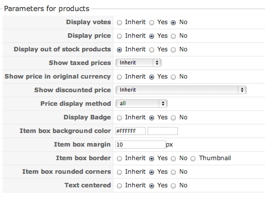

12 years 3 months ago #155505
The issue is that you had customized the listing_price view file in a way which couldn't work with the cart module use of that view file. I've modified the code and it seems to work but I would recommend to check the code of the view file on your end.
