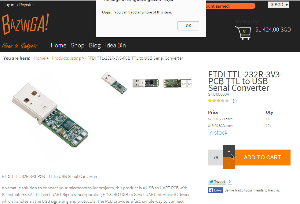

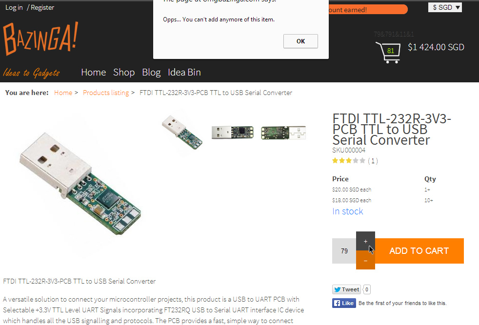

  2. Sure. I have attached a screenshot. When I tried to increase the qty field to more than what's in my avail stock or my max limit per order, I will get this alert/popup. This is normal behaviour. However, I would like to copy this alert into the "add to cart" button. For example, I have 5 avail stock and my user clicked on the "add to cart" button 6x. I wish to have the same alert on his/her 6th button click since the stock limit has been reached. At the moment, the button simply refuse to add more to cart and does it w/o any message. This could confuse my user into thinking that the website is not working.
