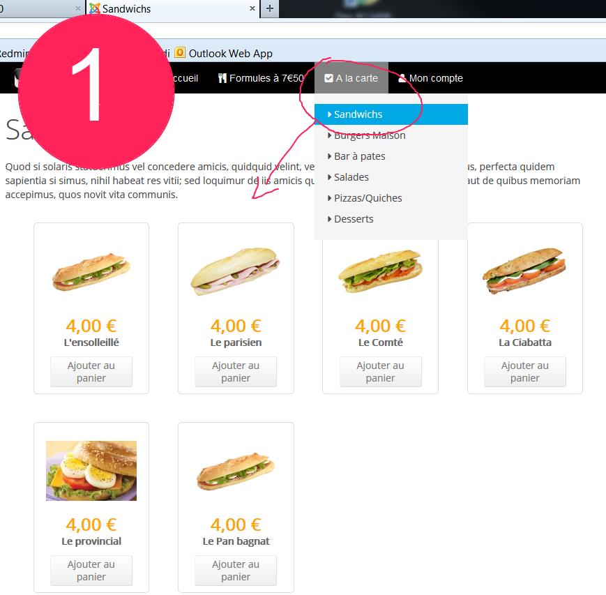

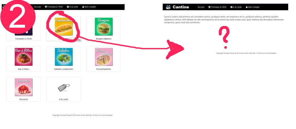

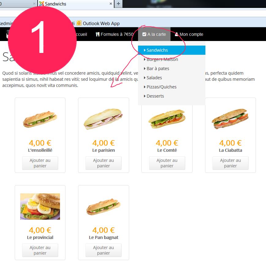

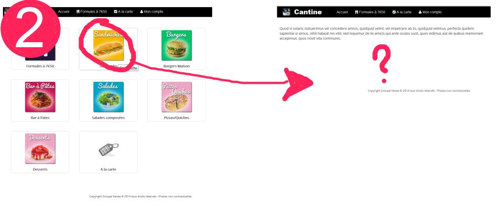

I got the same behavior. I can't navigate through categories to subcategorie, it returns just the description, but no product. (See screenshot #2)
Something strange, because I got some joomla direct link to a categorie and everything is fine (see screenshot 1)
In my opinion, i occurs since I deleted some disabled menu and modules with a "Hikashop ..." name. I m wondering if that is the cause of that. But How to recreate it or fix ?
Thanks for your support
maxime

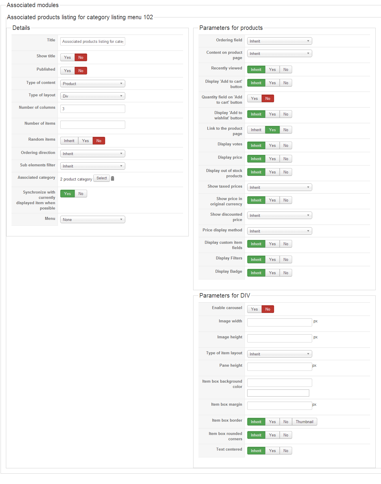

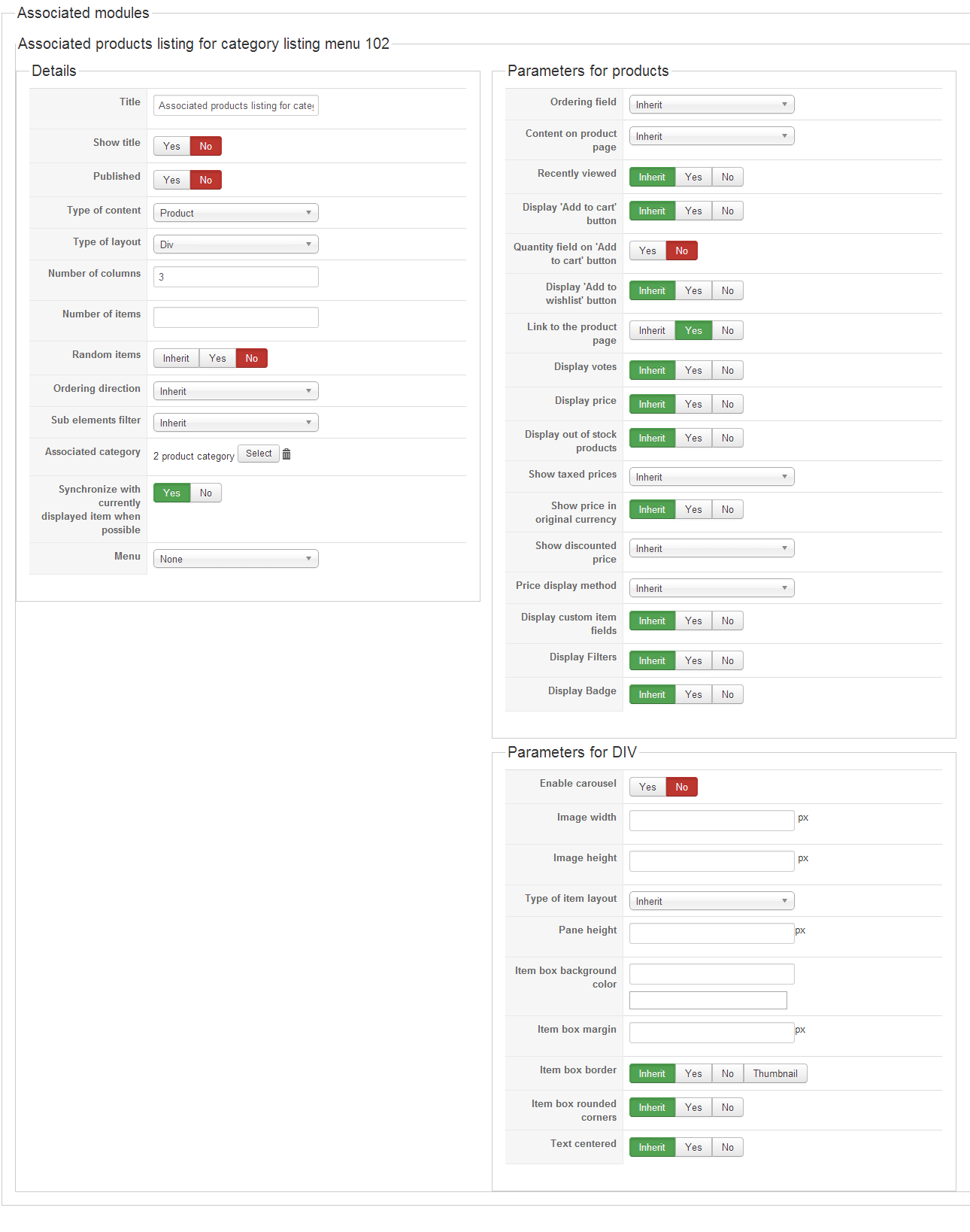

12 years 3 months ago #156597
Go into menu and click on your hikamenu
Then click on your default menu item.
Then go to tab HikaShop Options and click on the link HikaShop Options.
You should see Associated modules with the module name.
I have attached my settings for this module in case you need to recreate it.
