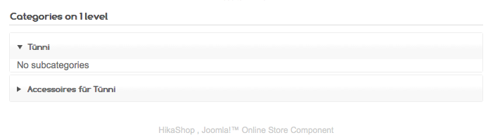

subcategorie are still showing in the product page
  • Posts: 38
12 years 3 months ago #156699
-- url of the page with the problem -- : tuenni.ch
-- Joomla version -- : 2.5.20
-- PHP version -- : 5.3.
-- Browser(s) name and version -- : Firefox 29
subcategorie are still showing at the end the product page,
despite that every where I found "subcategorie" I set it to no.

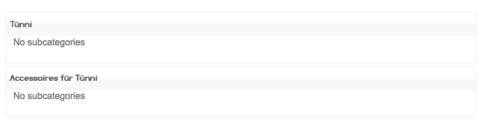

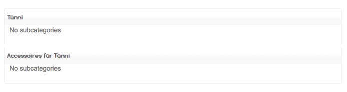

Basically I have one menu entry per category. When I click on the product in the category, , the product page is shown. And the at the every poduct page, all the non empty categories are shown with these "No subcategories"

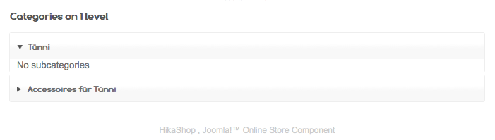

I found the mystery!
this module that was showed at the bottom of each product page was "Categories on 1 level" but in "Display" -> "Content Modules" disabled. Under Joomla! Modulus as well disabled! It was still showing, strange no ?

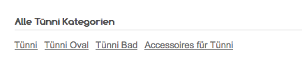

I change in the "Categories on 1 level" "Show sub categories -> All direct sub categories" and now only the first categories are shows, which is fine for me and useful. Funny that "Categories on 1 level" is still disabled in Hikashop.
