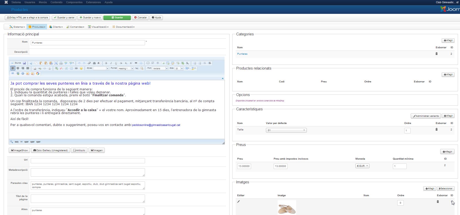

Thanks to give us a screenshot of your product edition page.
  • Posts: 7
12 years 1 month ago #158031
I created a product (shoes) with a picture, I created several variants (size) and I even associated a picture with each size.
As a result, when I go to the home page of the shopping option in my web site, I can see the picture of the shoe. But this picture disappears when I use the drop-down list to select a show size. Attached a screenshot.
